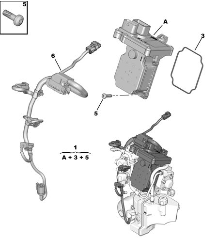

This is the ECU on the gearbox Actuator - so check the connection (especially pin 1) as mentioned.

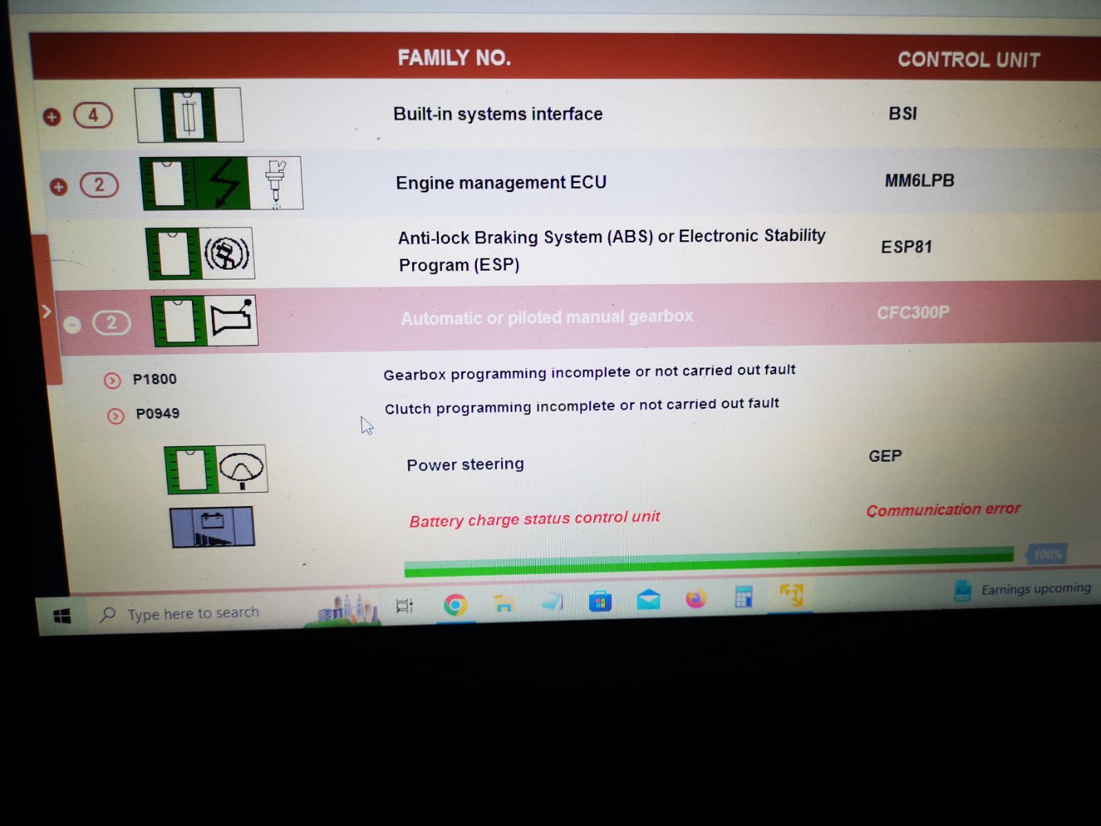

linny wrote: 05 Apr 2021, 12:14 apologies if this is in the wrong section we have had the car 5 months all fine and than it came up with gearbox fault no drive and had to be recovered home .i noticed gear box reservoir was lower than bottom mark so i toped up with the proper fluid. after looking at many posts on here a i have checked fuses connections on gear box ecu etc the latter was a bit mankey so cleaned up and put dielectric grease on . no joy so i got my mechanic friend to try and sort it with his snap on scanner . it came up with low pressure he tried to sort it but the car went in to economy mode and than he lost connection it did this many times and after this he got cheesed off with it. he has tried a few more times after work to repressurized but to no avail is there a correct procedure to do this .do i buy a lexia and try my self as he i doing my me a favour and its no fair on me to keep asking for him to help me out although i have offered to pay him for his time etc thanks for reading

Tested with diagbox and found P1724 fault and P0868.
Cleared faults, went for ride and only P1724 come back

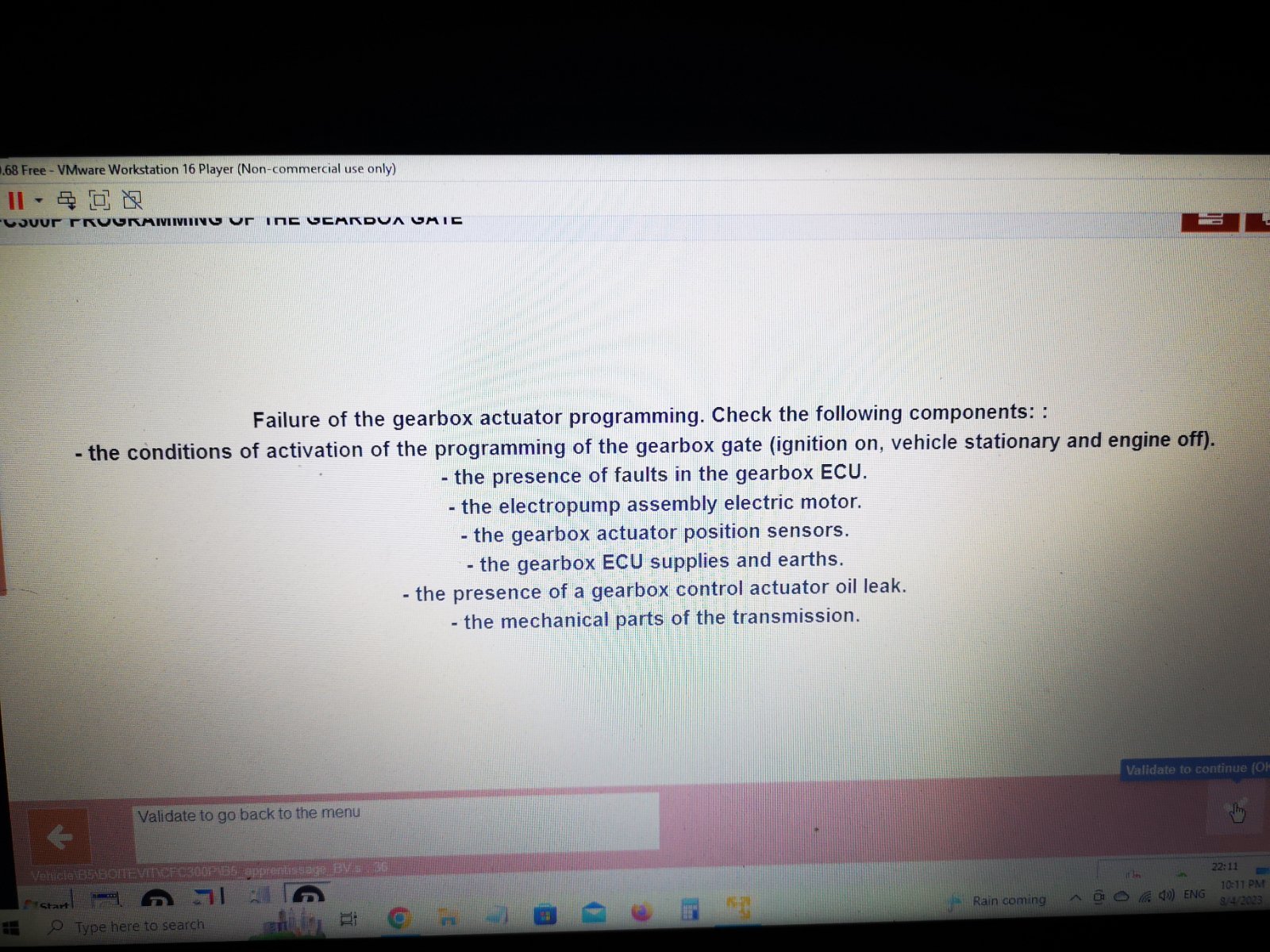

When started programming car gone in economy mode and programming stopped.
Mechanic added another battery and jump pack as believed that car battery is low. Since then not able to perform depressure test, bleeding or programming.
Tried with diagbox, no faults while doing depressure test or bleeding, but coming up with fault when trying to programm the gearbox.
How to get it working again.
When mechanic started programming with his mag toll, we could hear gearbox switching the gears, but now nothing.

That's a big mistake - attempting a configuration or programming operation without ensuring the battery is connected to another power source. It has now likely to have left the ECU unconfigured as can be seen above - the operation has been interrupted.
Also, you should have dealt with the other fault codes first before attempting the programming / grid calibration of the gearbox actuators / clutch.
If your vehicle battery is shot or anything over 5 years old it will also be degraded and may also cause issues with the electrical systems.
Looking at the previous fault codes, I would suggest that P0868 is your main one that has caused the initial problems with insufficient hydraulic pressure in the actuators that do the clutch and gear changes.

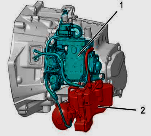

It is a electrohydraulic system that uses an ECU and a device for piloting S-CAM actuators by Magneti Marelli.
(1) Actuator electro-hydraulics.
(2) Actuator electro-pump
So it uses an actuator electro-pump unit electric motor, with pressure stored in the accumulator.
Diagnostic kit is required to depressurise the hydraulic system before any work is carried out!
