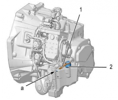

You would undertake a Global Diagnostic and then access the Gearbox Piloted ECU:
->Gearbox ECU
->Specific operations
-> Check of the gearbox piloting actuator oil level
From within the next menu:
Select: Depressurisation of the hydraulic circuit.
All the oil contained in the electrohydraulic actuator unit and in the pressure accumulator returns to the piloting actuator hydraulic reservoir.
-> Check the level of oil contained in the piloting actuator hydraulic reservoir.
-> The oil level must be at maximum ( as "a").
Carry out:
> Top up with oil if necessary
-> Pressurise and bleed the hydraulic circuit

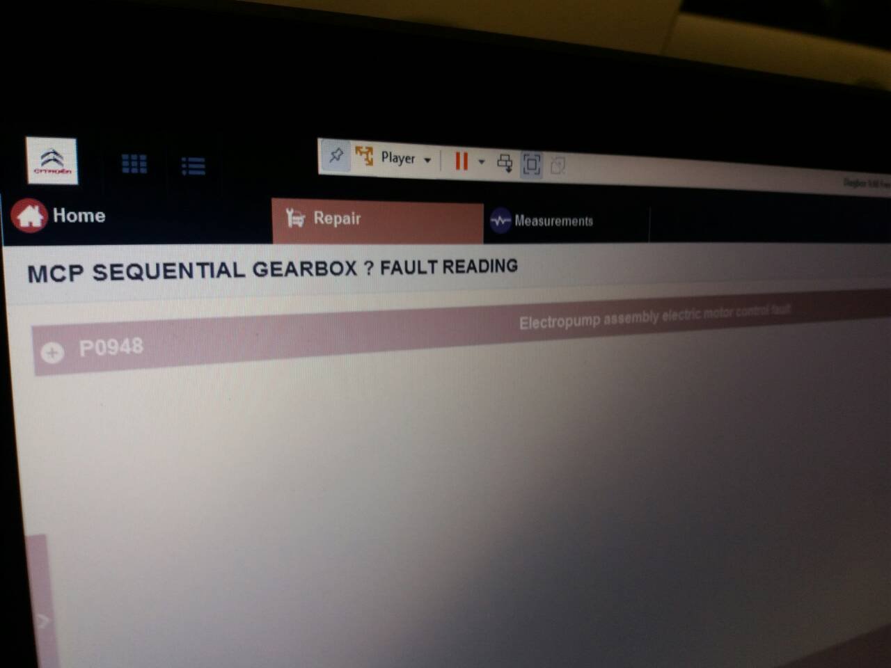

Hi, I change gearbox and tried to programming a gearbox. There is piloted gearbox.
My car is C5 1,6 e-hdi.
I can't to comminicate with piloted manual in lexia because of error code P0948.
I did eveything (checked connectors, battery etc).
My car starts fine, error is gearbox, AUTO is flashing and N is on main board.
Can you help me to solve this problem?

Re: c4gp 2014 egs gearbox fault will not program
Here's a description of the fault that may help you troubleshoot the issue:
Start with the connector on the gearbox ECU as stated below on pin 1 for a start, then look at the other suggestions.
| Fault Code: | P0948 |
| Description of Fault: | Electro-pump unit electric motor control fault : Relay jammed open. Open circuit or short circuit to positive or short circuit to earth (Pin 1 of the 12-way connector of the ECU). Technical precision on the context of appearance of the fault code: Supply voltage correct |
| Conditions for Fault to clear: | No faults for 1 second |
| Downgrade Modes whilst Fault is active: | If the vehicle has the Stop and Start system : Stop and start function deactivated
| Symptoms: |
| Suspect Areas: | Frequent causes:
ladotg
- Posts: 17
- Joined: 10 Jan 2020, 15:33
- x 2
How to do this: "Open circuit or short circuit to positive or short circuit to earth (Pin 1 of the 12-way connector of the ECU)".
Do you have picture of this connector?
Thanks!
