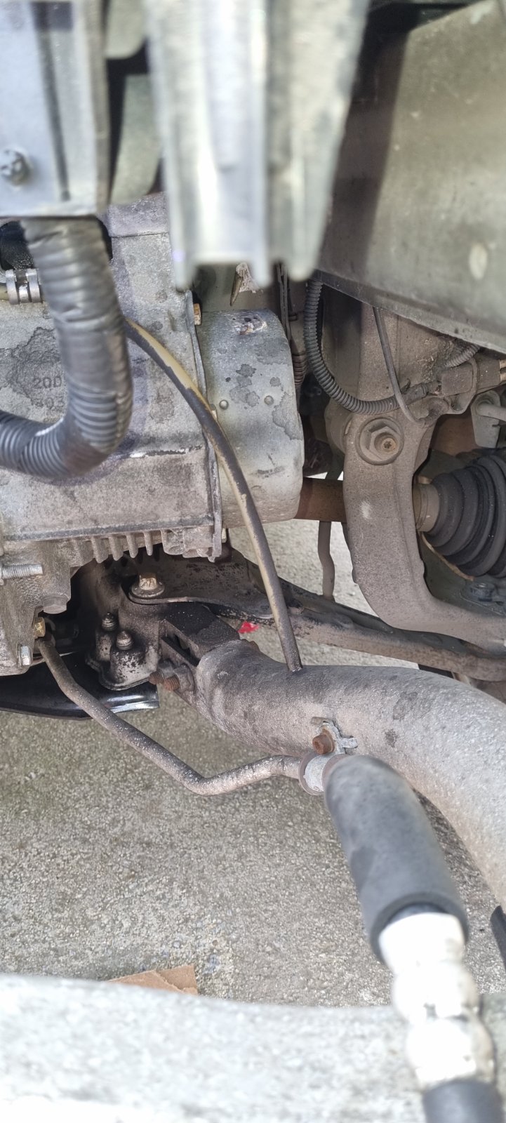

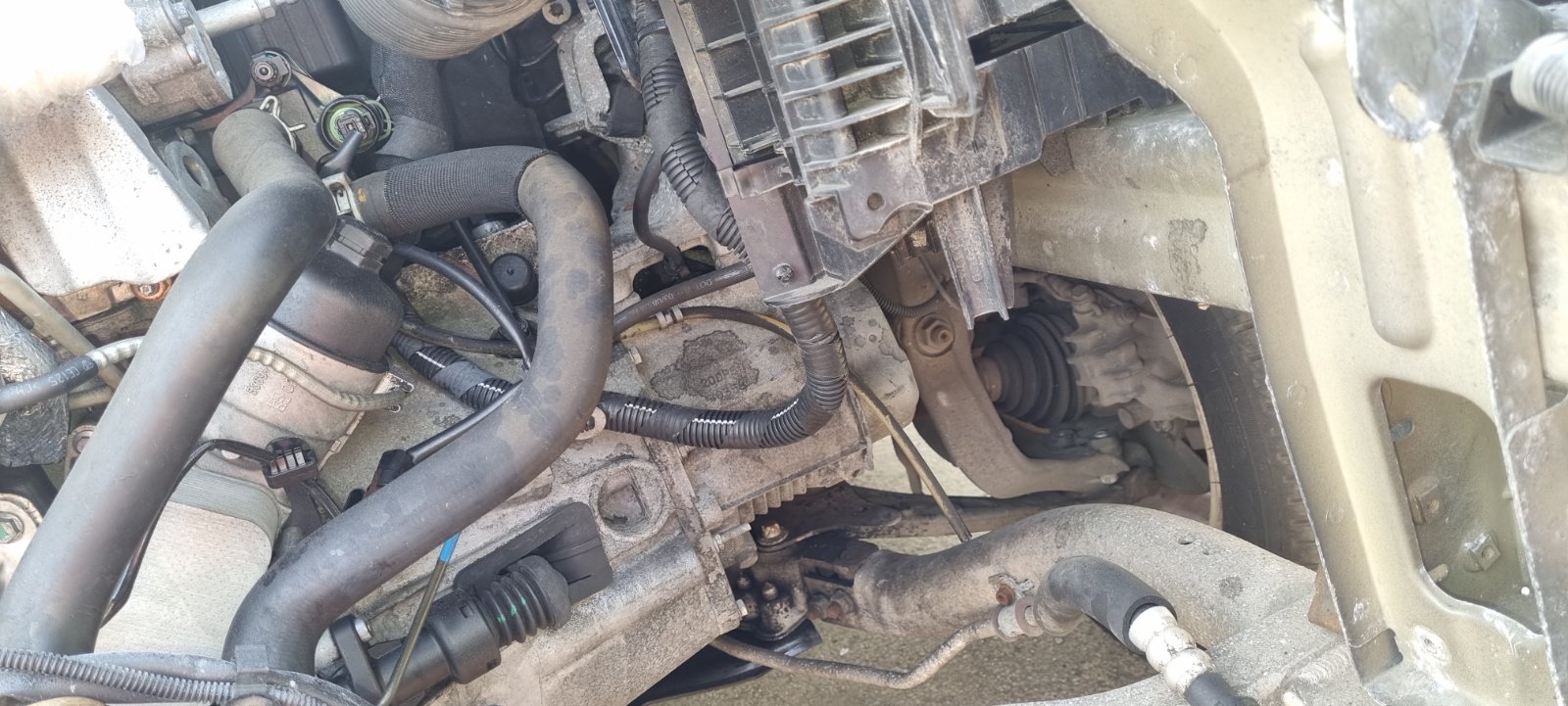

not wanting to abuse but while i took the front of my car for a little crash i saw this disconnected tube is normal?
Reason: Removed Quote

It looks like a drain tube for maybe the fuel filter to allow water to be drained from it ?

admiral51 wrote: 28 Mar 2021, 14:37 It looks like a drain tube for maybe the fuel filter to allow water to be drained from it ?
Yes, I also think! but as it has the motor protection (plastic) underneath I found it strange to drain it over it
x 6957
Re: C5 X7 - Removing Dash After Airbag Triggering
It's more likely to be the Air Conditioning drain pipe. It is normal to be left loose so the water can drain out. That's why you can sometimes see a pool of water under the car on a hot day when the AC has been on.

GiveMeABreak wrote: 28 Mar 2021, 15:13 It's more likely to be the Air Conditioning drain pipe. It is normal to be left loose so the water can drain out. That's why you can sometimes see a pool of water under the car on a hot day when the AC has been on.
oh yes there is logic ty bro you ar the Best!

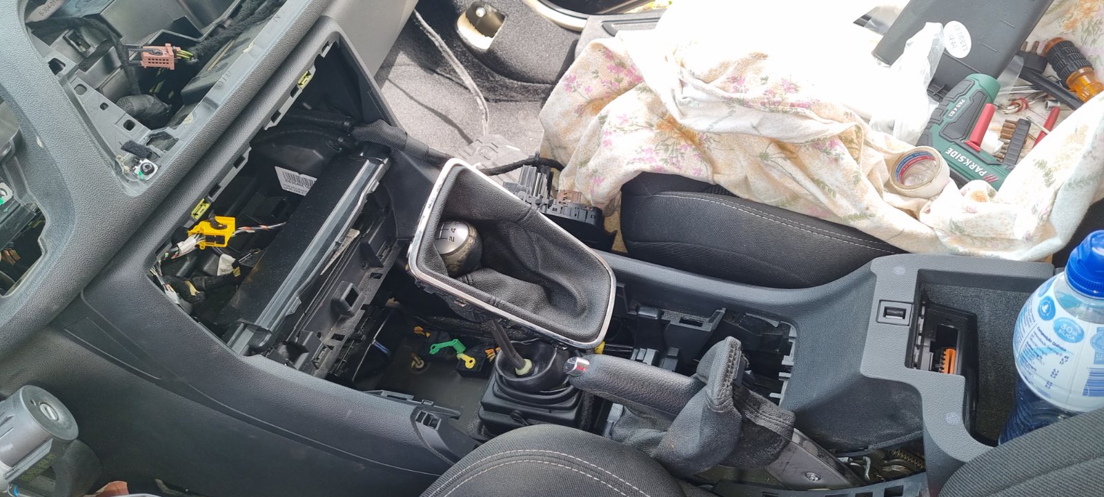

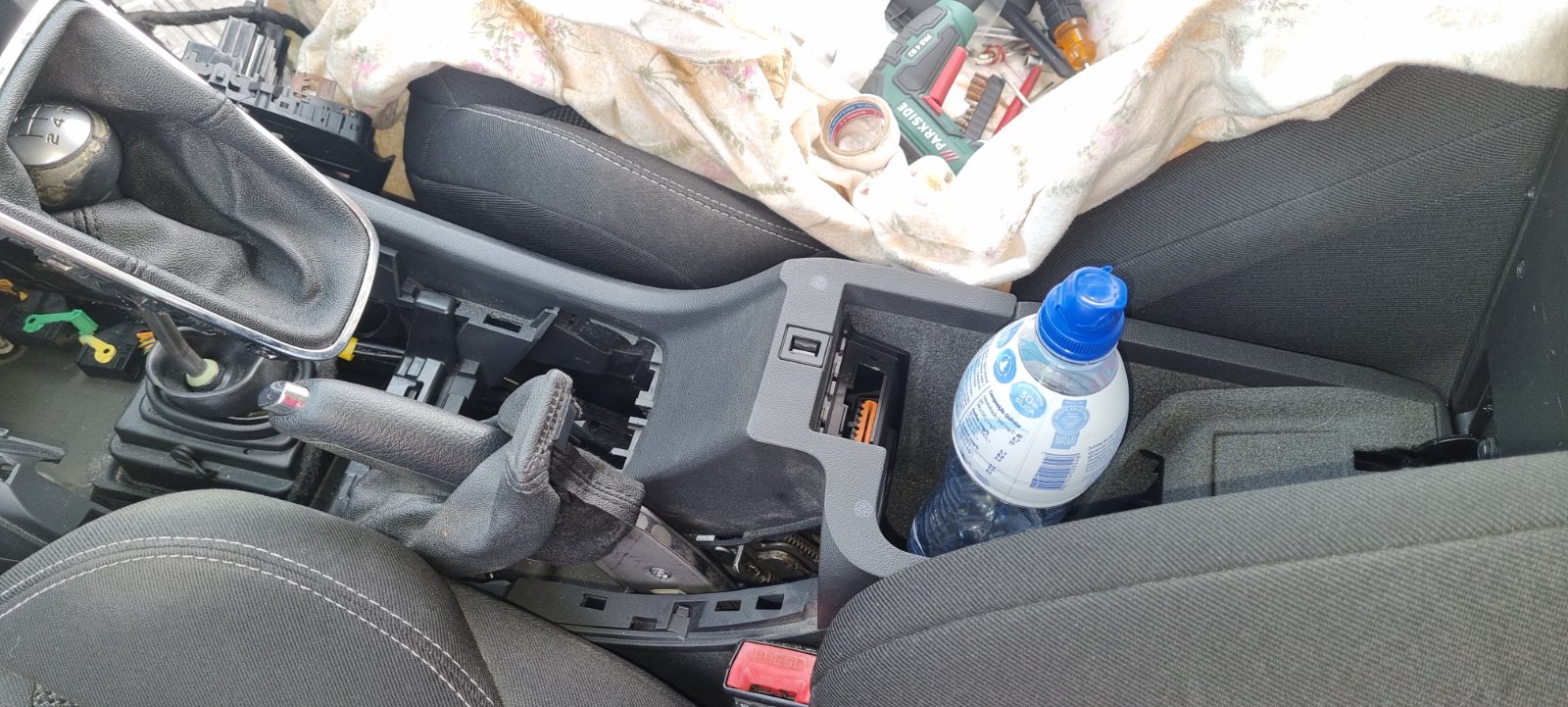

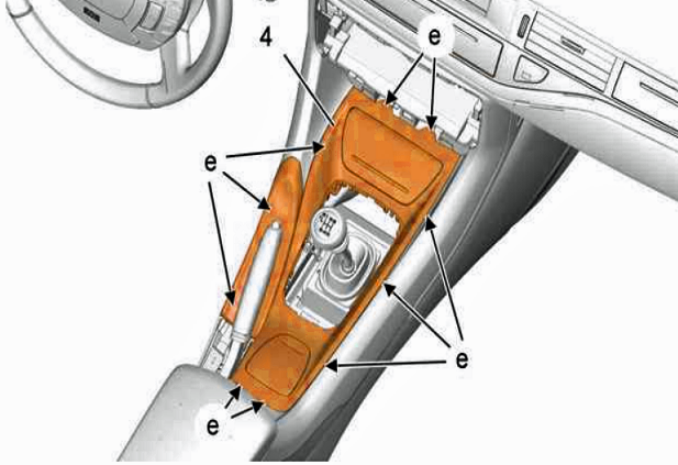

one last question I just need to remove the center console as shown in the picture ... do you think you can help me again? it's so stuck and I need to let it go for the tablie to come out #-o

Other photo
x 6957
Hang on, I'll put that up for you shortly.

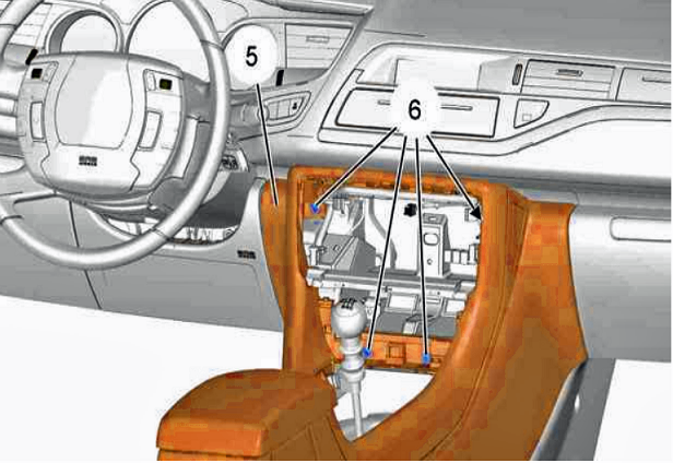

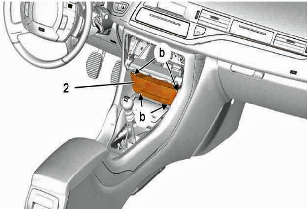

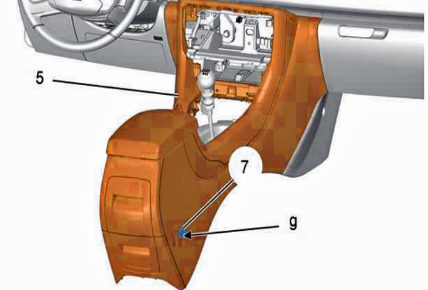

C5 X7 Centre Console Removal (Manual Gear Box)
Move the front seats as far back as possible.

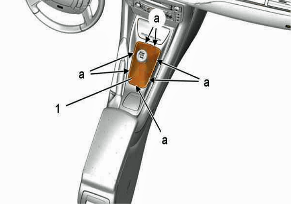

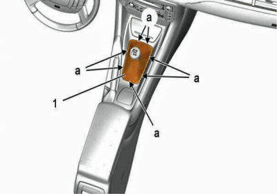

Unclip the gear lever gaiter ( 1) ( as "a" ) using trim removal tools.
Disengage the gear lever (1) gaiter .
Remove:
  • The audio system
  • The air conditioning control ( automatic).
Unclip: The glove box (2) ( as "b" ) using trim removal tools.
Remove the glove box (2).

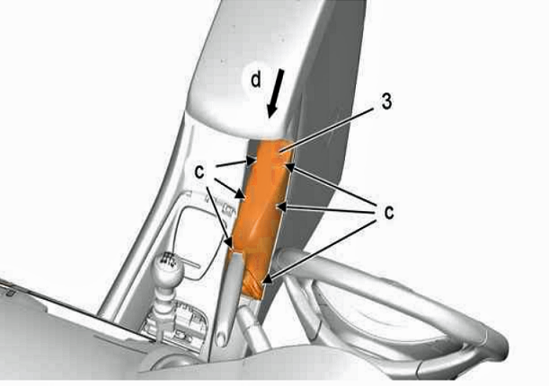

Unclip: The handbrake gaiter (3) ( as "c" ) using trim removal tools.
Remove: The handbrake gaiter (3) (At "d" ).

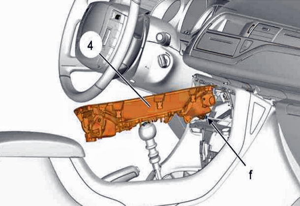

Unclip: The facia of the central console (4) ( as "e" ) using trim removal tools.
Detach: The facia of the central console (4).
Disconnect the connector ( as "f" ).
Remove: The facia of the central console (4).

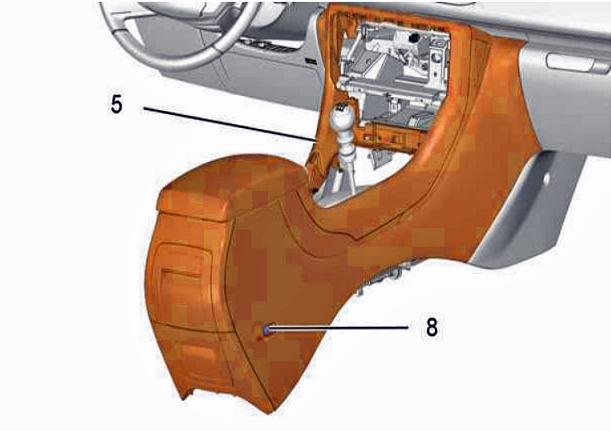

Remove the bolts (6) (Central console (5) ).
Slide the front seats as forward as possible.
Electric seats:
  • Reconnect the battery
  • Slide the front seats as forward as possible
  • Disconnect the battery
Unclip the blank ( 7) (Central console (5) ) ( as "g" ) using trim removal tools. (Symmetrical operation ).
Remove the blanking piece (7) (Central console (5) ) (Symmetrical operation ).
Remove bolts (8) (Central console (5) ) (Symmetrical operation ).

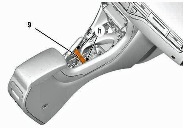

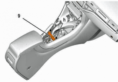

Unclip: The stiffener (9) (Central console (/) ) ( as "h" ) using trim removal tools.
Remove the stiffener (9) (Central console (/) ).
Open the central armrest.

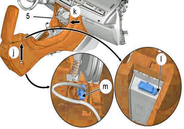

Unclip the diagnostic socket ( as "l" ).
Detach:
  • The diagnostic socket through the central console (5)
  • The centre console (5) (Towards "j" then "k" )
Disconnect the 12 V socket connector ( as "m" ).
Remove the central console (5).

The bolts (6), (14) to 0,4 ± 0,25 daN.m
The bolts (8), (16) to 0,5 ± 0,25 daN.m
