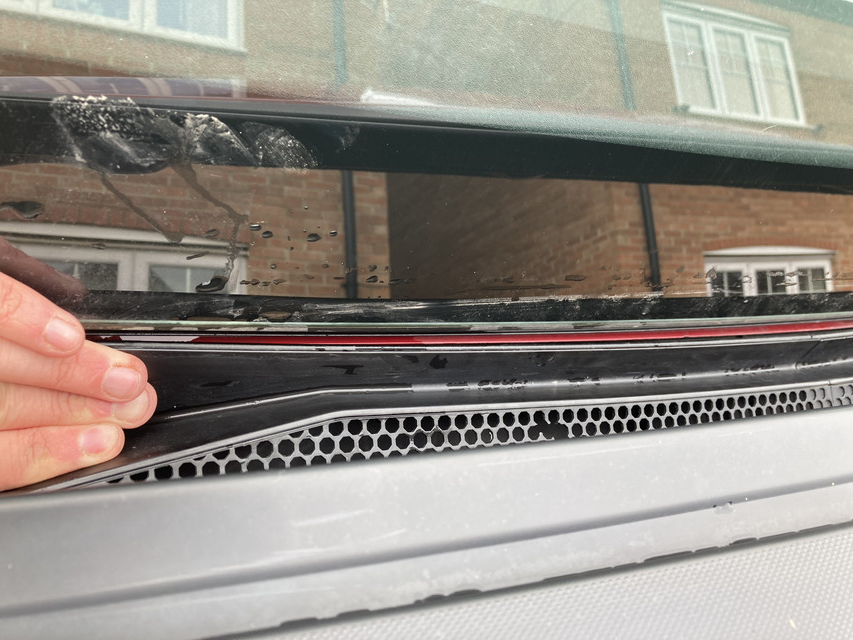

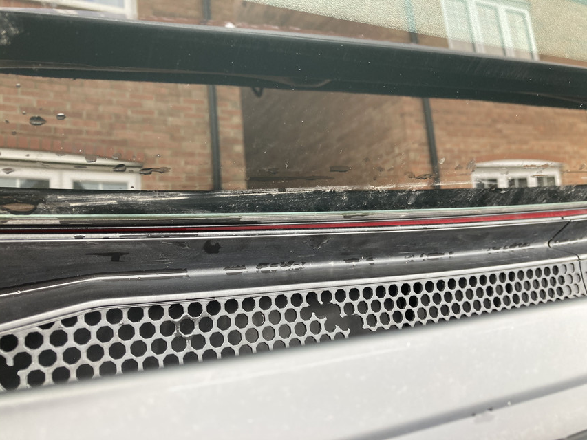

Cheers for that , I’ve been having a look at the drains behind the front wheels and the scuttle panel and I noticed there was a gap between windscreen and panel like it’s not sitting right
Ive managed to get it back on flush but I think all the rain water has been just running down my windscreen and ontop of the engine because the heat cloth stuff is soaking as well.
I am now itching to see if that’s what’s caused the problem with the egr but I think I’m best letting the mechanic do it haha. I had a drive in it before and got the reappearance of the depoluttion error with all the other errors.

It's quite awkward getting that trim back on - it should clip into the track at the bottom of the screen, but you need to feed it in from each side pressing quite hard to clip it in. It will all need to come off to do the EGR anyway... The fuel and air filters have to come out as well to do the EGR, if they've not been changed recently I would get them to stick new ones in whilst they are there.
