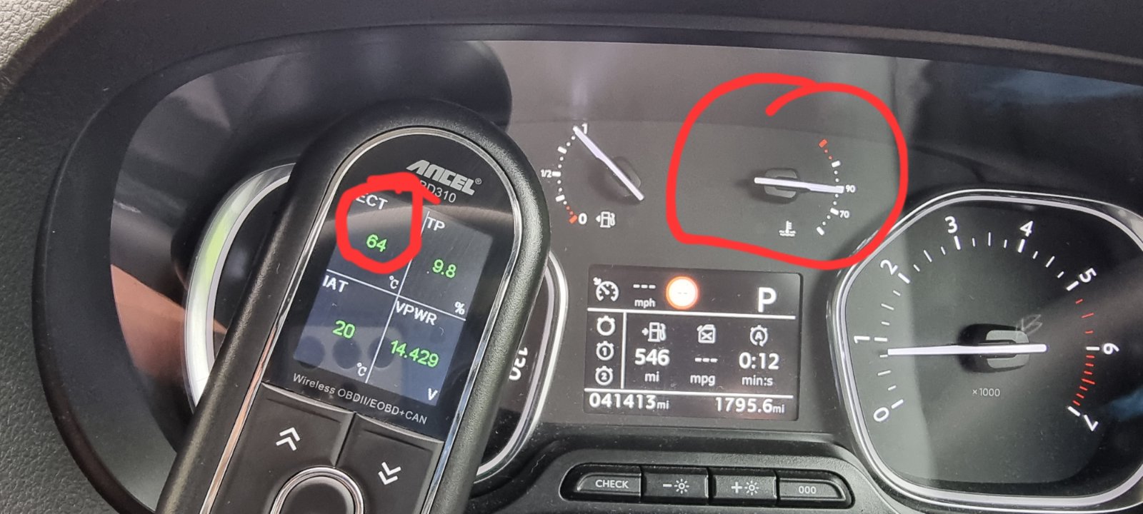

Hello guys. I have absolutely the same problem with my Peugeot Traveller 2.0 bluehdi 42k miles. Also changed the thermostat housing and checked everything. Currently don't have clue. From the dealership said "that they are not concerned about this" For me have two possibilities. First is software problem that rule and command the housing. The second one is something wrong with the additional heater in my case webasto. I am still investigating.

The picture attached is after 40 minutes driving. Compared what see the ECU and the dashboard. Big difference isn't it.
