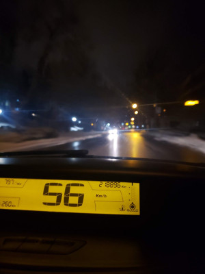

**** Edit just looked at the pics it could be a faulty display unit not reading correctly, Hdi do run cool but if cabin temp is normal and stat appears to work *****

The car in question is a C4 1.6HDi 90bhp. I believe the display is correct because when the temperature reaches the middle the air vents blow hot air and when it starts dropping down when there is no load on the engine, the air from the vents becomes just warm.admiral51 wrote: 27 Jan 2021, 19:40 Just for clarity, are we talking about a C4 1.6 Hdi 90 bhp or the C5 2.0 136 bhp?

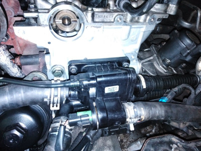

I put my old thermostat in the box of the new one and it is still in my boot but it is late and we have knee deep snow here so I will check what it says tomorrow. The salesmen in the auto parts store asked me about my car's year, model and engine and recommended me this one so I just bought it and put it on. If I remember right it opens at 83 degrees but I am gonna check tomorrow for sure.

Re: 1.6 hdi coolant temperature fluctuating
I almost changed the thermostat on my Peugeot, the thermostat comes complete with a housing and connectors.

This is the same as the one I bought (complete with the housing and a new sensor) and the same as the old one I removed from the car. I checked the packaging of the new thermostat and it indeed opens at 83 C*.
