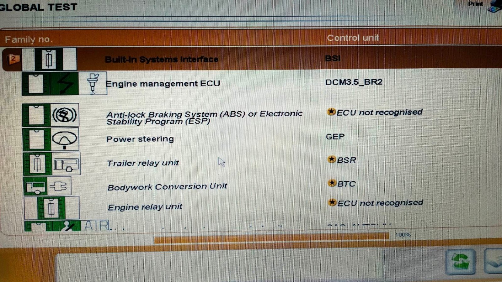

I can't really decide on anything as I'm still not sure what I'm missing. How can i determine if my VCI is at fault? What I'm hoping for is a definite answer as to what v of Diagbox I need. There'sa lot i can read using 7.76. Injection timings and fuel rail pressure for instance.
Based on the advice i'm being given i'm still not sure what I need to do.
Thanks again for coming back to me.
- x 6945
Re: DIAGBOX 9.68 MR RORRY
This is the issue, to be honest, as there are so many sellers of these clones, that unless you open up the unit and know what you're looking for on the boards (specific resistor, chips, Optocouplers) etc. it will be hard for us to do that on the Forum - the other added issue is that the software is not supported by Citroen as it has been 'modified' to allow use by the DIYer or small garage mechanic.
You either need to forget all about Diagbox (and return your VCI to Amazon) then get something else that will read your Van and give you live data.
We're not going to get anywhere fast here as we simply don't know your hardware components or whether DB7 will work given the lateness of your VAN.

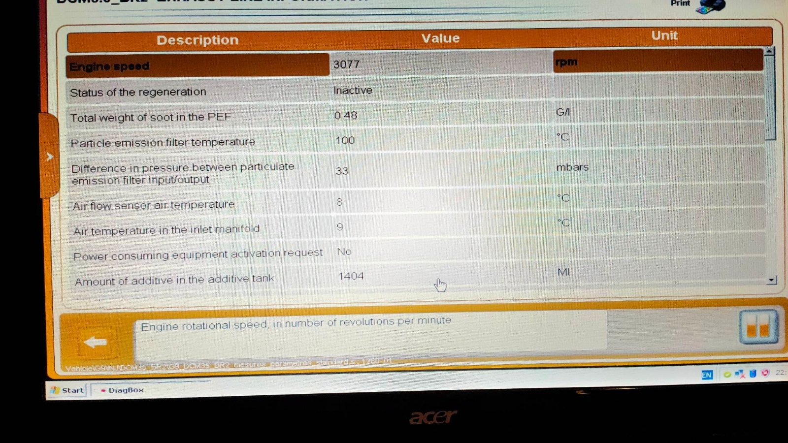

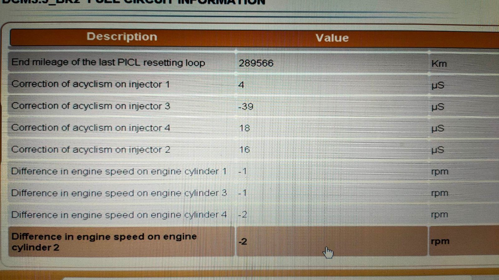

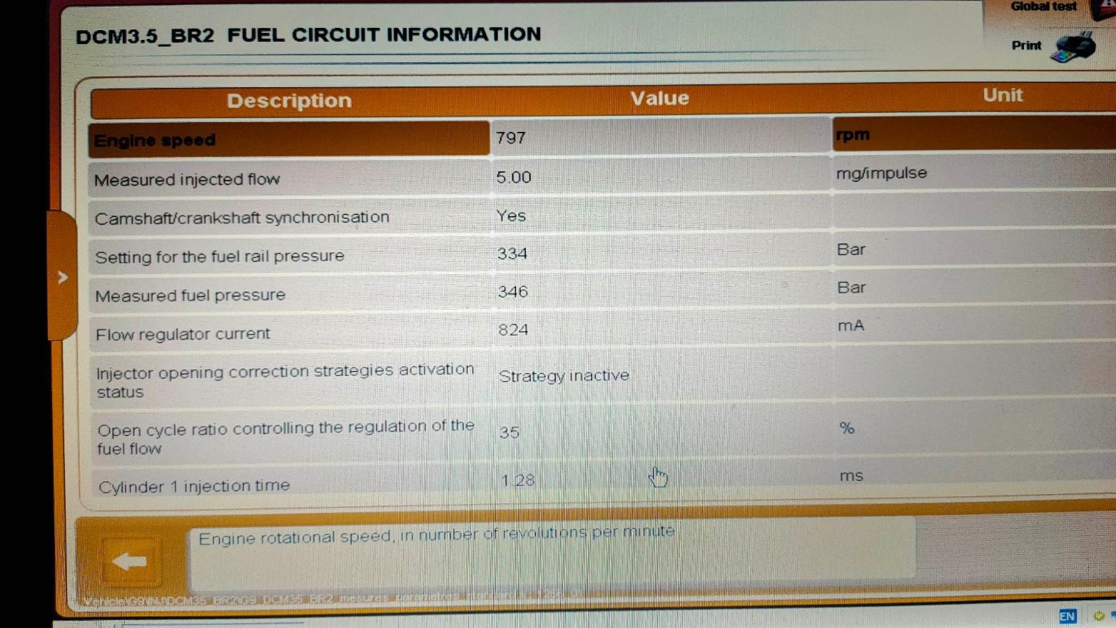

I can get Live Data....I'm just not sure what to do with it. :O Today I was reading the Fuel Rail Pressure, but there are no faults at all on the van. My friend thinks it's a blocked DPF as the readings on another app FAP from Amazon Citroen/Peugeot Specific , suggests it is nearing end of life and 93% blocked with Cinder, not Soot.
Maybe we cold start with what I can actually read?
Thanks for sticking with me fella's While the van runs and I have completed over 5000 miles in it, it's not running right.
Here's what I can gather so far:
