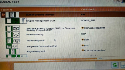

I can get Live Data....I'm just not sure what to do with it. :O Today I was reading the Fuel Rail Pressure, but there are no faults at all on the van. My friend thinks it's a blocked DPF as the readings on another app FAP from Amazon Citroen/Peugeot Specific , suggests it is nearing end of life and 93% blocked with Cinder, not Soot.
Maybe we cold start with what I can actually read?

Re: DIAGBOX 9.68 MR RORRY
Thanks for sticking with me fella's While the van runs and I have completed over 5000 miles in it, it's not running right.
Here's what I can gather so far:
