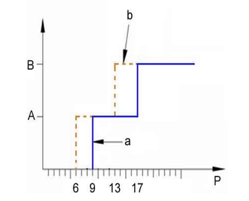

- Two temperature intervals allow the cooling fan to operate either at slow or at fast speed (Control in relation to the engine coolant temperature). See my last diagram showing triggering temperatures.
- The engine coolant temperature sensor, installed on the coolant outlet housing, informs the engine ECU of the temperature of the engine coolant.
For cooling of the condenser, the B.R.A.C. function (Air Conditioning Need For Cooling) supplies the F.R.I.C. function (Cooling Function Integrated into the Engine ECU) with a reference speed in accordance with the pressure of the air conditioning circuit.
The linear pressure sensor of the refrigerant fluid fitted on the condenser supplies a voltage proportional to the pressure in the air conditioning circuit and transmit this information to the built-in Systems Interface on the CAN IS network.
The engine fuse box sends a speed reference value to the engine management ECU making it possible to control the slow speed or fast speed of the cooling fan unit.
| Key "a" Cooling fan unit speeds triggering thresholds. "b" Fan unit speeds untriggering limits. "A" Fan assembly low speed. "B" Cooling fan unit fast speed. "P" Pressure (in bars). |
