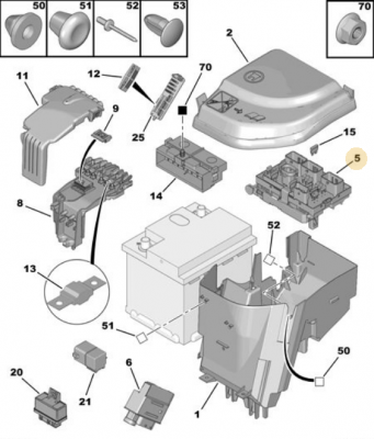

thanks for that, if I am ordering a temp sensor from eurocare then I may as well change the relay at the same time, which do I need? sorry to be a pain.

Your Berlingo doesn't have a separate relay showing on this engine (normally in the Fan Cowling Assembly), which means the function is integrated into the a relay within the Engine Fusebox - and these are generally non-serviceable.

Re: DPF
Post by GiveMeABreak »
Fuse boxes? - No
Engine FuseBox - item (5)
Old part: 9807028880
Replacement (Updated) Part: 9807028780

Post by wayne10 »
thanks Marc, expensive part to change just in case, will try the sensor first.
