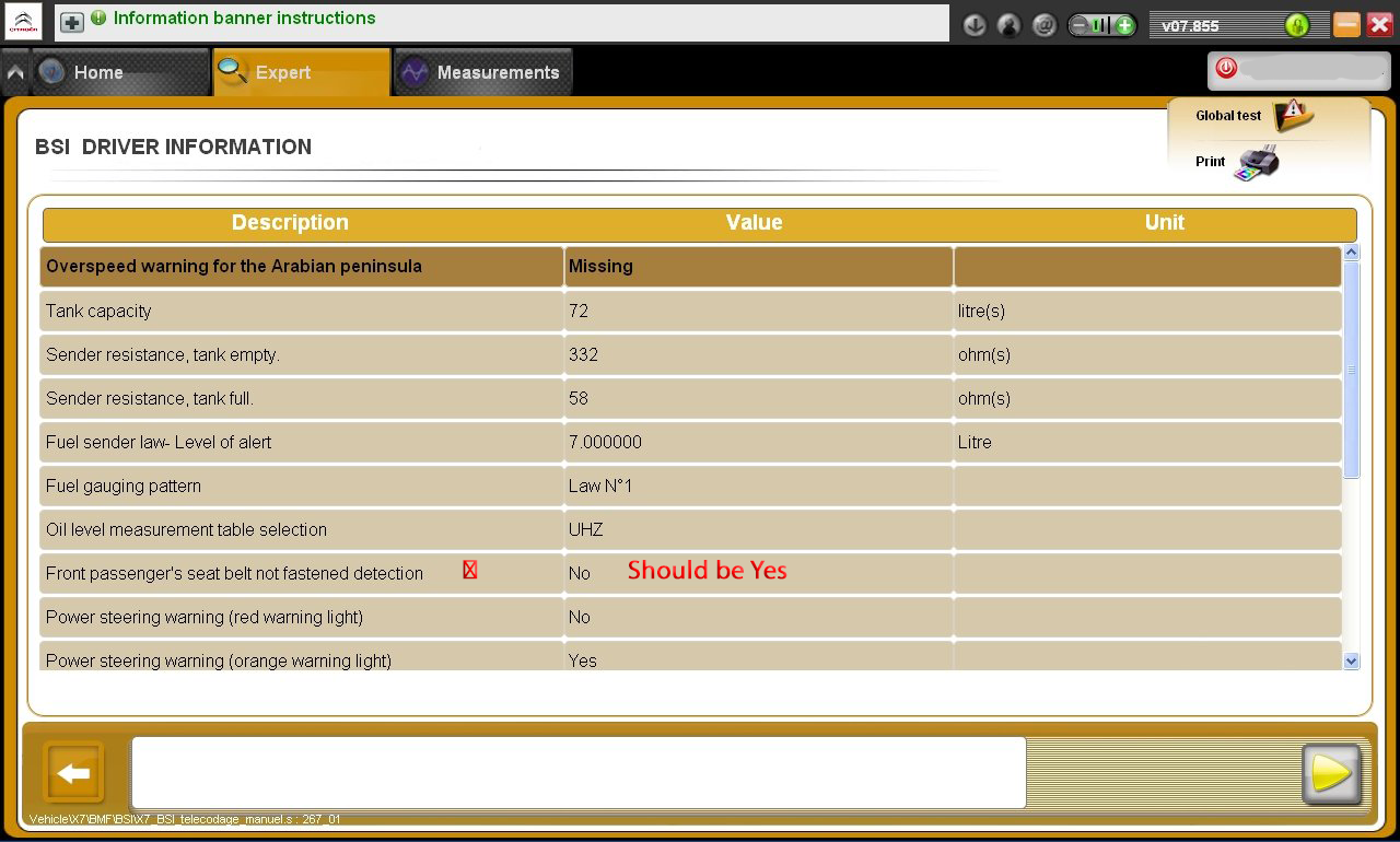

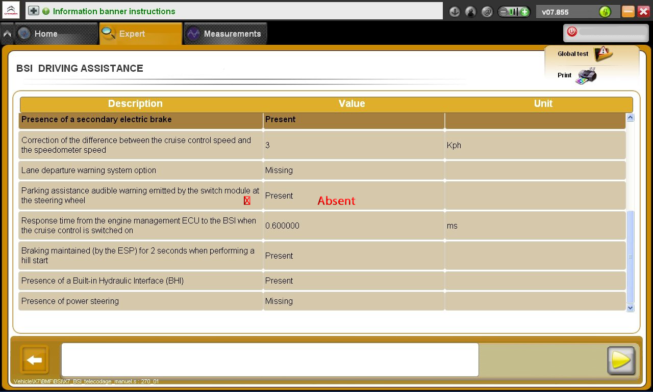

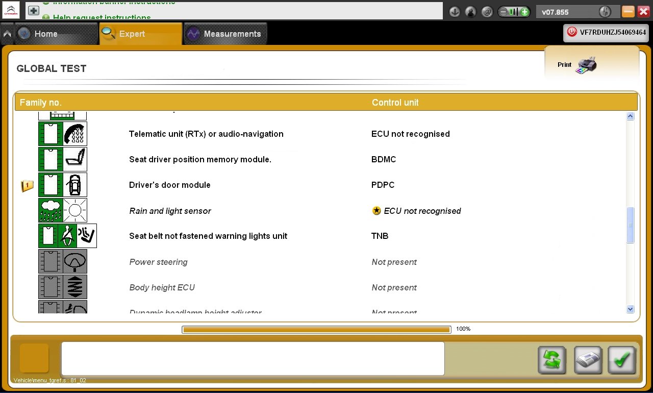

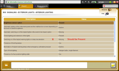

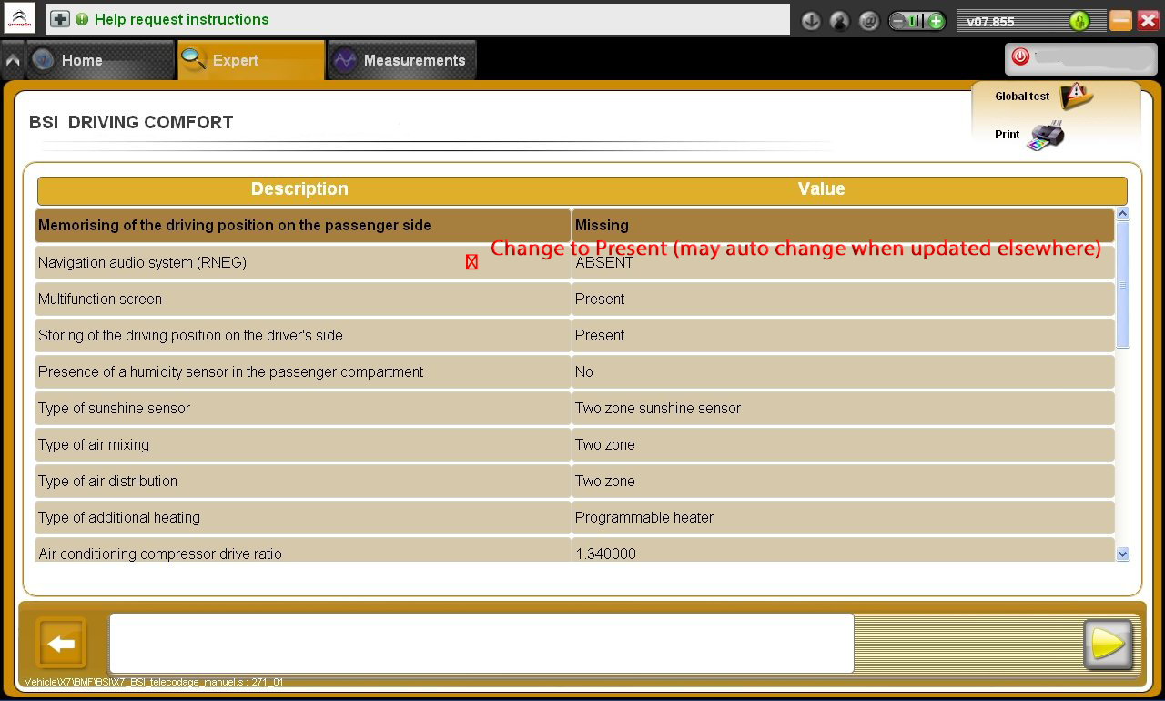

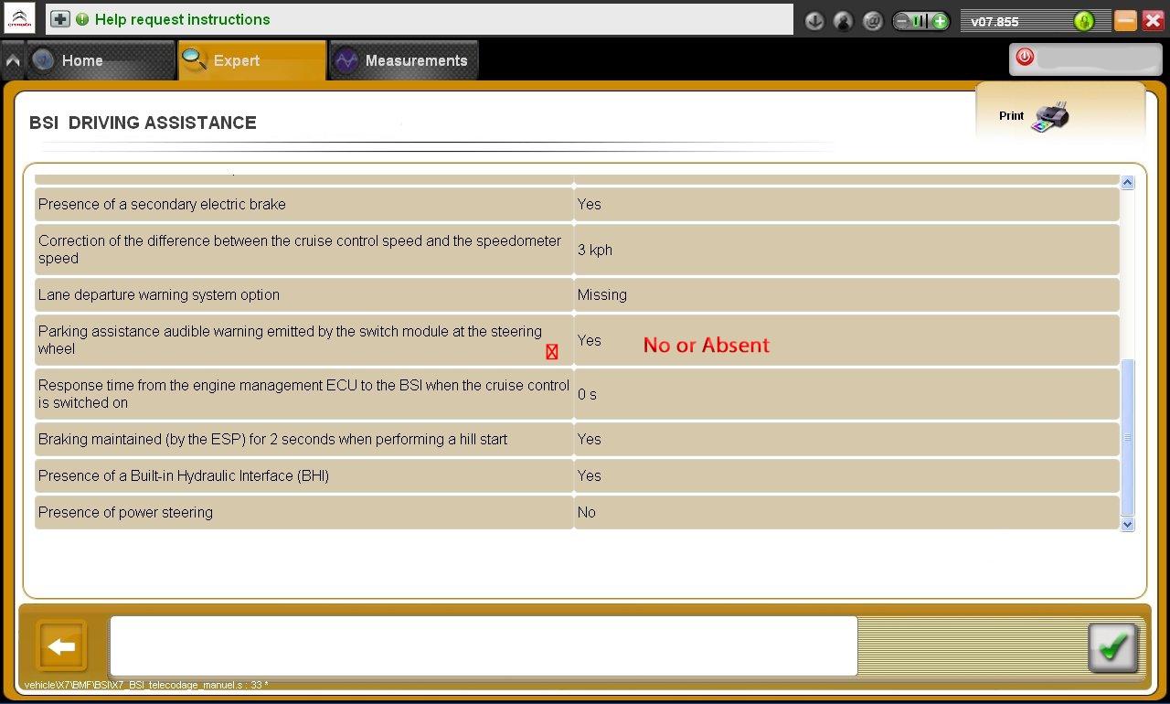

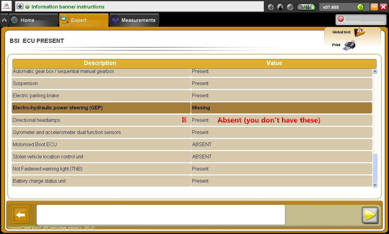

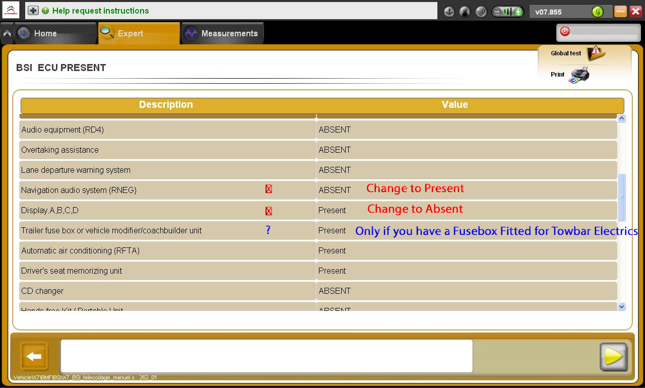

Right, here you go.
Remember that some of the lists just show which ECUs are present. Some of the other screen shots show what the BSI is configured to.
I have therefore compared your vehicle as it shipped with correct options, (accounting for parameters that must be set for Finland), against the changes for the RNEG system you have fitted.
You also have an incorrect setting for directional headlamps that you do not have (you have static halogens, not bi Xenon directional headlamps), so I have picked up the settings to change.
Your seat belt warnings were all incorrect too and your Inflation detection was disabled.
I think I have now highlighted the correct settings you need for the Audio and Telematics.
There are a lo to duplicates on the pages and you may find that once you have corrected the parameters, they may update t he other sections. At least with my amendments you now have a reference of what you changed.
Click Images to magnify
Note! For anyone else browsing, these notes are ONLY specific to the Poster's vehicle and the specific fitted options (with Audio modifications) fitted, so will not be correct for other vehicles

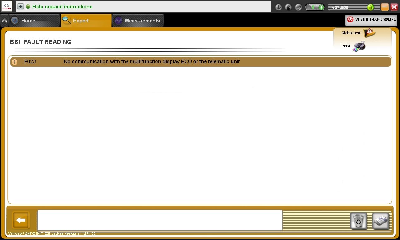

Here again,
I did make the changes (not tyre/seatbelts at the moment), but still BSI errorcode F023.
After that I make a one little extra with Diagbox:
- "install" RD4 again, so now the echo sound is off. Only one, not directional, low tone is present.
(Diagbox did say that install not completed, so radio is "connection problem" but sound did change).

Re: RD4 to eMyWay/RT6 swap problem
Well another chap had this error on his 407 -
viewtopic.php?t=61002
I'm not sure what the outcome was. Maybe you have a faulty unit too?
The reason I suggested you put everything back to the standard entries is to try and eliminate problems. You may not want the seatbelt warning signs on but they are required and should always be set to enabled. Changing some of the settings can have undesired consequences other systems.

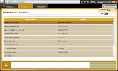

Maybye it is broken someway? but radio, cd- music and navigation systems are working. No navigation information in the dashboard matrix-screen though.
- When I connect my phone in, I noticed its bluetoothname is Peugeot?
( and noticed, that I do not have a microfone connected
- If I click the unknown telematic unit ecu. I can see an opening page, where this in named rneg2010? , not rneg2/rt6
Can this be a cause of this connection problem.

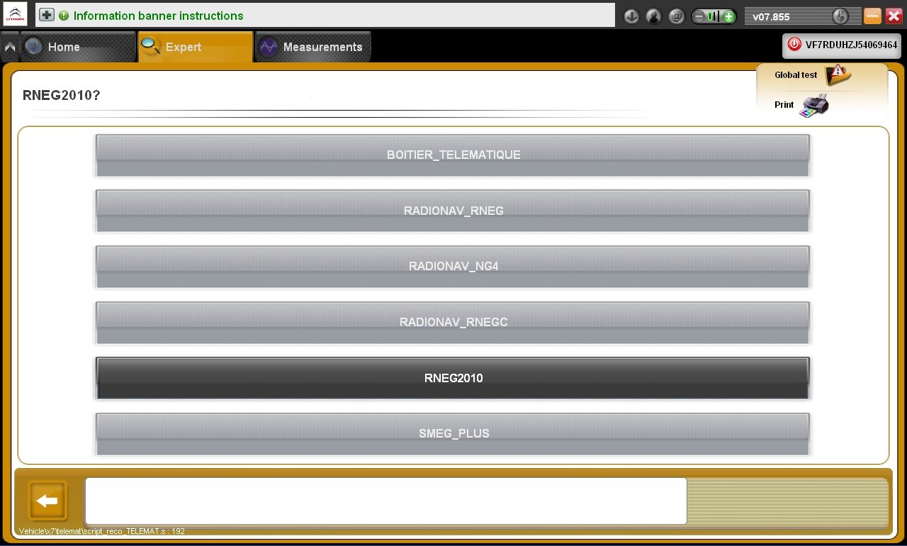

No - that's for the RT6, you need the second on the list, RADIONAV_RNEG
One thing I forgot to tell you (with the other problems), was that you need to go into the Instrument Panel ECU and change ONLY the setting regarding Navigation:
Locate this and change to the following.
NAVIGATION OPTION: - FUNCTION DISPLAYED
This will put the directions up on the Matrix display.
My Bad - I'm confusing another post! Choose RNEGR - 4th on the list. RNEG 2010 is for the later RT6 for vehicles with the 2010 electronic Archtecture, which is not on your X7. Sorry about that!
Mhirvi
- Posts: 19
- Joined: 02 Aug 2020, 14:10
Ok,GiveMeABreak wrote: 11 Aug 2020, 20:04 My Bad - I'm confusing another post! Choose RNEGR - 4th on the list. RNEG 2010 is for the later RT6 for vehicles with the 2010 electronic Archtecture, which is not on your X7. Sorry about that!
Can you please confirm from this picture, that I cfoose the right option.
- x 6956
Yes Magneti Marelli is the manufacturer.

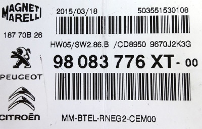

Mhirvi wrote: 12 Aug 2020, 07:40Hi again,GiveMeABreak wrote: 11 Aug 2020, 20:04 My Bad - I'm confusing another post! Choose RNEGR - 4th on the list. RNEG 2010 is for the later RT6 for vehicles with the 2010 electronic Archtecture, which is not on your X7. Sorry about that!
When I take my radio out of the console I did noticed that it was made year 2015. So would the rneg2010 be right choice for me.
- can this be also the reason why my car does not identify the device correctly.
Also have errorcode F303 "secure configuration fault" ?
Could you help me with this matter again please.
