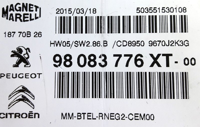

Ok,GiveMeABreak wrote: ↑11 Aug 2020, 20:04 My Bad - I'm confusing another post! Choose RNEGR - 4th on the list. RNEG 2010 is for the later RT6 for vehicles with the 2010 electronic Archtecture, which is not on your X7. Sorry about that!
Can you please confirm from this picture, that I cfoose the right option.

Yes Magneti Marelli is the manufacturer.

Mhirvi wrote: ↑12 Aug 2020, 07:40Hi again,GiveMeABreak wrote: ↑11 Aug 2020, 20:04 My Bad - I'm confusing another post! Choose RNEGR - 4th on the list. RNEG 2010 is for the later RT6 for vehicles with the 2010 electronic Archtecture, which is not on your X7. Sorry about that!
When I take my radio out of the console I did noticed that it was made year 2015. So would the rneg2010 be right choice for me.
- can this be also the reason why my car does not identify the device correctly.
Also have errorcode F303 "secure configuration fault" ?
Could you help me with this matter again please.
