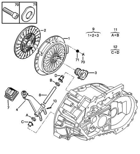

The Clutch Cable (5) was either part 2150T8 for the BVM ME Gearbox or 2150L3 for the BVM MG5T Gearbox (Long 1734)
Both these parts showing as no longer available from Citroen.

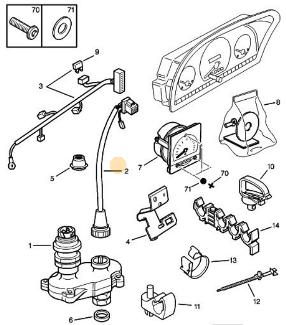

The Speedo cable (2) was part 6123J8 - again no longer available. These are the other bits: (Click the images to magnify)
Anything marked as NFP are no longer available from Citroen.
That doesn't mean you can't get parts - just not from Citroen any longer. You at least have their part numbers and may be able to use these to help locate aftermarket substitutions.
The additional problem here is the age of the vehicle and at a time when a lot of the data was not transferred over to the electronic system. Another issue it would appear is the type of gearbox fitted - this may vary according to original specs, so they list all the compatible boxes - so I have put the diagrams and the part numbers up as I can't tell you exactly which box you have.

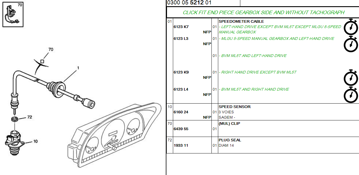

| Click on End Piece: Part Nos | Screw on End Piece: Part Nos |

It is very likely that this vehicle is fitted with the MG5 gearbox, as it was the only gearbox fitted to the Citroen XM with the 2.5TD engine, The ME gearbox would not have been strong enough.

Hi there, I need some part numbers for the three piece clutch on this van? Do I need to pay any more to find them out?
- x 6956
Re: How can I find out what I have here?
No, your contribution will cover you for up to 2 years. However, as I think I mentioned, data on this older engine is not as comprehensive as later models, as the part nunmbers are only internal PSA part numbers - which in a lot of cases here are no longer available given the age of the vehicle.
Click images to magnify
Here are the associated part numbers: The numbers on the table far left represent the numbers of the parts on the diagram.

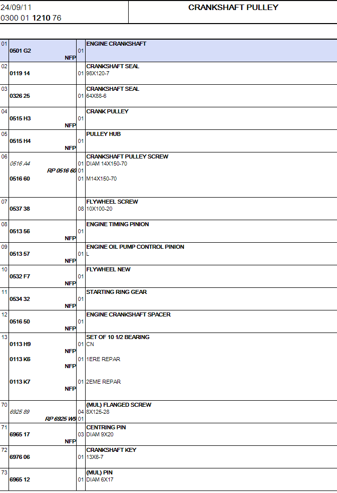

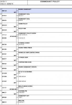

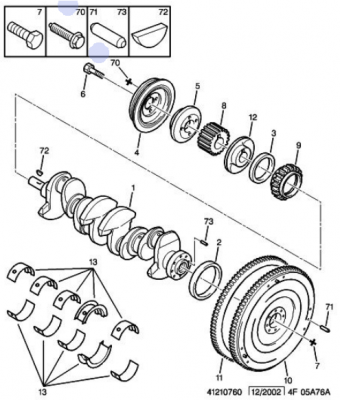

As per your PM, here is the info for the Flywheel parts:
Anything else you need, let us know.
