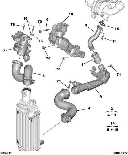

Here's the turbo air piping for your car.
Kenny
Kenny
C3 1.4 petrol (SWMBO)

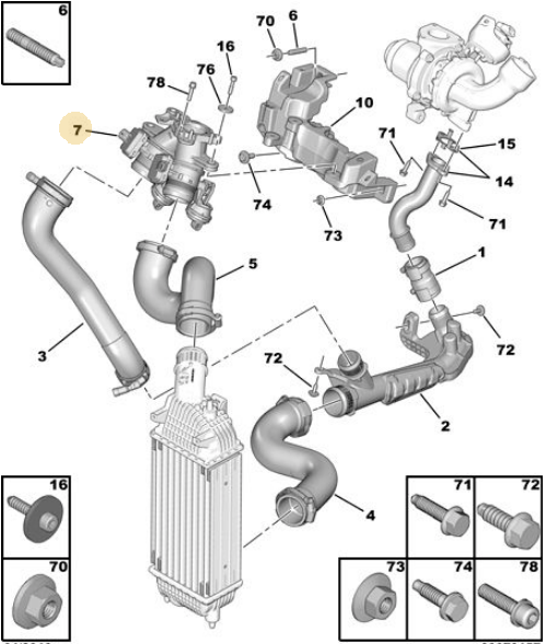

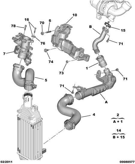

Between my engine and Belaprop's they changed the airdoser port from double to single , I think the RP was 12382.
I'll go and check for the correct number
Kenny
after 12382
before 12382
Kenny
after 12382
before 12382
