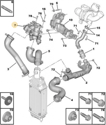

Re: Vacuum solenoid, C5 car diesel. Correct hose locations
Here's the turbo air piping for your car.
Kenny
Kenny
Is the Air Doser the double butterfly type, it looks like it is from the diagrams.
I know expense is a relative term, but i would check that as a priority, are both butterfly valves free to move and revert to normal at rest positions .
Colin
Colin
Yes, its a single port airdoser, and the valve moves to open which is it's rest position and closed at idle. So that is operating
Colin,
Between my engine and Belaprop's they changed the airdoser port from double to single , I think the RP was 12382.
I'll go and check for the correct number
Kenny
after 12382
before 12382
Kenny
