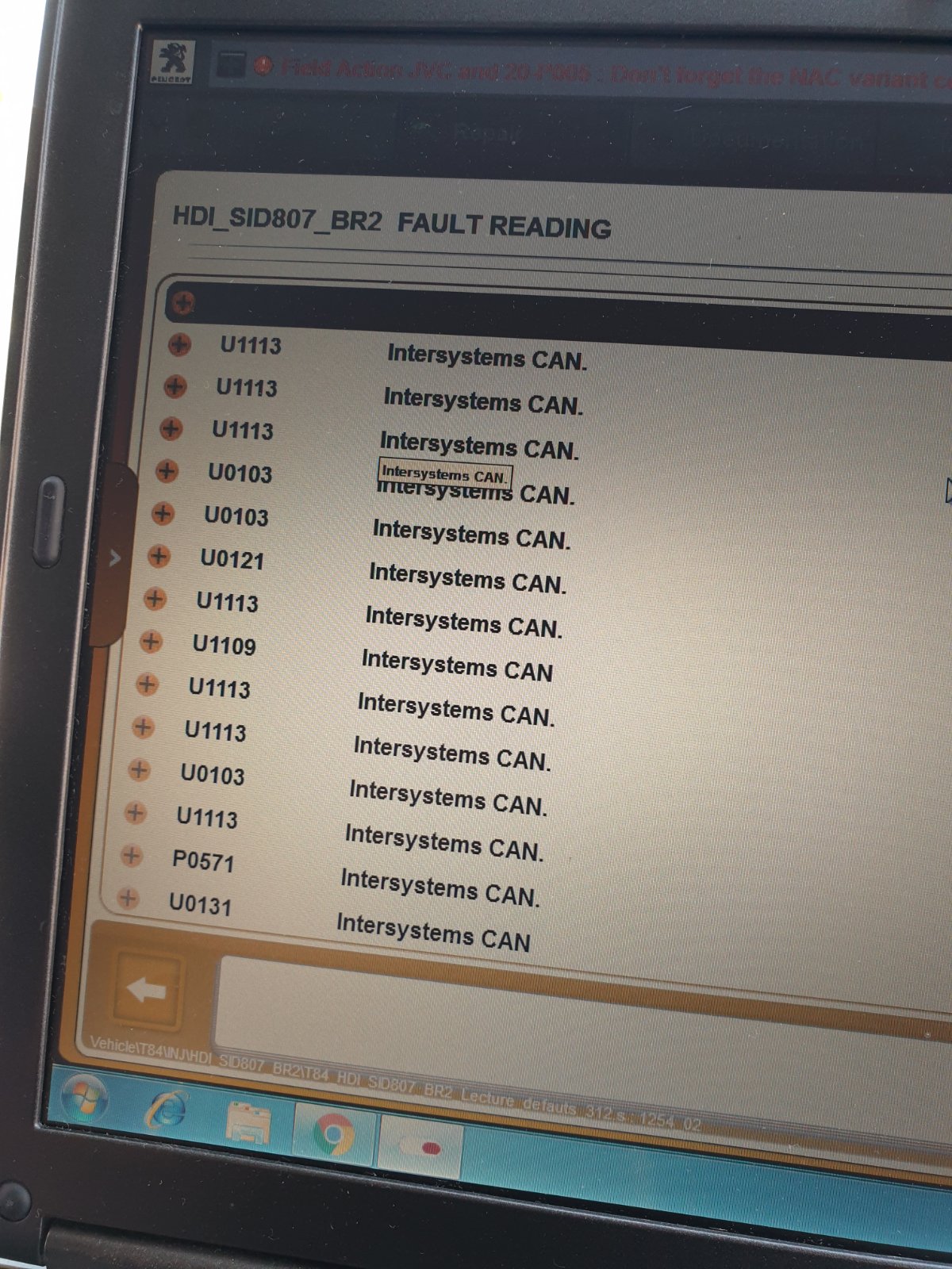

Well. Park brake now working.
BSI shows no faults .
ECU shows a string of faults I cant seem to be able to erase.

Re: No Start After Battery Change
Sorted that now! It was a memory issue!
Hi Gary
Sorry, I've been sorting some jobs out and cleaning cars in this nice weather, so have missed your updates until now.
Glad you have everything back up and running - sometimes things just need to reset themselves - but it did look like you had a network communication / ECU error there with all those 'U' faults.
Keep an eye on things and see how you go and thanks for the donation too.
Small return to this.
I tried using the car to jump start my sons the other day. Just connecting to the +ve terminal caused the issue to reappear!
So I cleaned up all the battery terminal and the bars that come off it, did a battery reset and all was good.
I was surprised to find when I plugged diagbox in to clear the engine light it told me I have a bulb out. Don't these give warnings on the dash? I've never had one.
