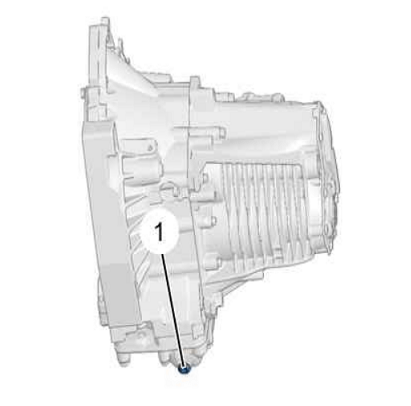

I can count (Steve Walsh wrote: 20 Apr 2020, 14:23 Confused on the ''does it have cooling fins'' for the correct amount to put in, Mine only has fins on the bottom as per the pic

Does anyone have pictures of old style and new style ML6C, Mine only has the cooling fins on the bottom and I am unsure how much oil to put in...

Steve, yours should be with fins so refer to the guide in my procedure on the previous page:
With Fins:Quantity of oil to fill after draining
Gearbox casing with fins: 1.9 Litres
Gearbox casing without fins 2.6 Litres
Quantity of oil to fill after an overhaul
Gearbox casing with fins: 2.2 Litres
Gearbox casing without fins 2.9 Litres

It was just the fact it only had fins on the bottom, I have refilled with 1.9 litres of Total 75w80 GL4.

Nobody has come up with a photograph of gearbox without fins yet. Must admit I'm curious what the difference is.

I have searched the web but can't find a pic of an earlier version.
When I drained the dirty oil out I recovered 1.55 Litres in a container and I don't think there could have been more than half a litre on my workshop floor, I had a half pipe under the drain plug but the speed it came out overwhelmed it. But glad I have changed it...

It is my understanding that apart from the obvious effect of natural cooling, they are always looking for ways to make the cars lighter to meet stricter emissions and Euro standards. Fins on a gearbox can also be used to reinforce the structure - rather than making the gearbox casing thicker, so that can save some weight.
As an example, the ninth letter or digit in your VIN will tell you the type of gearbox you have and its specific Euro standard / Emission level. In the case of the C5 family there are 13 gearbox designations. There is a 6 speed manual gearbox that is Euro 3 certified and another 6 speed manual that is Euro 4 certified and another that is Euro 5 certified. Just a few examples, so making a few tweaks / design changes make a big difference to certification.
