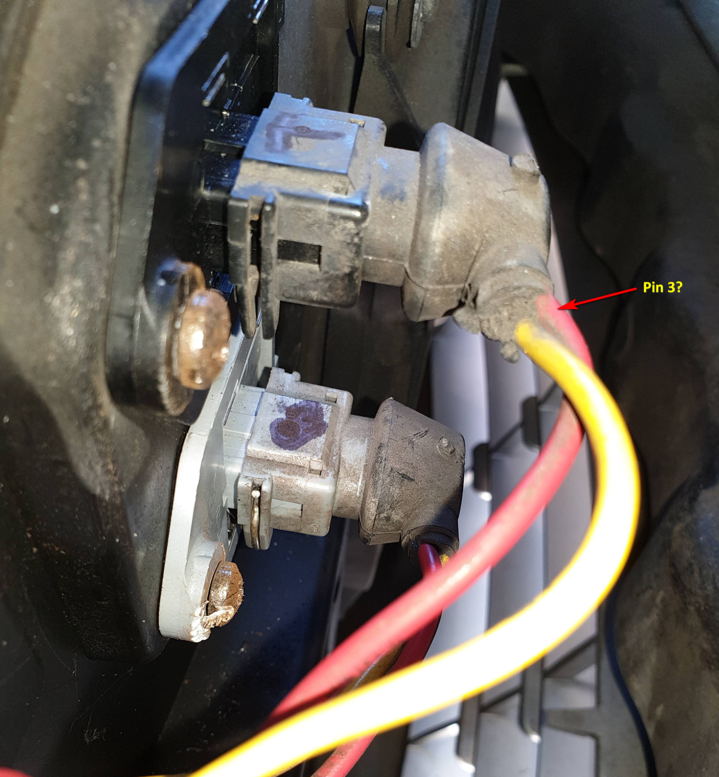

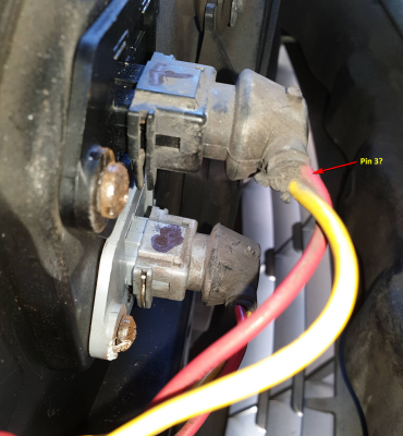

Can you tell me if PIN 3 is the red wire as shown in the photo, or is it the one attached to the fan power lead?
Pin 3 ?
Pin 3 ?
Citroen Xsara Picasso 1.8SX 2003
wheeler
Posts: 7927
Joined: 21 Sep 2002, 19:07
x 1056
Re: Radiator Fan NOT Working Xsara Picasso 1.8sx 2003
Unread post by wheeler »
If you disconnect the plug the pin numbers will definitely be on the plug somewhere. They may be very small & on the inner part of the plug.

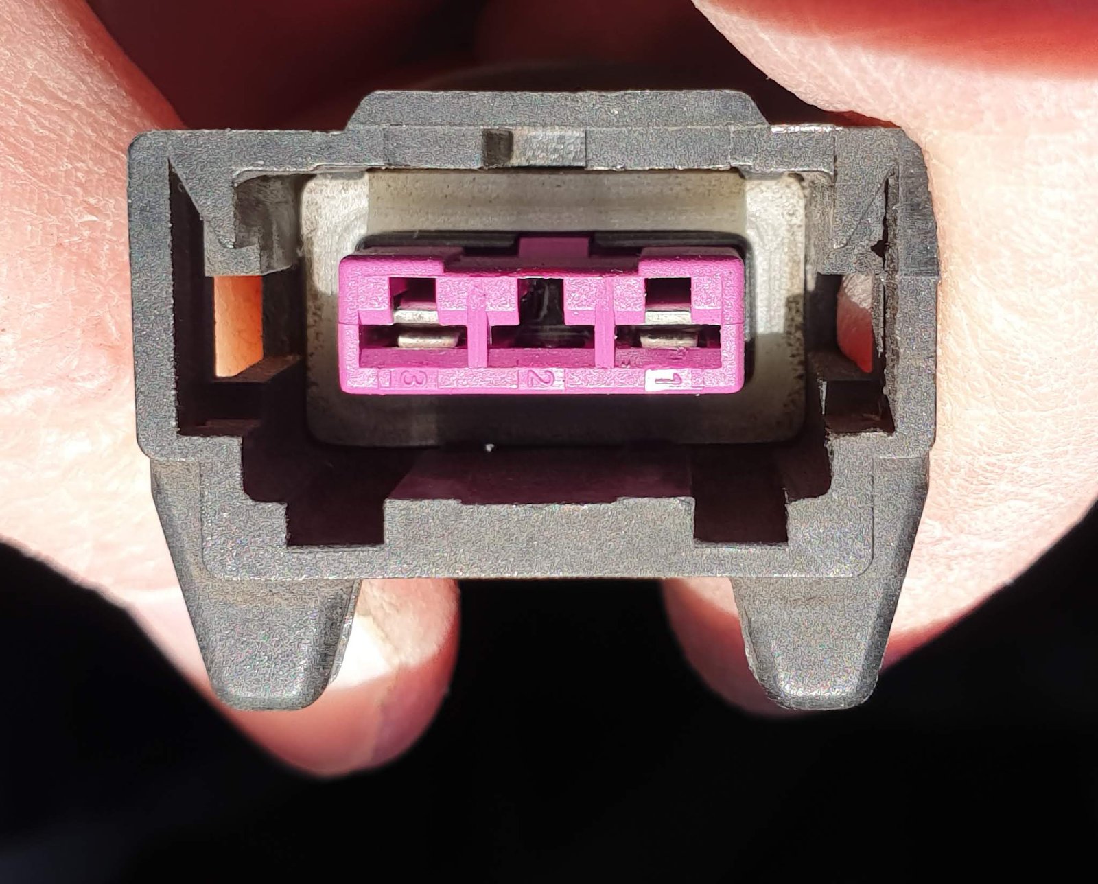

That didnt work either. I conected a wire from the positive terninal in the engine bay to number 3 on the plug with the ignition off. A small initial spark on the terminal then nothing and no response from the fan. The same when I tried again a minute later with the ignition on (engine not running). I also checked the two fuses on my multitester and they are OK. So does this mean the fan is faulty or could there be someting else like the relays which I have not tested.

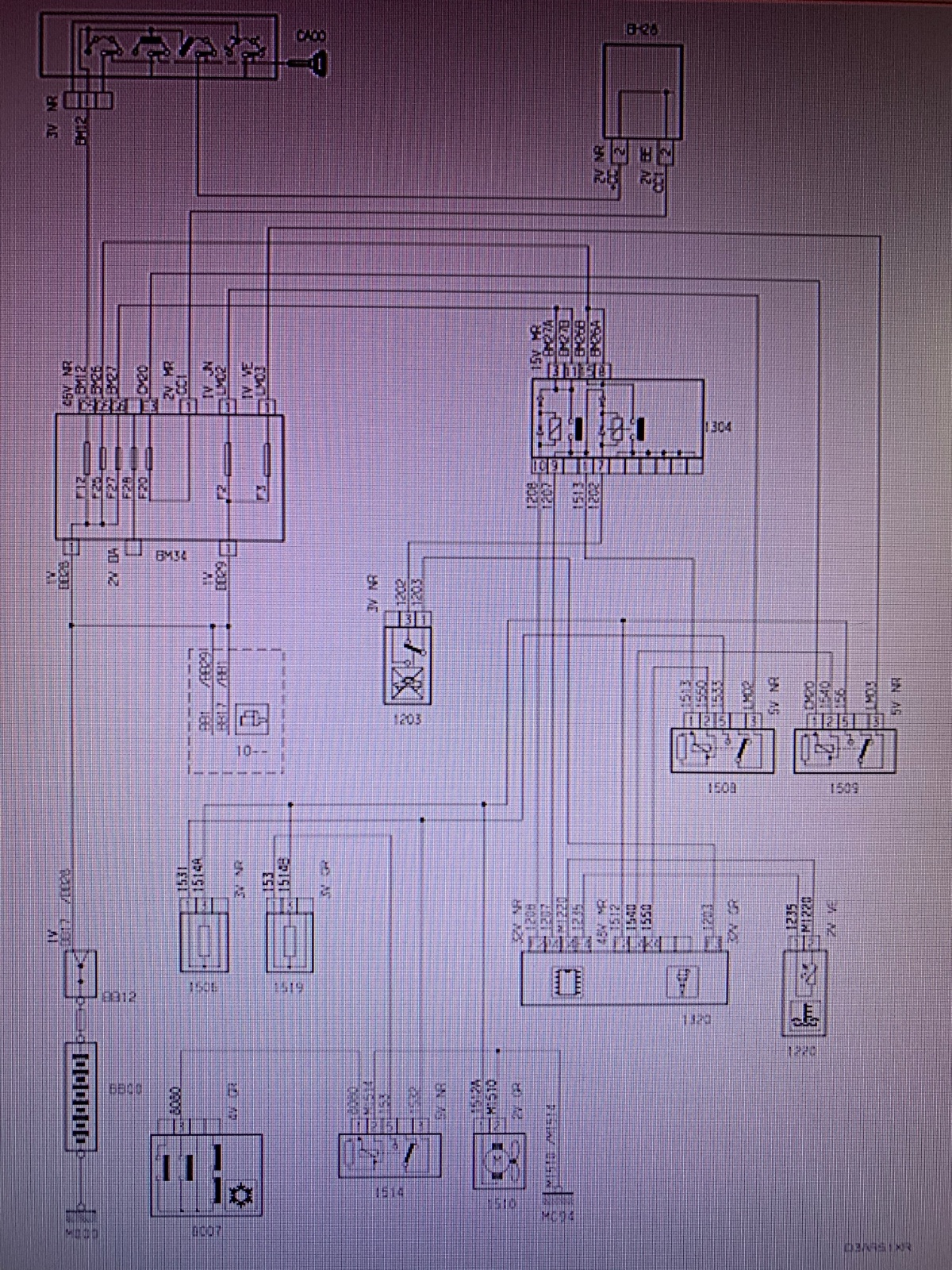

Powering up pin 3 of one of the resistors should power up the fan unless there is a wiring fault between the plug & the motor or the fan motor is missing its earth.
Sorry its not a better picture, i dont know how to upload a wiring diagram to the forum.

That circuit shot, although difficult to tead, confirms the set-up is one fan, 3 speed, controlled by a triple-output WTCU and temp sensor, with two dropper resistances.
Like the twin-fan triple-relay version, it is essential that motor and all three relays are switching correctly.

I have changed the pic of the diagram so its a bit better.
Yes its a 3 speed single fan setup.
Low & high speed is controlled by the injection ECU & mid speed is controlled by the A/C system.
Yes its critical that the 3 relays are switching correctly & the resistors are good but for the time being I would ignore them until we confirm that the fan motor is good.
As the fan motor is not operating when power is applied to pin 3 of one of the resistors when both disconnected I would concentrate on the circuit downstream of the resistors.
One other thing to be aware of just to add confusion is that on pin 3 of the black resistor plug the wire is RED but on the grey resistor plug pin 3 is the YELLOW wire
P.S. what is WTCU ? i've never herd this term before.
