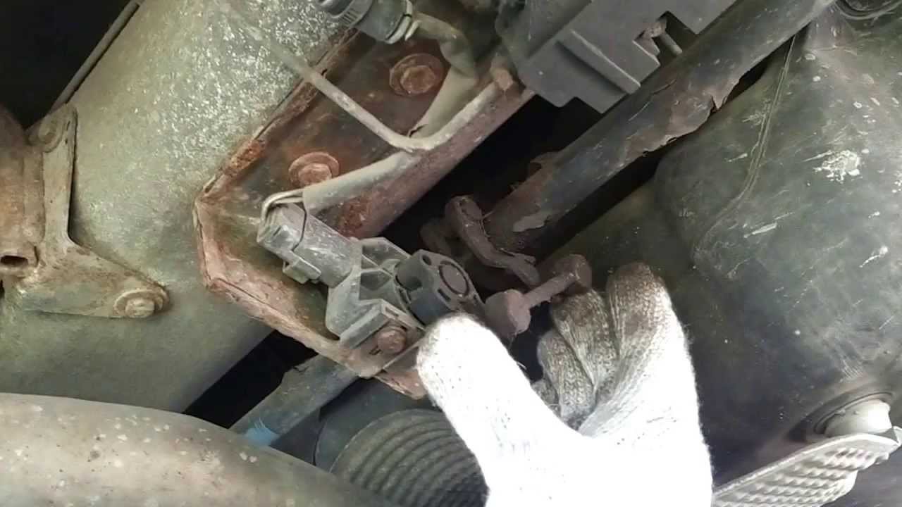

To be honest i'm not even sure if this is the sensor or the bracket

The part spanned by your fingers and thumb is the 'dogbone' link. It is connected to the bracket where your fingers are, the bracket is attached to the anti-roll bar. The 'dogbone' is also connected to the sensor, where your thumb is. The sensor is the part with the wires attached.
I had to have a new bracket on my Xantia. £17!

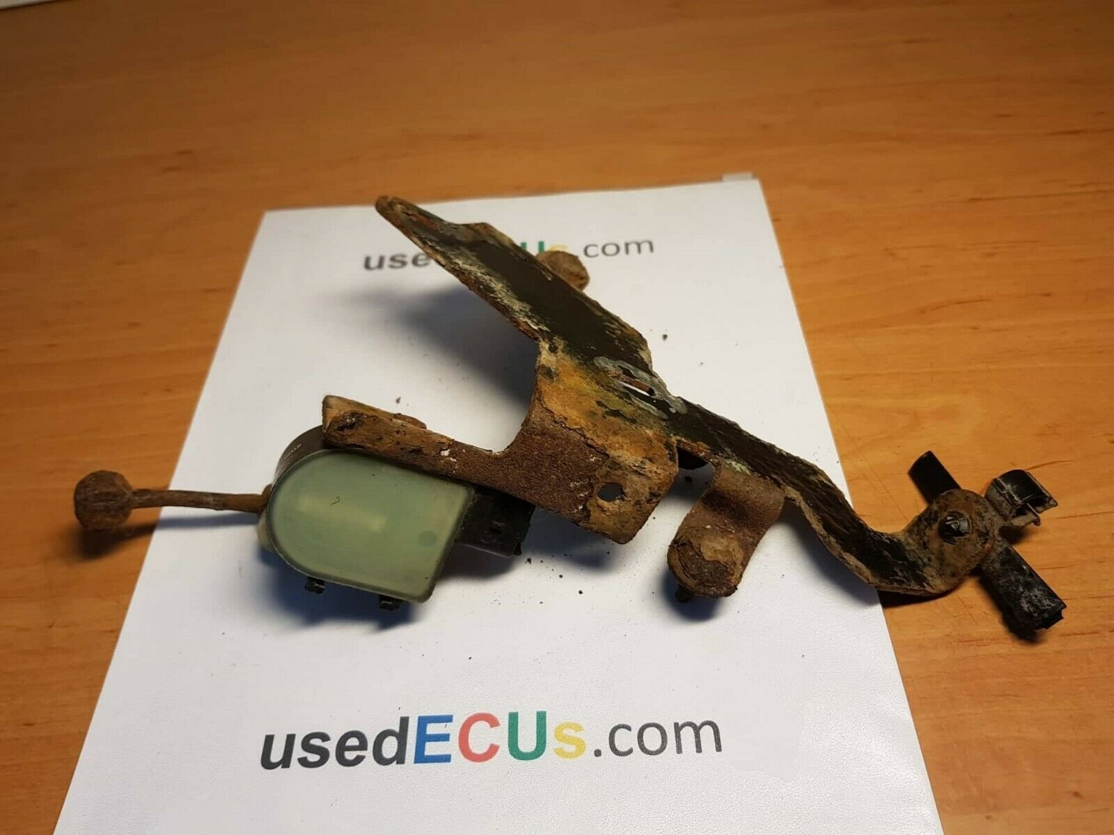

Just had a quick look on ebay. Is this the bracket that they are on about?
