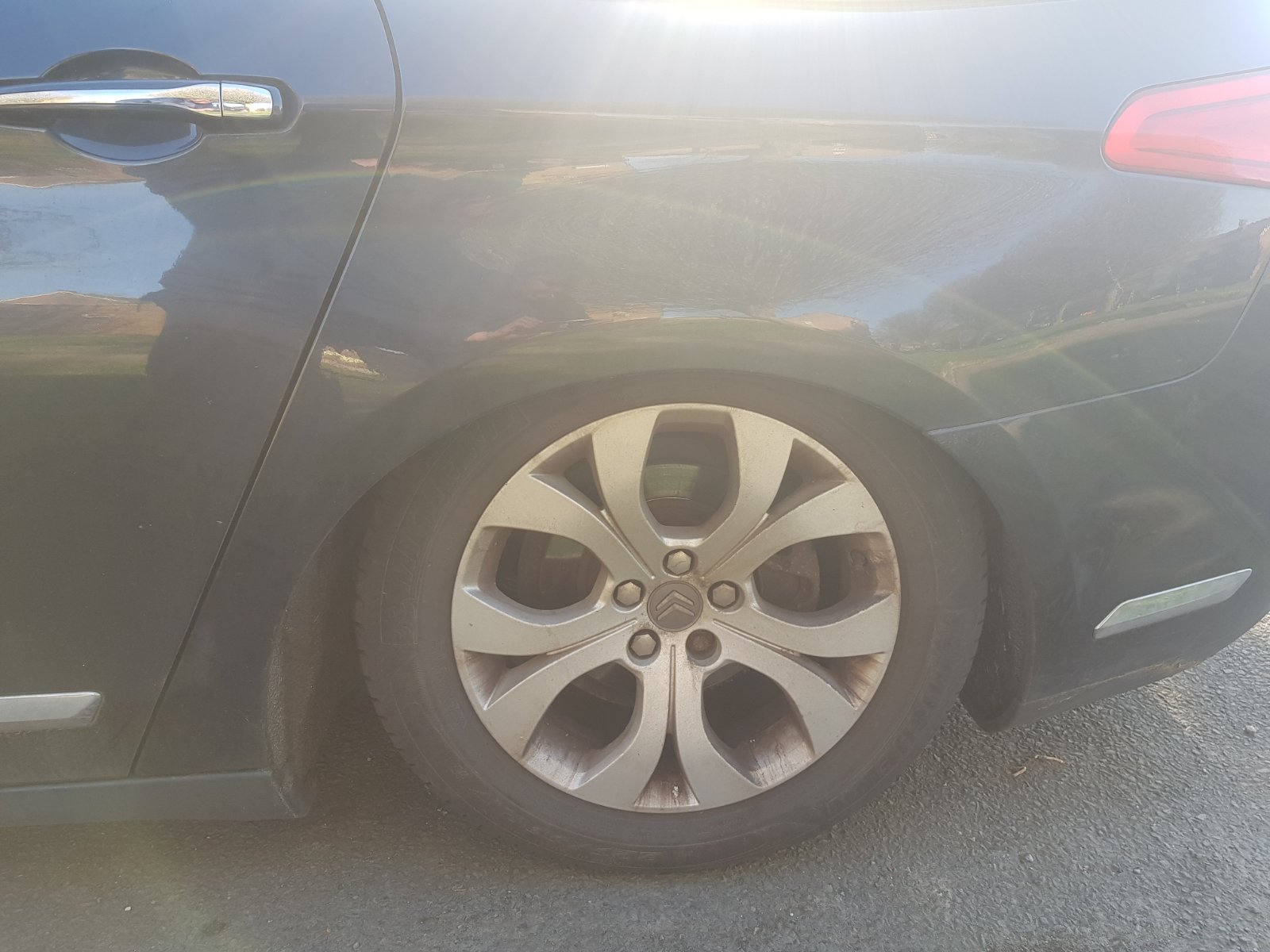

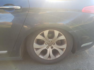

My 2009 C5 estate has for a while been riding a bit high on the front. The other day the car started bouncing and when I parked the back end had collapsed. It still rises up when I use the button in the boot but as soon as I turn the car off it sinks again. The level control still raises up the front but the rear stays really low. I can hear the motor working when I raise and lower.

A £20 Euro Crap Parts code reader is unlikely to read the suspension system.
It may even be a mechanical fault like an internal or external leak. Any signs of fluid loss? How long does it take to sink after it is turned off?

Yeah I wasn't relying too much on the code reader. Probably give the same no fault reading if the car was sitting there in flames.
Don't seem to be any signs of leaks. Probably around 4 or 5 secs to sink after turn off.

Re: C5 rear suspension fail
I suspect a leaking electro-valve allowing fluid to return to the reservoir when the engine is off.
A diagnostic may confirm. Could be a bit of debris stuck in it if someone has been careless while working on the suspension system.

What I mean is, after the engine is turned off it starts to sink immediately, but gradual 4 secs to reach the floor

Yep, faster than I would have expected but symptomatic of a leaking electrovalve. These are used to bleed fluid from the rams in order to maintain the ride height but if stuck open will allow it to drop to it's lowest position.
Try performing an extended set or Citroebics to try and clear it.
