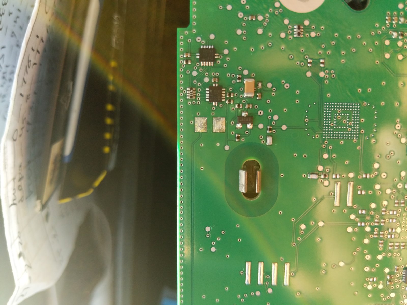

I can see 2 solder points under the RT6.

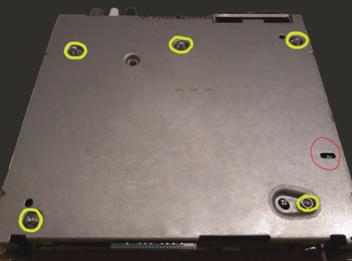

Re: Peugeot 3008 Hybrid RT6 not booting.
I think on the RT6, the microswitches are here, circled in red:

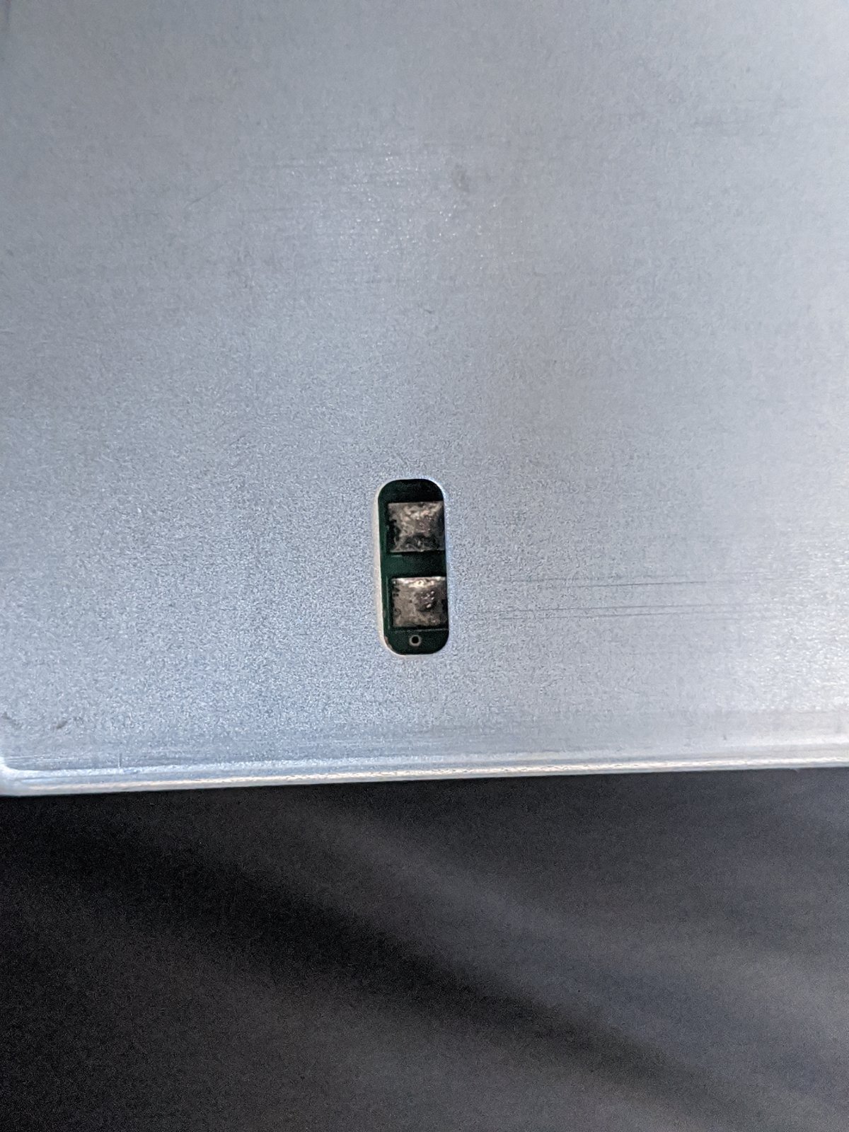

Unread post by AlamSAsif »
Hi Marc. there are 2 solder points in this place. No Micro switch.
x 6963
As far as I know these should be switches - very small and barely noticeable - but when pressed with the boot CD in and the vehicle connected, it should start the bootloader mode.

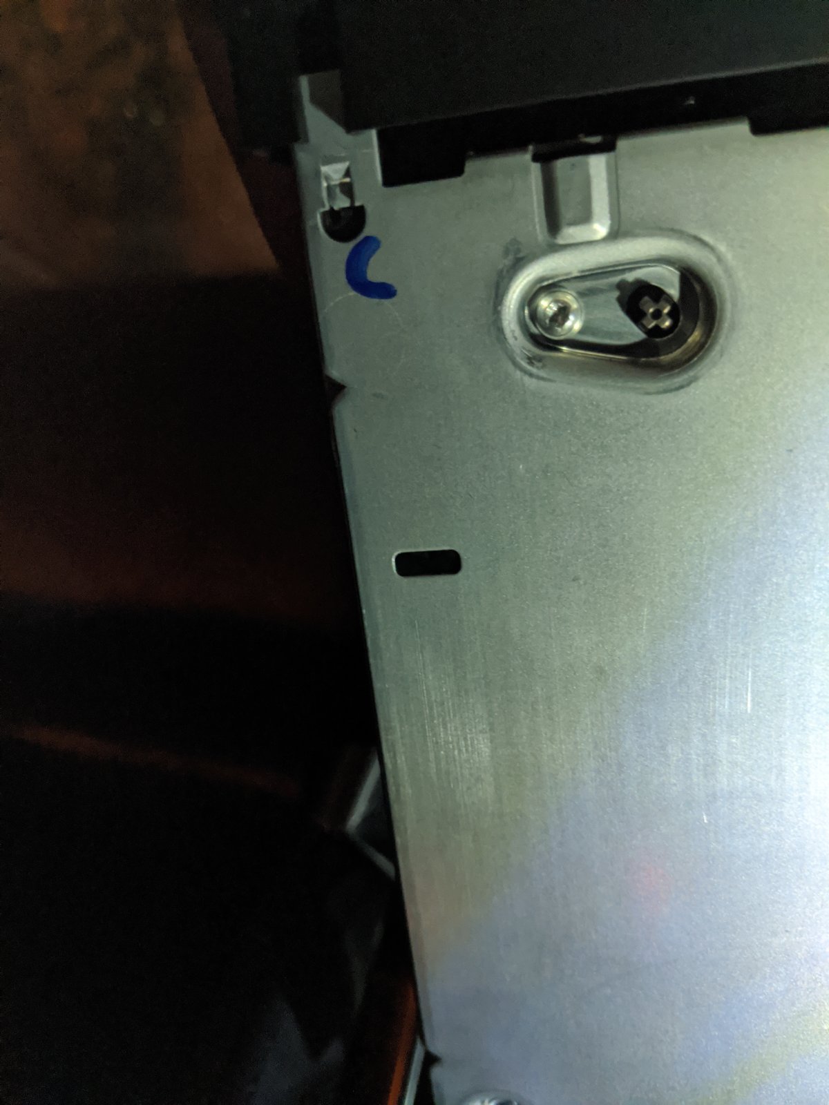

Please see the picture. May be it's the model difference. Thanks
x 6963
Possibly - I'm wondering whether these are accessible internally from the opposite side of the circuit board? I don't have this unit personally, so can't check myself. Just be careful when disconnecting the leads if you want to check, Take off quad lock first before any other cables as that is the power, and reconnect last. Also mind the ribbon cable internally when you take the case off.

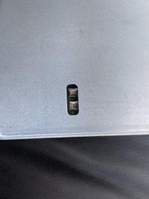

These points are just under the SD card reader. I am unable too see the micro Switches on circuit board.

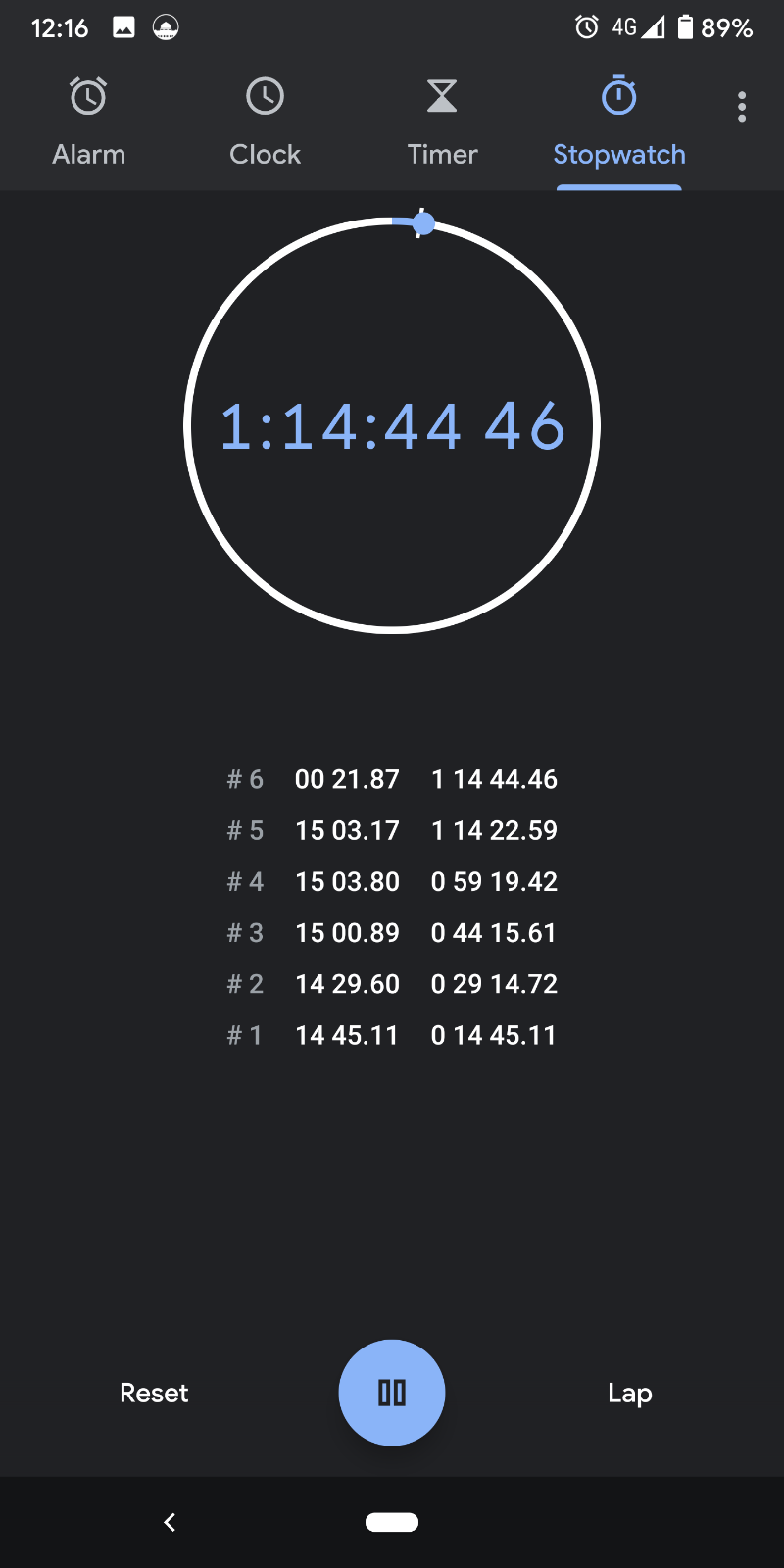

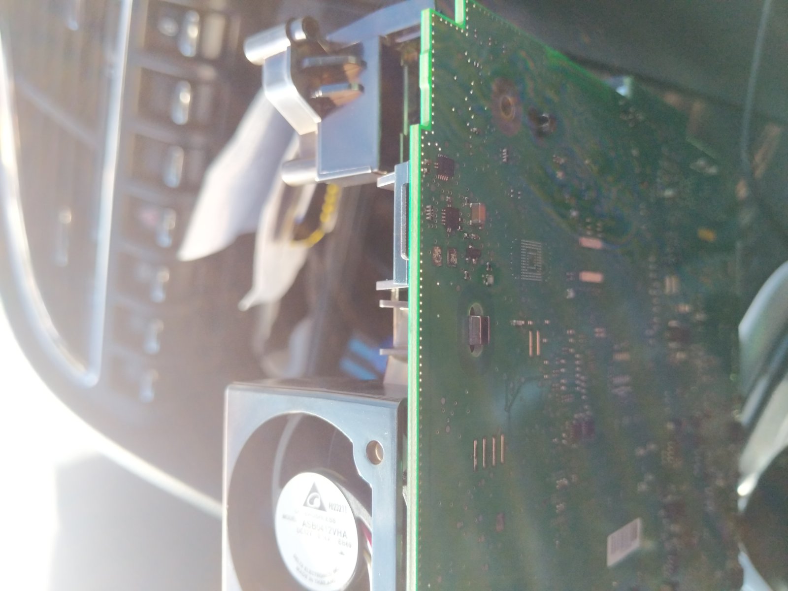

Hi.
After more than hour waiting and 6 times reboot still nothing works. I also check the SD card and there is no partition created, I think the update is not working at all. Please see picture. RT6 reboots 6 times. I was thinking to update through USB but the CD is stuck in the RT6 and eject didn't work. It start spinning again after every reboot. Don't know what to do next.
Thanks

Ok, so there are 2 versions of the RT6 - one with Micro switches and one with the solder joints like you have. The system is trying to boot and is getting stuck in a cycle. If you have the new firmware CD inside the unit, then shunt the 2 solder points to start Bootloader mode and then while shunted, plug the power connector in.
With a bit of luck that may start the process - but no guarantees.

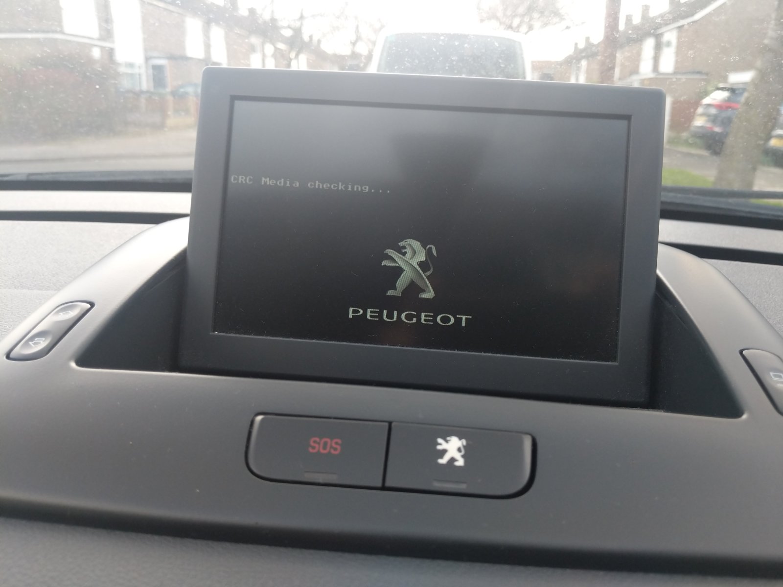

I tried it Marc but still stuck in same cycle. I manage to eject the cd and create a usb for firmware 2.77 and when I restart RT6 and after few seconds the display turn on and showing CRC Media Checking.... With the Peugeot logo in center. Let see what happens.
I was checking the files in the old SD card and in couple of files the firmware was 2.70. So I thought why not start with 2.77 and then if all works then gradually upgrade to next up.
