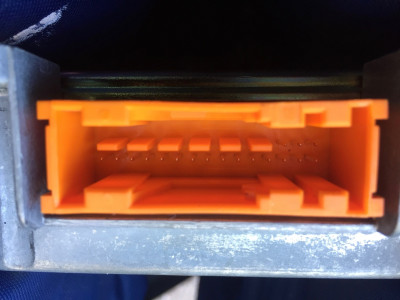

For my tired old phase 1 Xantia...
Finally the replacement airbag ECU has arrived. It has the same part numbers. The Citroen dealer is sure after the first diagnosis that the ECU is faulty.
After fitting, the light remains on. That leaves one or both possibilities that:
a) Replacement unit is non functioning (faulty or perhaps has been in a crash as the part is of necessity from a breakers), or
b) The unit was calibrated for a passenger airbag. My old Xantia only has the driver airbag.
I am reluctant to keep going backwards and forwards to the Citroen dealer for a diagnostic test each time.
Below is a photo of the ECU connector with the cables. It looks to me like there is no cabling for a passenger airbag. So, if I can place a 2.2 ohm resistor where the ECU expects the passenger airbag to be, I can fool it into thinking that there is one.
If the light goes out, the issue is sorted! If not, It would confirm to me that the replacement ECU is also faulty. I can then spend a small fortune on another.
Can anybody confirm which connectors are for the passenger airbag? The connector as shown is numbered from top to bottom 1(large green) - 15 (large red). I believe pins 3,4,5 & 6 are for seatbelt, pins 11 & 12 for drivers airbag, 14 to the seat pretension ECu's and 15 to power from ignition switch.
Mine is a french LHD - if that makes a difference?
Am I right?
Would I be right to think that, as I saw in a diagram somewhere, 9 & 10 is where the passenger airbag would normally go?
Also attached a photo of the connector on the ECU with, I believe pins numbered from 1 - 18 anti-clockwisestartingk from the left.
Am I right?

I have been told over at Planete Citroen that Citroen cannot determine ECU faults with their diagnostics. Is this true?
Another has advised me to carry out continuity/resistance tests on the airbag and seatbelt pre tensioner circuits. I know that I can substitute the steering wheel airbag with a resister to avoid blowing up the airbag. Is this really likely to happen? Are there any issues with using a multimeter to test the pretension ear circuits?
Sorry for the barrage...

Re: Airbag light: Part no for Xantia for steering column slip ring
I will test the circuits ay substitution resistors so as not to risk blowing the airbags or pretensions...
I believe that 2.2 ohms is the value for the driver airbag and seat pretensions - is that correct? I don't want to risk setting the pyro stuff off with my multimeter!
Help!
Help!
- x 6962
There are certain tests that can be performed using additional adaptors and harnesses on some vehicles, depending on what tests are required. But Lexia cannot tell you what is wrong with an ECU internally - only whether it is operating or not.vmaxvmax wrote: 26 Feb 2020, 21:27 I have been told over at Planete Citroen that Citroen cannot determine ECU faults with their diagnostics. Is this true?
- x 6962
I would be very careful - Citroen do not recommend using a multimeter to test airbag circuits:vmaxvmax wrote: 27 Feb 2020, 08:27 I will test the circuits ay substitution resistors so as not to risk blowing the airbags or pretensions...
Help!
- Never connect electrical harnesses to a pyrotechnic component other than those provided by the manufacturer.
- Never use an ohmmeter or any other source of electrical current, on the pyrotechnic device (risk of deployment).
Switch on the ignition
- Check the operation of the airbag warning lamp in the dashboard (the airbag warning lamp lights up, then goes out)
- Remove the ignition key
- Disconnect the battery negative terminal
- Wait for at least 2 minutes (wait 10 minutes in case of abnormal operation of the airbag warning lamp)
