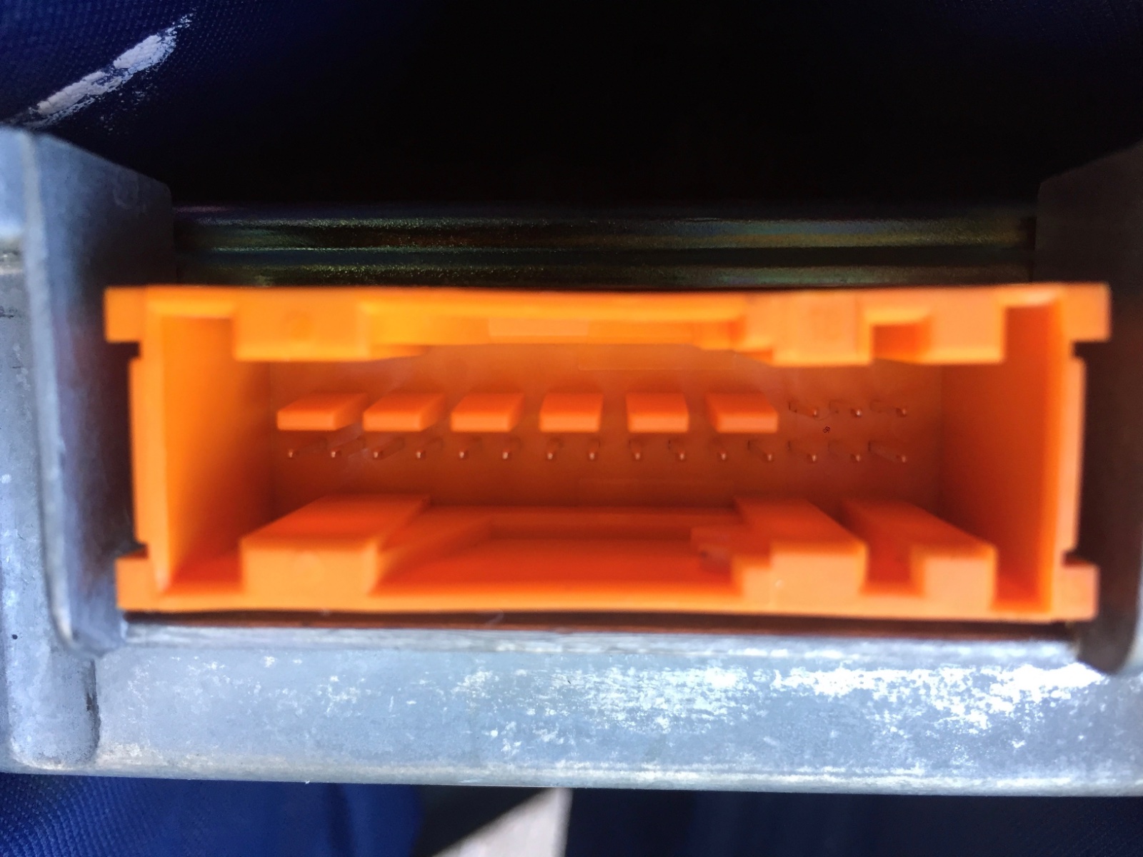

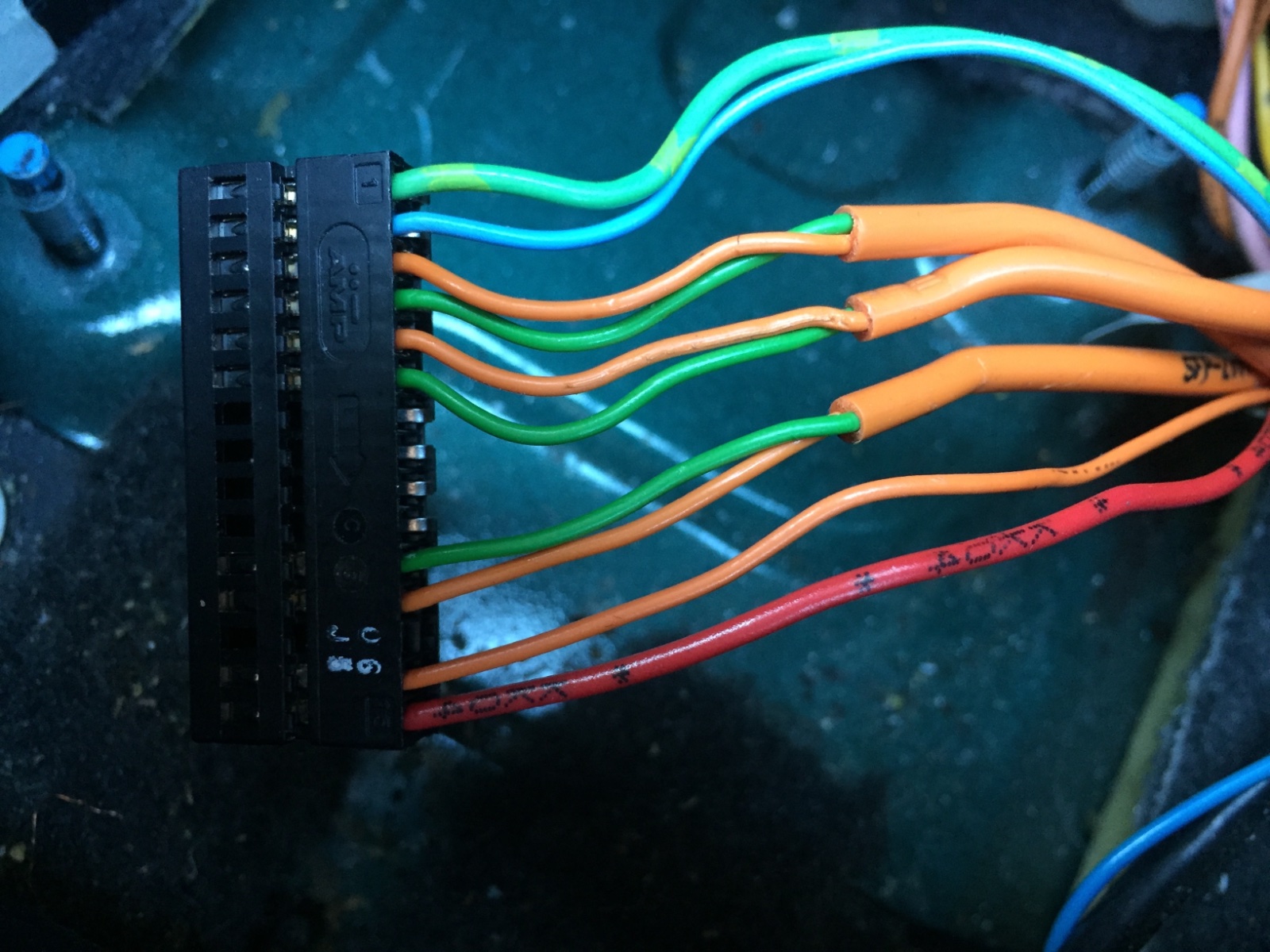

For my tired old phase 1 Xantia...
Finally the replacement airbag ECU has arrived. It has the same part numbers. The Citroen dealer is sure after the first diagnosis that the ECU is faulty.
After fitting, the light remains on. That leaves one or both possibilities that:
a) Replacement unit is non functioning (faulty or perhaps has been in a crash as the part is of necessity from a breakers), or
b) The unit was calibrated for a passenger airbag. My old Xantia only has the driver airbag.
I am reluctant to keep going backwards and forwards to the Citroen dealer for a diagnostic test each time.
Below is a photo of the ECU connector with the cables. It looks to me like there is no cabling for a passenger airbag. So, if I can place a 2.2 ohm resistor where the ECU expects the passenger airbag to be, I can fool it into thinking that there is one.
If the light goes out, the issue is sorted! If not, It would confirm to me that the replacement ECU is also faulty. I can then spend a small fortune on another.
Can anybody confirm which connectors are for the passenger airbag? The connector as shown is numbered from top to bottom 1(large green) - 15 (large red). I believe pins 3,4,5 & 6 are for seatbelt, pins 11 & 12 for drivers airbag, 14 to the seat pretension ECu's and 15 to power from ignition switch.
Mine is a french LHD - if that makes a difference?
Am I right?
Would I be right to think that, as I saw in a diagram somewhere, 9 & 10 is where the passenger airbag would normally go?
Also attached a photo of the connector on the ECU with, I believe pins numbered from 1 - 18 anti-clockwisestartingk from the left.
Am I right?
