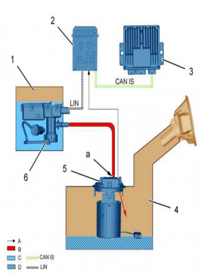

These are the components of your System and how it works:
Key:
"A" Electrical links
"B" Additive under pressure
"C" additive
"D" Diesel
ReferenceDesignation
"a"Additive injection valve
1Additive tank
2Built-in systems interface
3Engine ECU
4Fuel tank
5Fuel gauge
6Fuel additive pump
Role
The fuel additive function keeps the particle filter operational by aiding the combustion of the captured particles, performing the following actions:
  • Lowering the temperature of combustion of the particles to 450°C (instead of 550°C)
  • Impregnating the particles that are gathering in the combustion chamber
  • Spreading the combustion of the particles
Performance of the fuel additive function
The engine ECU receives the info on fuel quantity put into the vehicle via the BSI, using:
  • Fuel gauge
  • Wheel speed sensors
Depending fuel quantity added, the engine ECU takes the following actions:
  • Determines the quantity of additive to be injected into the fuel tank
  • Controls the fuel additive pump
The engine ECU sends a request for additive to be injected in one or more volumes of 1265 mm³, to the fuel additive pump, via the BSI.
The engine ECU records in memory the weight of additive that is accumulated in the particle filter.
Note: The additive fluid is Cerine-based. Cerine is non-organic and cannot be burnt off in the filter. It is this element that gradually leads to the particle filter needing replacing or deep cleaned.
If the filter has already reached the stage where regeneration is ineffective or not occurring, then it will also lead to soot clogging, requiring cleaning.
The engine ECU authorises or prohibits the applying of additive, as a function of the following parameters:
  • State of the additive pump
  • Level of additive remaining
  • State of clogging of the particle filter
  • Fuel gauge state
Note: The engine ECU sends an alert on the risk of clogging of the particle filter and on the level of additive being insufficient, as a function of the quantity of additive injected and of the weight of additive accumulated in the particle filter.
The BSI receives the following information from the engine ECU :
  • Minimum fuel additive level warning
  • Risk of particle filter clogging
The BSI sends the following information from the engine ECU:
  • Fuel gauge state
Conditions for use of the fuel additive function
The engine controlled ECU controls the fuel additive pump when the following conditions met:
  • Vehicle speed above 40 km/h or last fuel addition over 300 seconds
  • Internal combustion engine running
  • Starter switch in the ignition positive position
  • Adequate additive level
Note: When one of the necessary parameters disappears during the additive injection, the operation continues until the end.

Thanks, I was expecting to see something about a sensor on the fuel cap.
Maybe not all models have one, I've not looked to see if mine does or not.
Mike
x 6948
Re: Resetting Eolys counter with diagbox
I wouldn't get too hung up on this - if it was faulty, Diagbox would throw an error up anyway.
It is not essential - it only is used to help the engine ECU determine if fuel MAY have been input - not that it has. Vehicles with a fuel filler detection flap may just inform the BSI to do a full fuel check in case fuel has been added or not. Again, the fuel tank measurements is not always measured from the sender - it is estimated from quantity last measured, distance travelled and every so often takes a real measurement and adjusts - so the fuel flap sensor (where fitted) just tells the BSI to do a full check.
from what I can see you don't have one fitted anyway.
