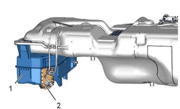

(1) is the Additive Tank
(2) is the Additive -adding pump
The fuel is measured before and after he engine is stopped and in some cases a fuel filler plug detect harness may be fitted to help determine if any fuel might of been added. But the calculations are done by the engine ECU and the quantity f additive is estimated.
The wiring is the metering device.
You have 2 issues going on. The DPF is getting clogged due to a lack of additive fluid OR the ECU has stopped regeneration taking place because it THINKS the fluid is too low.
So regardless of quantity of fluid if you don’t reset it properly regeneration will cease (backup mode) warnings will come on and filter will soon get clogged. Don’t continue driving it if possible as if the clogging gets anywhere from 75% or more it may never be able to regenerate and will have to be deep cleaned.
Again, it would help if you could post some screenshots of the screen menus and options as the reset should be to zero according to data I have.

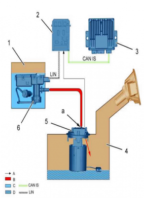

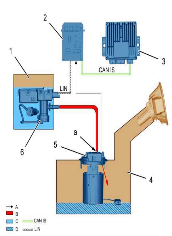

Re: Resetting Eolys counter with diagbox
These are the components of your System and how it works:
Key:
"A" Electrical links
"B" Additive under pressure
"C" additive
"D" Diesel
Role
The fuel additive function keeps the particle filter operational by aiding the combustion of the captured particles, performing the following actions:
The engine ECU receives the info on fuel quantity put into the vehicle via the BSI, using:
The engine ECU records in memory the weight of additive that is accumulated in the particle filter.
Note: The additive fluid is Cerine-based. Cerine is non-organic and cannot be burnt off in the filter. It is this element that gradually leads to the particle filter needing replacing or deep cleaned.
If the filter has already reached the stage where regeneration is ineffective or not occurring, then it will also lead to soot clogging, requiring cleaning.
The engine ECU authorises or prohibits the applying of additive, as a function of the following parameters:
The BSI receives the following information from the engine ECU :
The engine controlled ECU controls the fuel additive pump when the following conditions met:
Key:
"C" additive
"D" Diesel
| Reference | Designation |
| "a" | Additive injection valve |
| 1 | Additive tank |
| 2 | Built-in systems interface |
| 3 | Engine ECU |
| 4 | Fuel tank |
| 5 | Fuel gauge |
| 6 | Fuel additive pump |
- Lowering the temperature of combustion of the particles to 450°C (instead of 550°C)
- Impregnating the particles that are gathering in the combustion chamber
- Spreading the combustion of the particles
- Fuel gauge
- Wheel speed sensors
- Determines the quantity of additive to be injected into the fuel tank
- Controls the fuel additive pump
- State of the additive pump
- Level of additive remaining
- State of clogging of the particle filter
- Fuel gauge state
- Minimum fuel additive level warning
- Risk of particle filter clogging
- Fuel gauge state
- Vehicle speed above 40 km/h or last fuel addition over 300 seconds
- Internal combustion engine running
- Starter switch in the ignition positive position
- Adequate additive level
