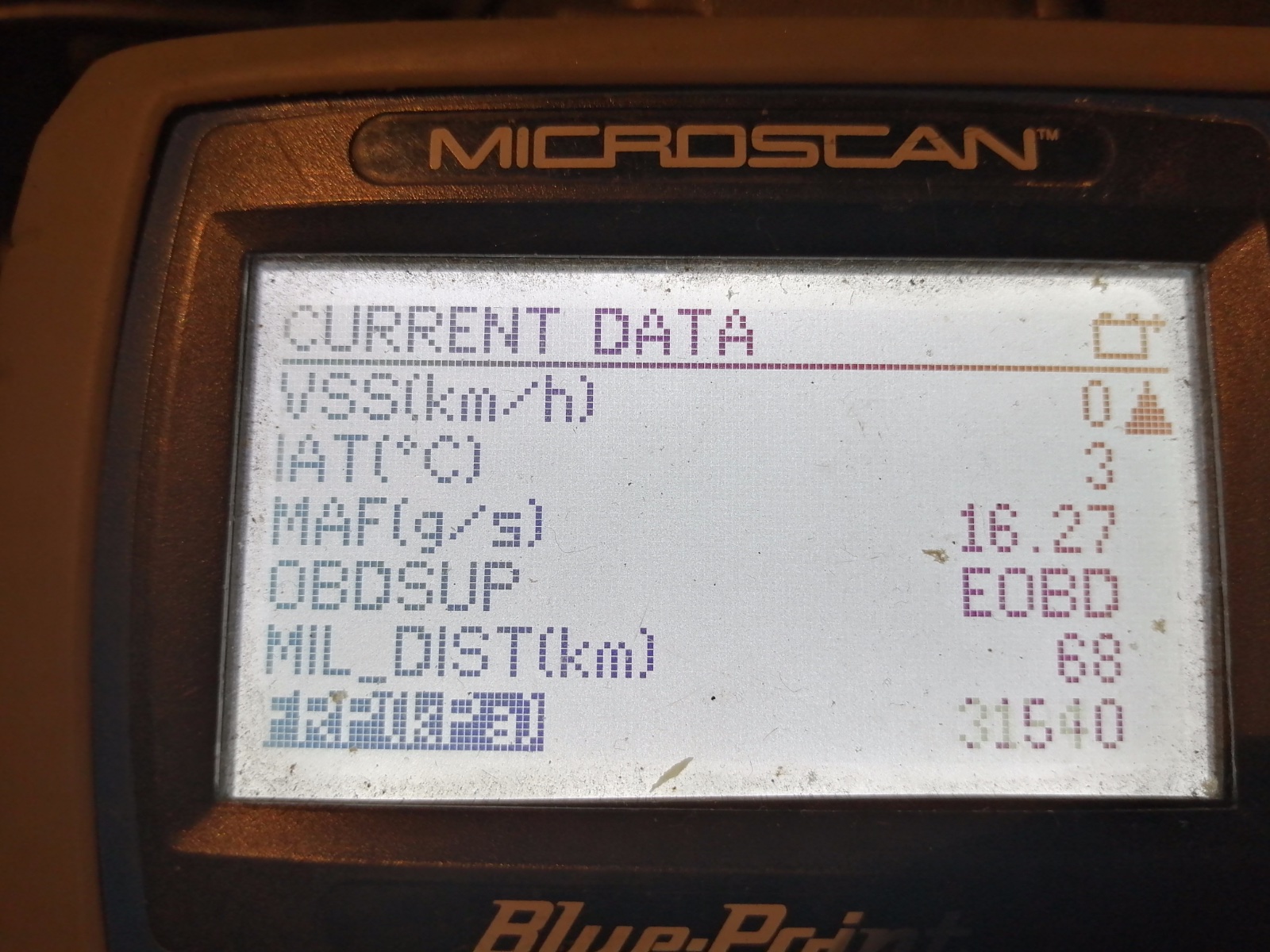

If you go into parameter measurement you should be able to see the engine speed. I think it needs to be at least 180 rpm to get a start, you also need the rail pressure to be above 200 bar or so, or it won't start the injection.

I recall it's the rail pressure not getting high enough with the slow cranking that's the issue. My Berlingo only just got the required rpm eventually but didn't get the pressure.

Any idea which is the rail pressure as I am not sure what's what when reading the data?
I am hoping the RPM has RPM as the units?

Have you got diagbox? In which case it should be under engine ecu and then standard parameter measurement; you are looking for a big number in bars. Aftermarket scanners it might be something else, e.g. FRP - and I'e seen one recently where it was quoted in kPa, so it was a really big number!!

I have a Blue Point Microscan
When cranking it reads zero RPM until it starts?
Would this bottom one be fuel pressure?

Yes that's Fuel Rail Pressure at the bottom. I also note you've had the EML on for 68km according to that tool, what faults are you getting? Could that be related to the starting perhaps?
Cranking RPM may not show on that tool but it is interesting to note... Perhaps you could try it on another similar vehicle & see if it registers cranking speeds there?
