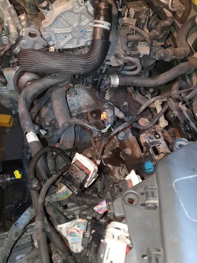

Ok, im mid way on this, going fairly well, one ballache was that one of the selector rod connectors seems to have popped or broken on removal :/ looks like i can secure it but may need to do something with that.
im struggling with something really REALLY dumb, where is the starter motor, i cannot see it for the life of me. Additionally trying to figure out which bolts attach the gearbox to the engine, itr really isnt all that obvious. any tips??

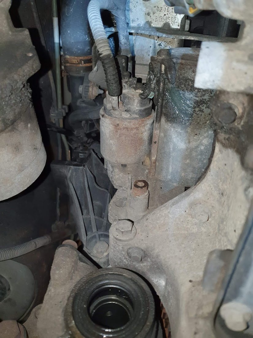

Re: Going to do my clutch C3 MK2 2011, tips?
this??

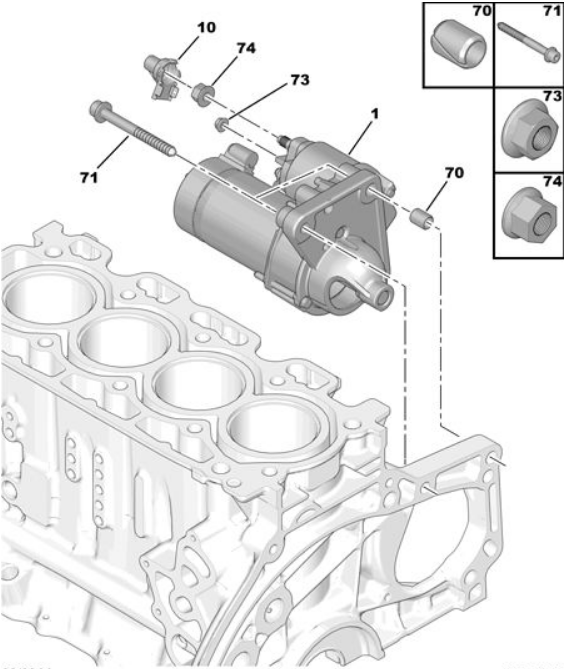

- x 6948
Here...
That's it in the pic. Getting to the top bolt is 'interesting' to say the least. Although it's not shown in Marc's diagram, there might be another bolt in from the other side, invisible under the stat housing.

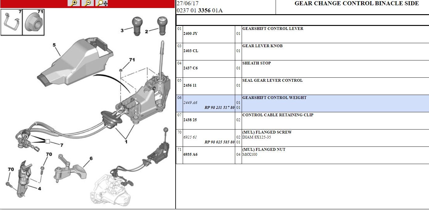

You might be able to glue that ball joint back together, but I rather suspect it's had it... unfortunately it only comes as a complete unit:
It's just a smidge under £250 from Citroen however.... scrapyard might be a possibility!

Yep starter was a ballache you def need a heck of a selection of tools as you only have about an inch of range to get a handle in. Not too bad tho once i got the wiring off.
Second annoyance was the top bolts on the gearbox, they are obstructed by a rather firm wiring harness that is itself bolted to the housing, once thats off however the top 2 bolts become accessible.
I didnt have to take off the exhaust downpipe as some had suggested, there was a nut and stud to be removed and then the gearbox bolt was accessible.
I did take off the cooling fan as it gave loads more room id strongly recommend this, although it did involve removing coolant pipes so i just drained the coolant system since it was on my long term to do list.
And as for that connector im gonna put everything back together and see if i can bodge a solution for now. Popping those off was a lot harder than had been suggested i prob should have bought some ball joint separators
