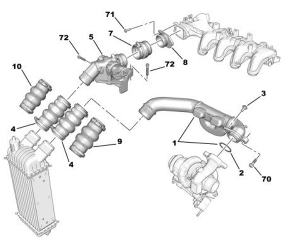

mine doesn't look like that.
- x 6957
Re: Smokey Dispatch Mk2
Yes, sorry about that - the one I put up is for a DV6 variant with a particle filter - which you don't have on a 2007 model. It was just an illustrative point as there were a lot of variants to this engine and they don't cover all the nuances.
This one is yours - a much cut down version.

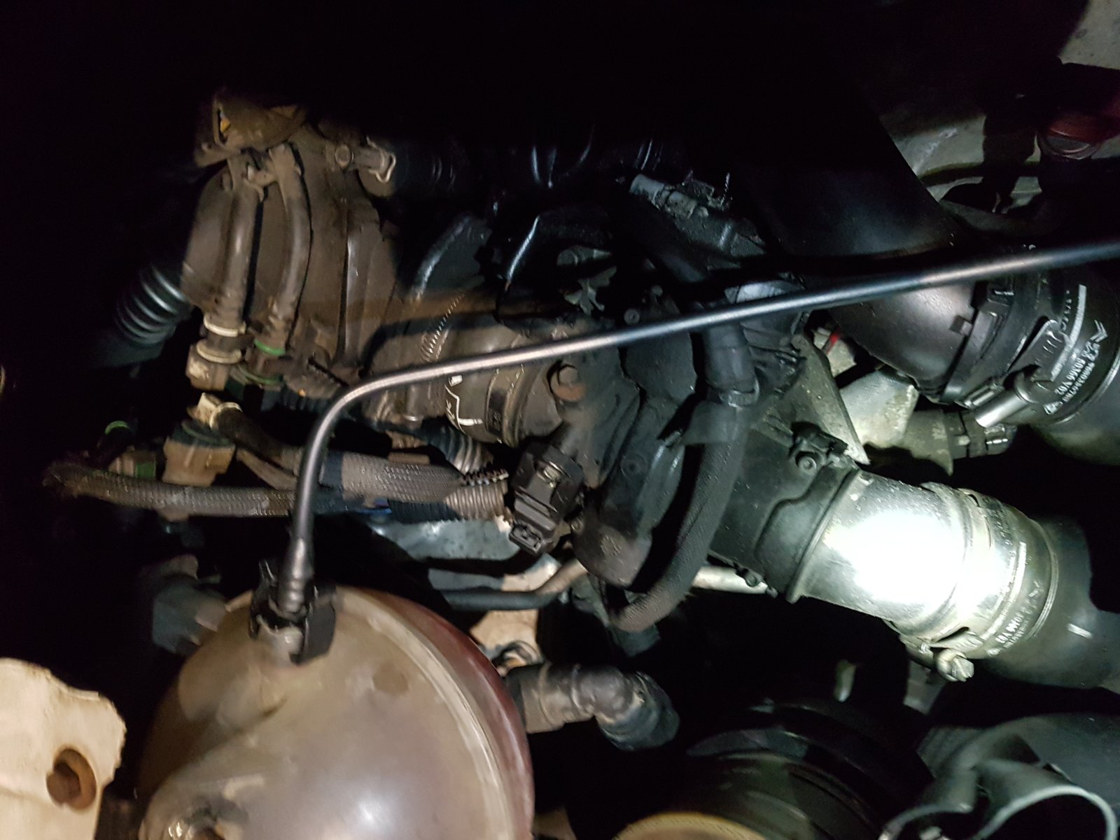

ah cool, do you have a close up of the body and a labeling of the sensors.
- x 6957
Not for this model - or I would of put that up initially for you... sorry.
just been out and recorded this.
as you can see, very little movement on the intake pressure.
https://photos.app.goo.gl/42uL2yiPan3q6TEA7
no, it was rising to 18psi while driving yesterday.
just been out and pulled the vacuum hose off the turbo and the arm is moving ok when reconnected
do those reading look ok? I was expecting the inlet pressure to drop more than that.
