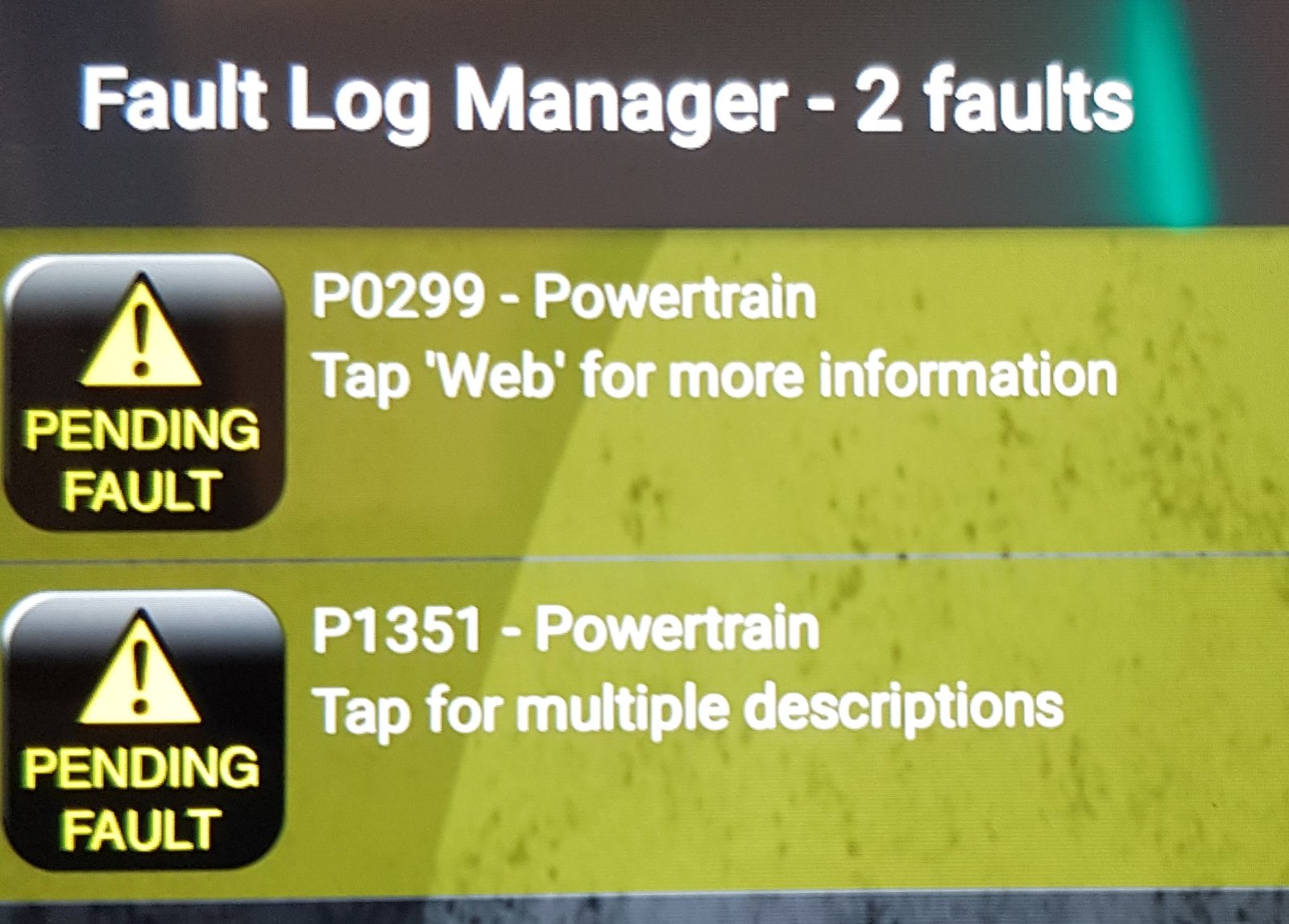

Yeah, all that is correct. Getting 2 fault codes, P0101 and another that i can't remember at the moment which appears to be related to glow plugs. I'll read it again tomorrow or may try and get it tonight if i can drag myself out again.

Picked up a used MAF sensor to try and it's giving the same reading as the original but after disconnecting the MAP sensor and Boost? sensor connections and giving a squirt of contact cleaner I still have black smoke but the P0101 code has gone to be replaced with "Pending P0299"
Now the van has plenty of power so hoping it's not the turbo. I did drive with torque pro reading out manifold pressure, boost and MAF
the manifold pressure didnt move much, how much variation if any should i be getting with this?

Thanks, hoping its just a sensor issue as it drives ok apart from the belching smoke when accelerating. once at constant speed its fine.

P0299: Turbocharger pressure signal: Pressure too low in relation to the reference value. Difference negative for 5 seconds, between the turbo pressure reference and the measured turbo pressure: The pressure measured is lower than the reference, around 300 mbars for an engine speed above 2500 rpm.
Triggering of Fault:
Downgrade Modes Whilst Fault is Active:
This fault is pretty common and I would focus on the other issue at present...
- In particle filter regeneration with engine speed above 1800 rpm
- Not in particle filter regeneration with engine speed under 1500 rpm
- Use of the flow calculated.
- Cutting of the EGR butterfly (turbo air cooler), EGR valve and bypass butterfly (inlet air heater) in all operating modes.
- Cutting of cruise control.
- Change to "easy move" torque invalid (Deactivation of automatic mode for the electronic parking brake).
- Lack of power
- Noise
- Smoke from the exhaust
- Air meter restricted
- Clogged air filter
- Obstacle obstructing the air passage
- Air lock between compressor and engine
- Turbocharging pressure sensor
- Turbocharger position copy sensor
- Vacuum problem
- Variable geometry of the turbocharger jammed in the "minimum turbo" position
- Faulty turbocharger

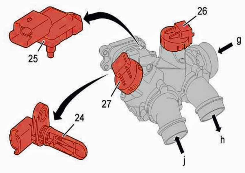

Yeah, not worried about the glow plugs, starting is spot on and not an issue. When driving the MAP was reading 14psi idle and up to 18psi driving, does that sound about right? i thought there would be more movement on that range.

That is something only a decent diagnostic will do like Lexia / Diagbox - that shows live data against reference values. I think PSA refer to this as the Inlet Air Pressure Sensor which is incorporated into the Butterfly Double Air Metering unit.

Would that be the 4 way body with 2 sensors in it coming from what i presume is the intercooler. might pop them out tomorrow and give them a clean.

Edit: This is not the correct doser for this engine variant - the DV6UTED4 has a single doser and is without DPF - I just put this up as an example to show where the Air pressure sensor is and if applicable the Air pressure temperature sensor.
| Reference | Designation |
| G | Turbocharged Air (Hot Air) |
| H | Output: Turbocharged Air to the Air/Air Heat Exchanger |
| J | Input: Turbocharged Air Cooled by the Air/Air Heat Exchanger |
| (24) | Inlet Air Temperature Sensor |
| (25) | Inlet Air Pressure Sensor |
| (26) | Inlet Air Heater Throttle (Hot Air Meter) |
| (27) | "EGR" Throttle (Cold Air Meter) |
