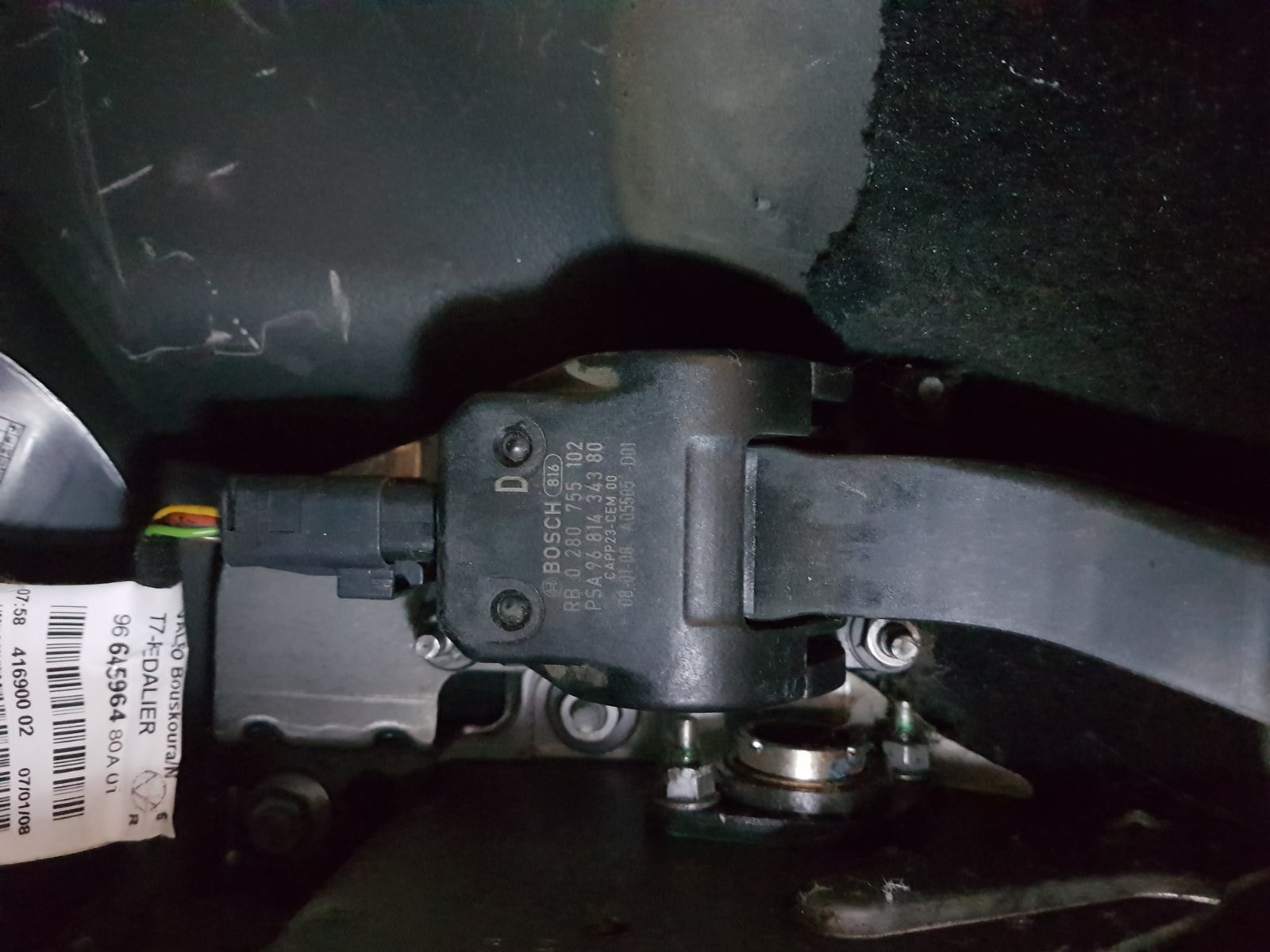

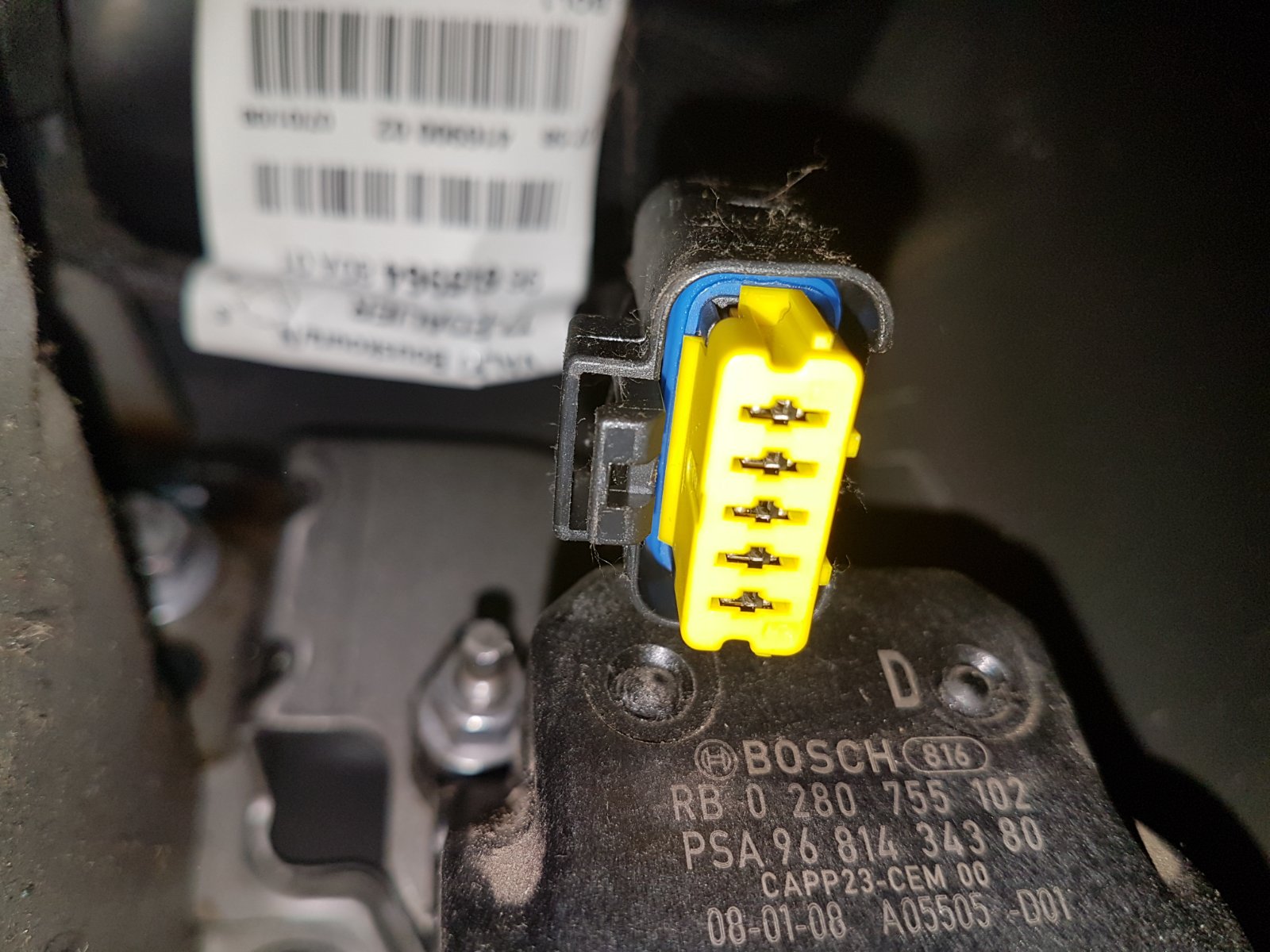

I've now scrabbled down on the floor and taken a couple of pictures. Seems the number is the same as the spare I have, so that's no help ! Connector s five pin, and looks like the bog standard PSA connector.
Seems like a swap to a 1601-V6 as an experiment may be in order ! I'll message Richard.
Tim

Ok, pedal replaced and limited is working as it should.
I have experimented a bit round town, and I like it. So nice to click the button and let the car just control the 30mph without having to look down. Let's see how my wife gets on with it.
Many thanks to Richard for searching out the right part.
