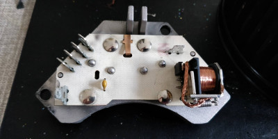

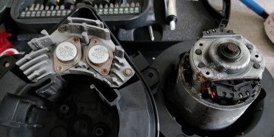

I have taken photos of the inside of the resistor and blower unit below:
Could the resistor be damaged? The blower on the right of the second photo looks like there is corrosion (water damage?) to the bottom left?
As it stands, the fan now works and it doesn't like the issue is the wiring further than the 4 pin connector?
Any advice would be much appreciated.

1. Ignition Switch Cable (Common fault with the Picasso not sure about the Xsara)
2. Fan Resistor (I changed this 3 years ago - as the fan was stuck on max)
3. Blower motor
I have just retested the 4 pins as per the previous tests I carried out earlier today. It looks like the results were incorrect (not sure why) the red cable is 0V when the ignition is off and 12-14V when the ignition is on.
I used this red wire to connect the 4 pin connector directly to the red pin on the back of the fan and the black to black, the fan kicked in following this circuit - this is confusing as I used the 12V directly from the battery earlier today, therefore the 4 pin connect should be ok and the ignition switch cable should be ok too.
I plugged the 4 pin connector into the unit and the fan now works!!!!
I have stripped the car down to get access and I don't want to put it all back together for this to happen again.
Thanks
Mike

Re: Citroen Xsara - Heater Blower NOT WORKING
I do know that there was an issue with the blower motor bearings; where water gets into the bearings and they can start to seize up. When this happens on models with climate control, the blower motor starts off on low and gradually powers up to the required speed as needed depending on the actual temperature and requested temperature.
In this scenario, there is insufficient power to start the motor on the lower speed. Others here have bypassed the ECU and wired it directly to the mains as it were in order to provide full power on start up temporarily to get it going again.
So if there are signs of water getting into the unit it’s possible that it may have gotten inside. Worth a look while you have it out the vehicle. It still doesn’t explain the ignition key wiggling, and that may also need attention. That issue can be caused by having multiple keys, key rings and other junk on the ignition key ring. This additional weight is exacerbated with the motion of the vehicle and ultimately weakens the internals of the barrel, causing intermittent issues. I never have any more than an additional key and leather fob on mine for this reason.
