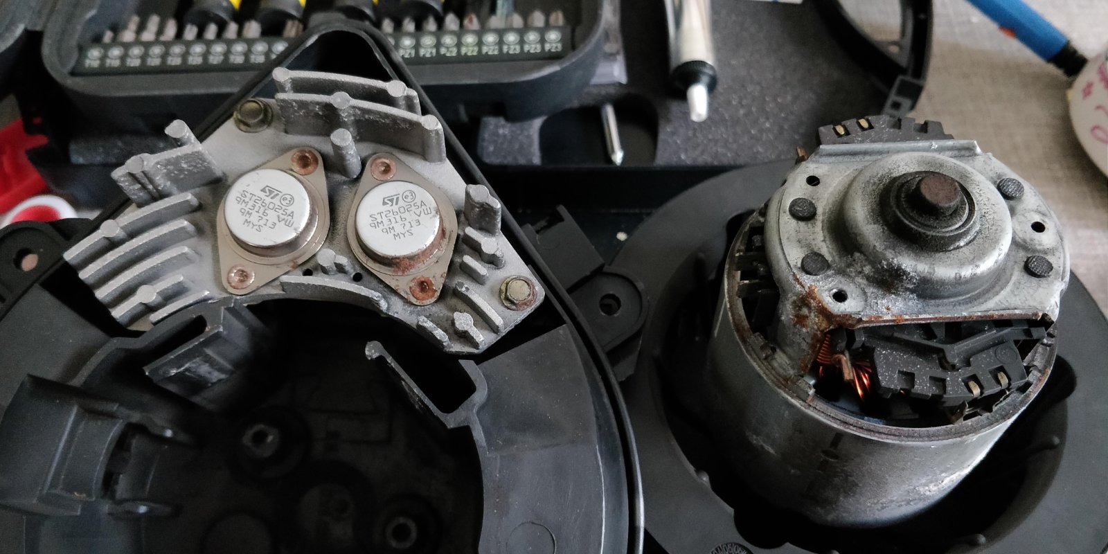

I have taken photos of the inside of the resistor and blower unit below:
Could the resistor be damaged? The blower on the right of the second photo looks like there is corrosion (water damage?) to the bottom left?

I do know that there was an issue with the blower motor bearings; where water gets into the bearings and they can start to seize up. When this happens on models with climate control, the blower motor starts off on low and gradually powers up to the required speed as needed depending on the actual temperature and requested temperature.
In this scenario, there is insufficient power to start the motor on the lower speed. Others here have bypassed the ECU and wired it directly to the mains as it were in order to provide full power on start up temporarily to get it going again.
So if there are signs of water getting into the unit it’s possible that it may have gotten inside. Worth a look while you have it out the vehicle. It still doesn’t explain the ignition key wiggling, and that may also need attention. That issue can be caused by having multiple keys, key rings and other junk on the ignition key ring. This additional weight is exacerbated with the motion of the vehicle and ultimately weakens the internals of the barrel, causing intermittent issues. I never have any more than an additional key and leather fob on mine for this reason.
