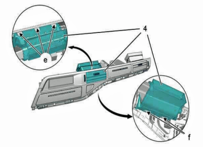

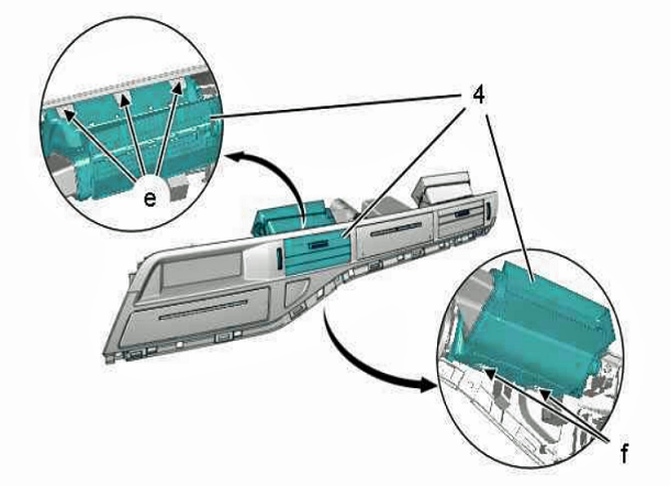

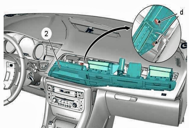

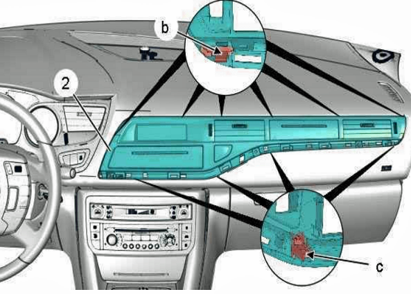

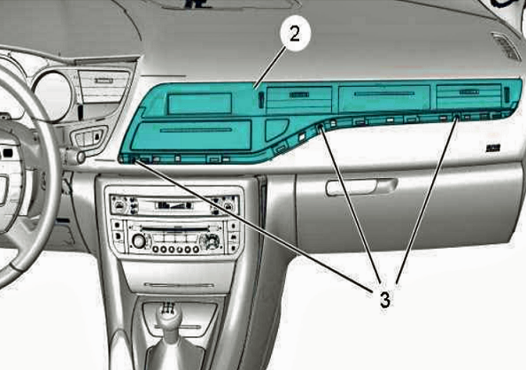

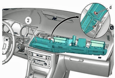

As for removing the screen, you'll need to remove the lower dashboard trim strip that will show bolts to remove the panel that holds the air vents in (be careful removing this).

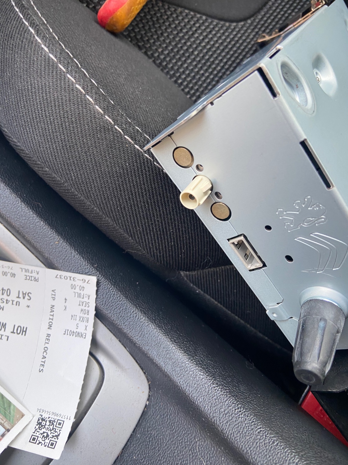

Re: Citroen C5 can not connect to Bluetooth
Hi
I’m in need of some help please.

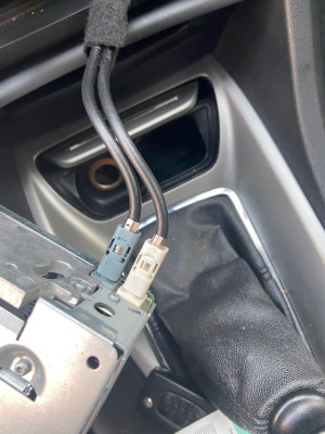

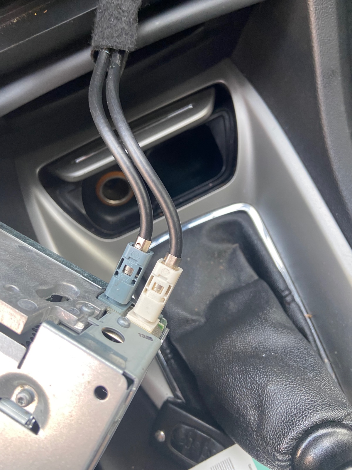

I have fitted the new screen, however when I pulled the rd4 out has two cables where the rd45 has one.
Thanks in advance
David
Thanks in advance
David
Can you take a photo of the RD4 and RD45 so that we can see what you are talking about?
Hi yes no problem.
I have tried to attach a picture of each.
Thanks
David
Thanks
David
For both RD4 and RD45 there are several variants, some have a single antenna and some have two (or even three, but that is a different story).
The RD45s coming from China mostly only have a single antenna socket.
The RD45 with a single antenna should work OK, but the FM signal will not be as strong. I suggest that you try listening to a weak FM station with each antenna lead connected in turn to see which one works best for you.
Great thanks I will try both leads as you suggest hopefully it will be ok.
