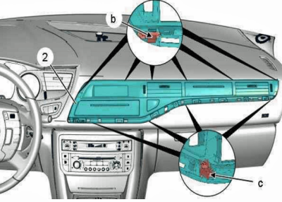

As for removing the screen, you'll need to remove the lower dashboard trim strip that will show bolts to remove the panel that holds the air vents in (be careful removing this).

The RD4 radio unit is removed using these type of removal pins:
The unit will slide out and the connectors are accessible. Always disconnect the Quadlock connector (the large square connector) first and reconnect it last.
