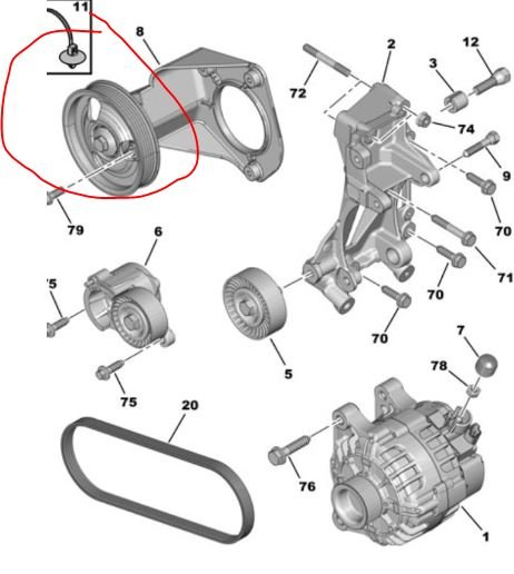

I think we are talking about different things here.
For a start the OP has a EW10J4 engine which is completely different to the one shown in his last picture which is an EW10A engine.
Chalk and cheese.
But if you are talking about the Fixing units, then the following is the correct one for the OPs engine:
Chalk and cheese.

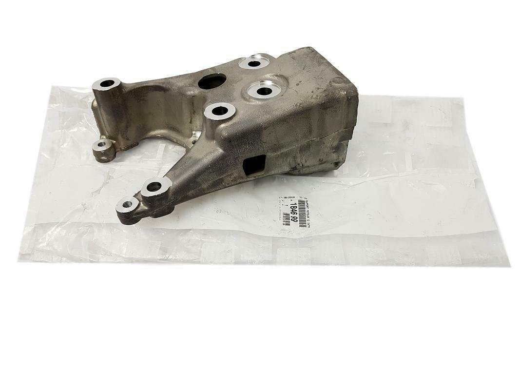

I took the right wheel off today along with the protective wheel arch plastic. Took the tensioner out and I was all happy because the bit on the tensioner broke. I was already doing the celebratory dance. After further inspection I noticed that the left fastening spot became loose and it just fell in my hand. The dancing was over...
I have a mechanic coming over tomorrow for his opinion. What do you guys think? Will probably give it to a shop to fix this...
https://imgshare.io/image/HjZUc
https://imgshare.io/image/HjH9i
So ... the plot thickens.

Looked at the pictures and the bits seem to be the from the same type of part, could someone have been there before and not removed the previous broken bit, does look a fair bit battle worn.
Could it just have been left there or maybe someone thought it was a spacer and left in situ after a previous replacement ?

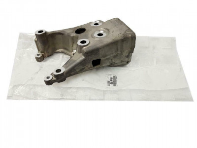

That's a bugger, but it's not a total disaster. It looks like it's part of the engine mount (No 9 in the diag Bobbins posted), here's a pic of used one from e-bay, you can see the two threaded holes at the bottom for mounting the tensioner
It should be easy enough to replace - put a jack under the engine, remove the 4 star bolts on the inner wing, and the ones on the top of the mount, then remove the 5 bolts for the mount. Even if you haven't got a jack and the right socket for the star bolts I doubt a mechanic would charge more than an hour to change this. It's widely used, eg for Citroen:

And there will be a similar list for Peugeot - basically anything fitted with the 1.8 or 2.0 EW series petrol engine. It shouldn't be too hard to find a 2nd hand one.

Is there another piece missing? Or have you already removed it? There should be a big free wheel pulley above the alternator (presumably where the power steering would have been before they switched to electric) - circled in the diagram below:

Yeah I removed that pulley to have a better look and access.RichardW wrote: 04 Apr 2019, 21:20 Is there another piece missing? Or have you already removed it? There should be a big free wheel pulley above the alternator (presumably where the power steering would have been before they switched to electric) - circled in the diagram below:
