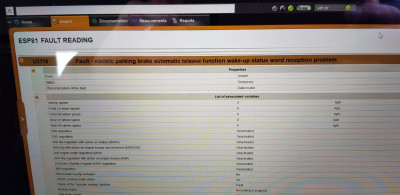

Ok im a tad fed up today, part arrived and I fitted it easily , have calibrated it with Lexia and very hit and mis, I started with 10 fault codes on the ESP81 and have got them down to 5, and at one stage down to 4 after getting the ABS light out but this was short lived with the ABS coming back on after 5 mins still got both ESP,ABS, lights on ,, ive also put a new battery in just in case , so after doing the calibration on Lexia it says success and I clear the codes.. unsure what to do now

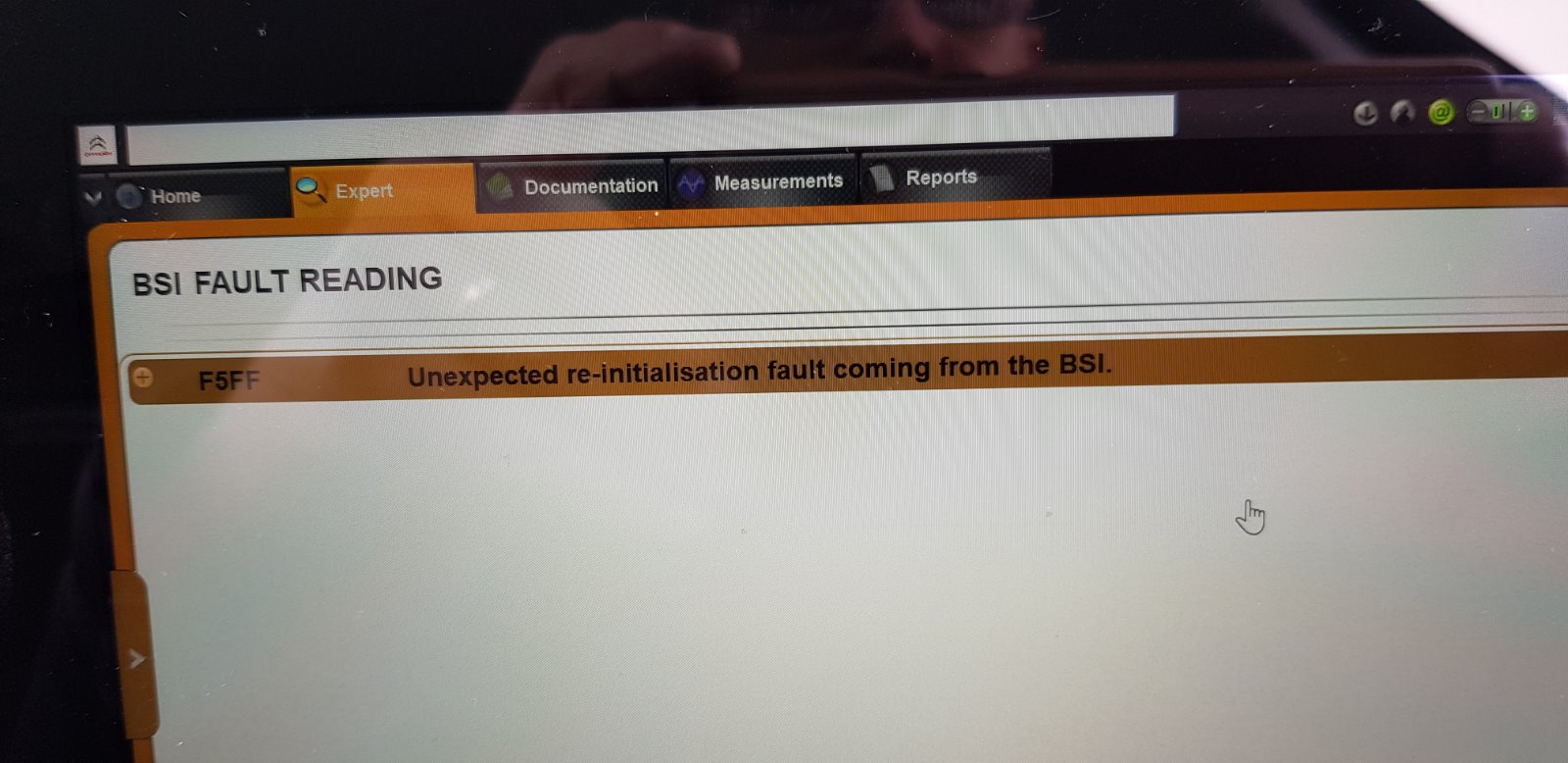

BMF : Built-in Systems Interface (BSI)
Response data
R61809664058780002C96640588800501FFFF084052114799
R61B1940C04B02160000220A1AE0200
R61BA1800000000000000
State of the ECU: BSI
Reference 1 : 9664058780
Reference 2 :
Faults present : 2
F5FF : Unexpected re-initialisation fault coming from the BSI.
Characterisation : not characterised
Status :
Location : local .
Variables associated with the fault
FA58 : Study fault : Do not take it into account
Status :
Location : local .
AAS : parking aid
Response data
R6180965601968000039663821680012DFF05054056377799
State of the ECU: AAS
Reference 1 : 9663821680
Reference 2 :
Faults present : 0
ABRASR : ABS/traction control
Response data
R6180966573028000039665730280FFFFFFFF0001FFFFFF00
State of the ECU: ESP81
Reference 1 : 9665730280
Reference 2 :
Faults present : 5
C139B : gyrometer accelerometer sensor signal fault
Characterisation : Short circuit to positive or short circuit to earth or open circuit
Status : Permanent
Location : local .
vehicle speed : 0 kph
Front LH wheel speed : 0 kph
Front RH wheel speed : 0 kph
Rear LH wheel speed : 0 kph
Rear RH wheel speed : 0 kph
EBA regulation : deactivated
EBD regulation : deactivated
Anti-slip regulation with action on brakes (BASR) : deactivated
Anti-Slip with action on engine torque disconnected (ASR/ESR) : deactivated
Anti-engine brake regulation (MSR) : deactivated
Anti-Slip regulation with action on engine torque (ASR) : deactivated
Electronic Stability Program (ESP) regulation : deactivated
ABS regulation : deactivated
Recirculation pump activated : No
Electric parking brake status : On
Status of the "assisted holding" function : No holding
Braking status : No braking in progress
Yaw angle speed : 000 °/s
transverse acceleration : -00.3 m/s²
Steering wheel angle : 151.3 degrees
Distance travelled since last time ignition switched on : 0.0 km
supply voltage : 12.2 V
Braking pressure : 00.0 bars
status of the ECU : Main
longitudinal acceleration : 0.00 m/s²
C1502 : longitudinal acceleration sensor signal fault.
Characterisation : Internal
Status : Permanent
Location : local .
Status of the "assisted holding" function : Fault
Yaw angle speed : Value invalid °/s
transverse acceleration : Value invalid m/s²
supply voltage : 12.1 V
C1315 : lateral acceleration sensor signal fault
Status : Permanent
Location : local .
C1310 : yaw sensor signal fault
Status : Permanent
Location : local .
U1325 : Fault: no communication with gyroscope accelerometer sensor.
Characterisation : no signal
Status : Temporary
Location : local .
supply voltage : 10.0 V

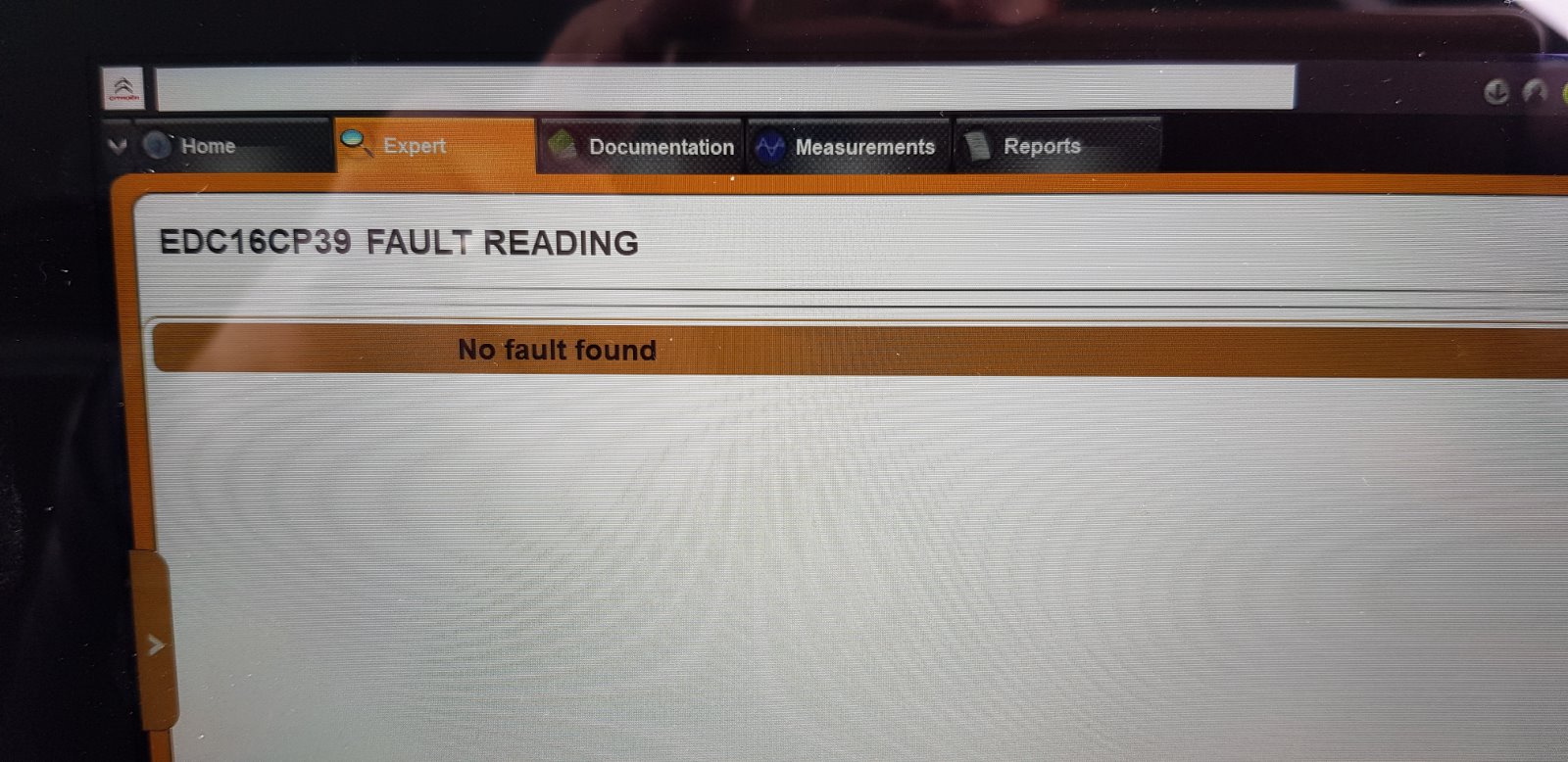

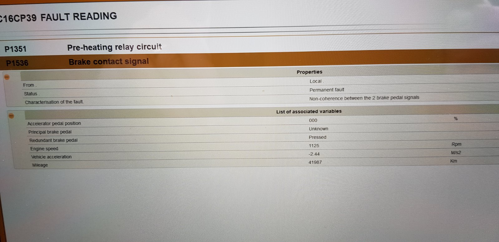

Re: ABS/ESR
Update on this is ive put a new brake switch on today and before Lexia said Brake signal fault, then after no Fault so even thou the brake lights worked there was still an issue somewhere but sadly my issue with the ESP/ASR is still there its driving me nutsss..please zoom in

Re: ABS/ESR
There may be TWO switches in the casing (there is on my C5 Mk1). The main pedal switch (which is a 'push to make' type) is for the brake lights, while the redundant pedal switch (a 'push to break' type) is to disconnect the cruise control (if the stalk is added and the cruise control system is set up). This assumes the brake switch system works in the same way as on MY C5.

Re: ABS/ESR
Another one that came up today that I haven't seen before was Unexpected re-initialisation fault coming from the BSI, please zoom in

Re: ABS/ESR
Which replacement brake switch did you get? Did you get the one with the loom, and secondly, did you read and clear all the faults?

Re: ABS/ESR
Hi Marc I got the one you gave me the link for , it had a separate wiring loom

Re: ABS/ESR
and another new one was Fault U2119 electric parking brake automatic release function wake up status word reception problem... I feel overwhelmed and feel like the car is shutting down
