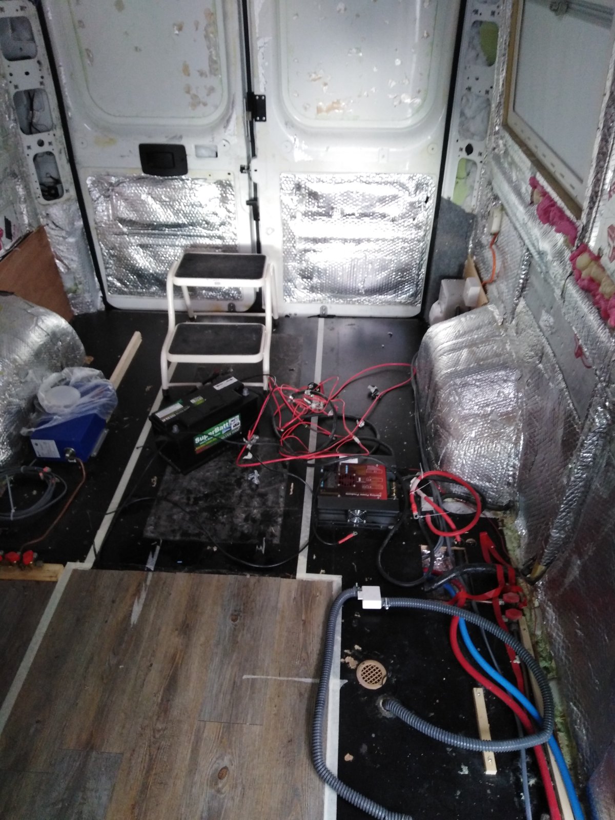

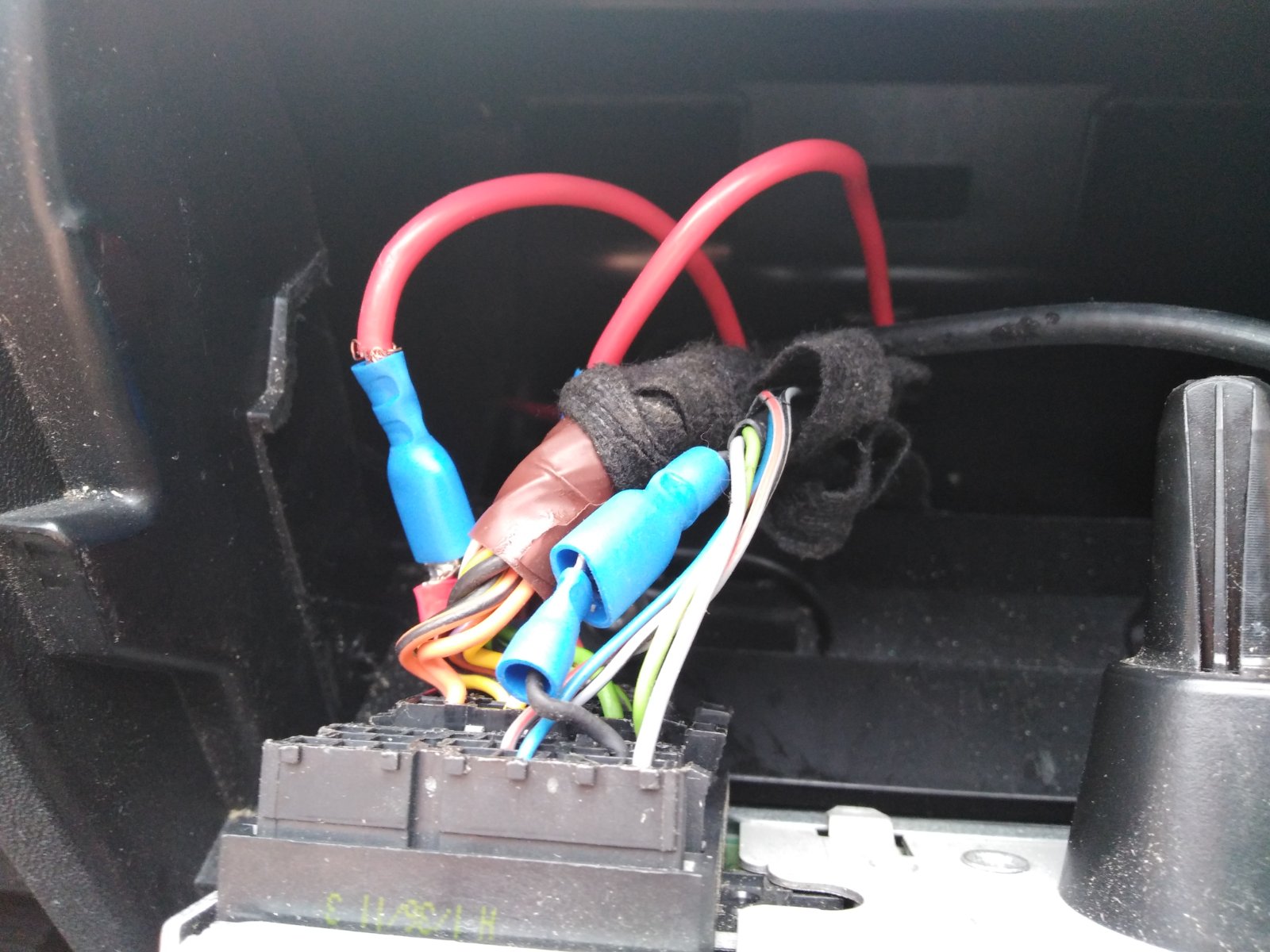

Ok here's for the update.... and don't laugh... I made my radio removal tool from the last wire coat hanger I found in the house. It worked well with a bit of jiggling. I checked the 10A fuse on the back, which was fine... BUT ... I noticed there are two new red wires that have been connected to the wiring harness on the plug at the back of the radio. That's odd I thought.. someone has been at this before which would explain me having problems. I traced the red wires back down behind the dash then under the floor all the way back to the leisure battery connection which is located at the rear of the van.... and you guessed it...no leisure battery connected. I have been disconnecting the leisure battery as I'm doing the electrics in the back of the van. I connected the leisure battery to it and hey presto the radio works. I guess the previous owner wanted the radio to run from the leisure battery and not the vehicle battery as you need the keys in to do that. and you have the possibility of running the starting battery down. I hadn't considered this was the problem but the day it did work was probably the day I had connected the leisure battery back up.. The van has been a campervan before but the previous owner has ripped everything out of it including electrics which is why I took the battery off to save any electrical problems. I'm hoping the pictures have attached so you can see my project. Anyway the radio is fixed and I'm feeling like a bit of a tit. I just didnt occur to me it would have been rewired. Thank you very much for all your help with this and I will continue to post as I'm sure I will be needing more advice. You are a star and if ever in Newcastle I'm going to buy you a pint..
