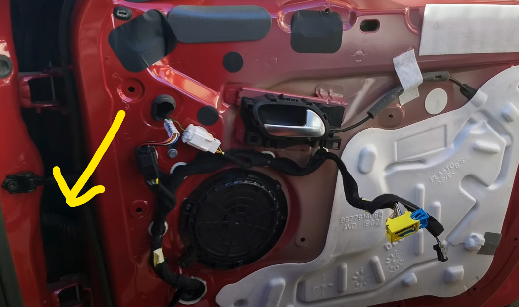

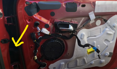

Re: C4 Picasso outside temperature sensor
Hi and welcome.
Don't forget that the wires are routed through the door aperture, so this is another typical area where the opening and closing of the doors can cause a break int he wiring.
So if you are sure you have replaced the sensor with a good working one, then I would be looking at the area where the wires go from the A pillar through to the door. Remove the protective grommet and check here for breaks or signs of split sleeving.
Maikerock
- Posts: 2
- Joined: 08 Jun 2024, 10:27
Thanks for the response, so I have to remove the door cover as described here: viewtopic.php?p=599452#p599452 to check the cable is ok?
- x 6950
Not really - unless there is a break inside. I meant the wiring loom in between the door and the pillar where the wiring loom goes into the front door. That is the weak point where the door opens and closes causing stress on the wiring over time and breaks.
Here:
