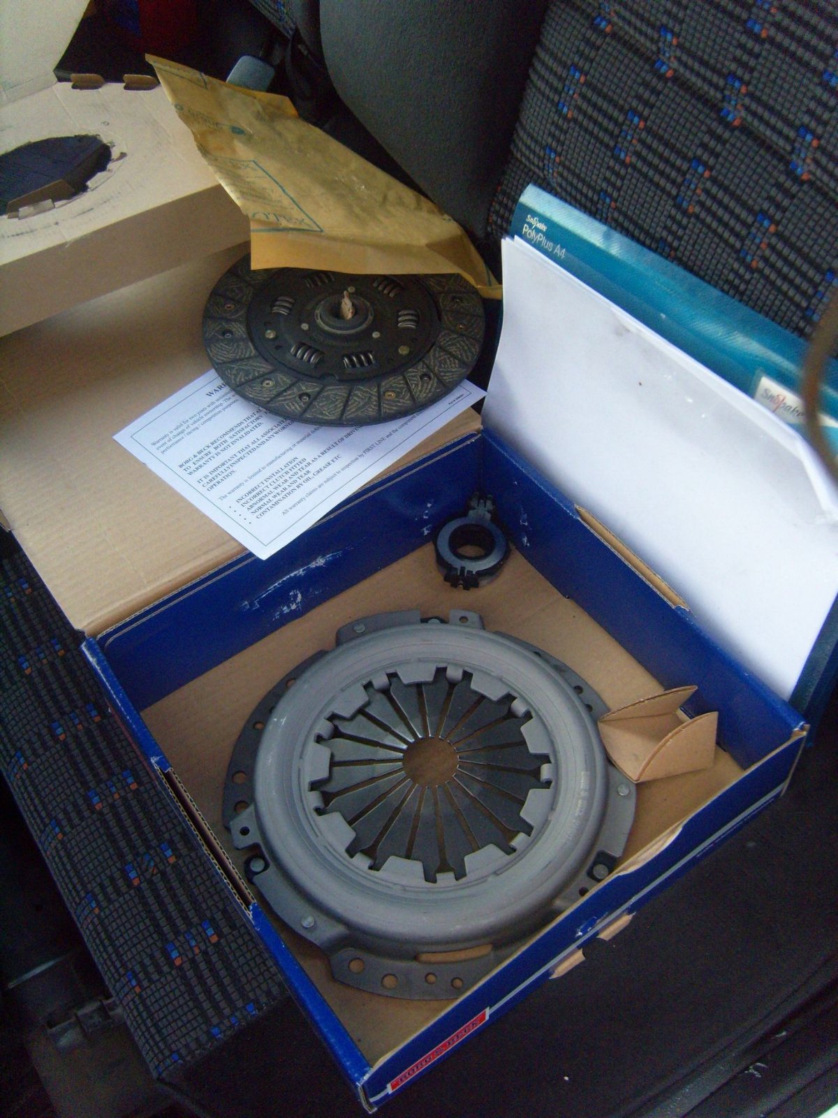

Pug_XUD_KeenAmateur wrote: 30 Dec 2018, 22:36 ...and having the centre-ing thingy to ensure the clutch plate is central*
*I never did get my hands on one, which is perhaps why I've got issues with it just 50k (ish) miles later; so anyone who's got one they're willing to part with, do let me know.
The centering tool is only required to re-mate the box and engine - the first time you press the clutch the disc will self centre anyway, and if it's not lined up, you won't be able to get the box back on. If you buy a Valeo clutch, they usually come with a plastic dowel to centre the clutch. CitroNut never used to use one, he just centred the plate by eye with the clutch loosely nipped up. I've got one of these: Draper tool
50k would be about the life expected from a re-manufactured clutch, especially if it was a Transmech one....

aha, well its not dodgy coz of failing to use the centre-ing tool then.
Rather irritatingly, often being a Cheapskate, this was not one such occasion; I paid a bit extra for a Borg & Beck.
The Thrust Bearing is noisy and the pedal effort required went from near zero when new to what I'd now consider 'excessive', suggesting worn 'fingers' on the Pressure Plate.
I was careful to be really mean with the Grease on the Gearbox main shaft, could I have been too mean?

Thanks to everybody for their advice on diy clutch replacement. The cheapest quote I could get was £750 for dmf and clutch kit fitted, parts been around £320-£350. So with £400 labour costs I am going to give it a go myself.

Good luck ! Giz a shout if you get stuck, someone here will have likely 'been there'
...aren't these new fangled things expensive !!
