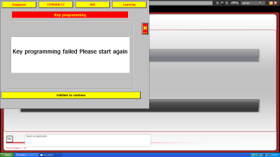

Re: Citroen C2 locking issue
Both keys are throwing this up. I think both of the chips are FUBARed.
- x 6963
Ok, so to rewind a bit, we need to ensure that it's communicating properly:
Did it detect the VIN ok?
Did you enter the RPO number (10661) for your vehicle?
Were you able to run a Global Test and did it detect all the ECUs that were present correctly?
Bear in mind that we're blind at this end apart from the info you tell us, so we need to be sure that everything else is working first, or you won't get very far with anything else
Sorry Marc, the global test worked fine, picked up everything (apart from ABS) and gave some faults which was expected. The VIN was auto-recognised as well. I did put in the correct RPO and the confidential code was accepted too.
