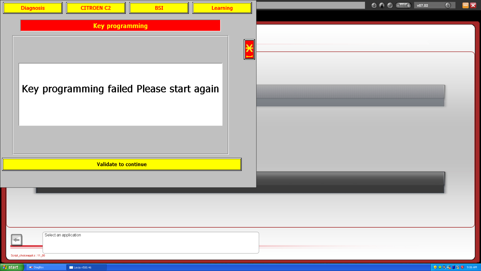

Both keys are throwing this up. I think both of the chips are FUBARed.

Ok, so to rewind a bit, we need to ensure that it's communicating properly:
Did it detect the VIN ok?
Did you enter the RPO number (10661) for your vehicle?
Were you able to run a Global Test and did it detect all the ECUs that were present correctly?
Bear in mind that we're blind at this end apart from the info you tell us, so we need to be sure that everything else is working first, or you won't get very far with anything else

Sorry Marc, the global test worked fine, picked up everything (apart from ABS) and gave some faults which was expected. The VIN was auto-recognised as well. I did put in the correct RPO and the confidential code was accepted too.
I'm going to go have something to eat as sitting in a freezing cold Citroen wasn't the ideal start to the day!
If the keys are duff, would I be able to buy some old ones from the breakers yard and put the chip in my blade and reprogram? Alternatively, what is the cheap transpinder only C2's model number just to get me back on the road?
Thanks again Marc for your help and patience!
