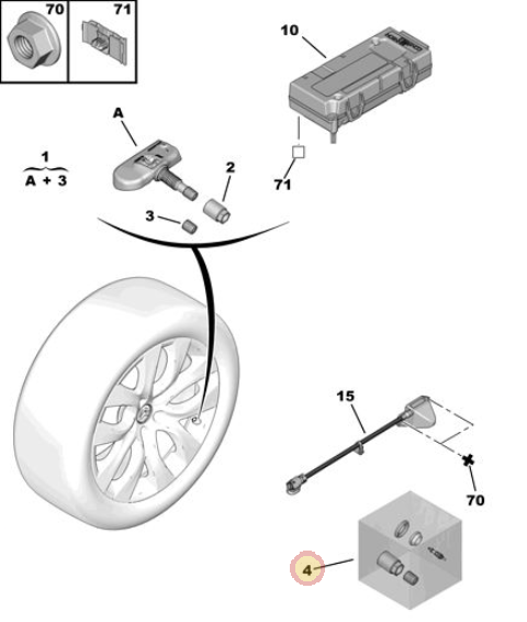

Any tips on removing the TPM units from an alloy wheel? I am thinking about getting my wheels, blasted and re-enamelled as they are fairly corroded, centerhub & around some of the tyre valves.
Should I expect the valve body to be correded in the wheel, and how do I put the valves back again and ensuring an airtight seal?
Any special tools, other than Diagbox & a long reach socket?
I see there is a repair kit (Part no. 5412 03), does anyone know if they consist of replacement seals and are they still available?

Is this for your X7 Stu?
If so, the repair kit has been replaced with part: 541205. They are £5.44 direct from Citroen, item (4) on the diagram.
They contain everything you need - valve body, inner valve, cap, seal etc. These are supposed to be done periodically anyway, so probably a good idea to sort them all for £20 anyway.
