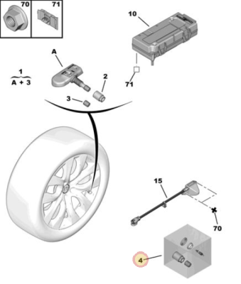

Is this for your X7 Stu?
If so, the repair kit has been replaced with part: 541205. They are £5.44 direct from Citroen, item (4) on the diagram.
They contain everything you need - valve body, inner valve, cap, seal etc. These are supposed to be done periodically anyway, so probably a good idea to sort them all for £20 anyway.
