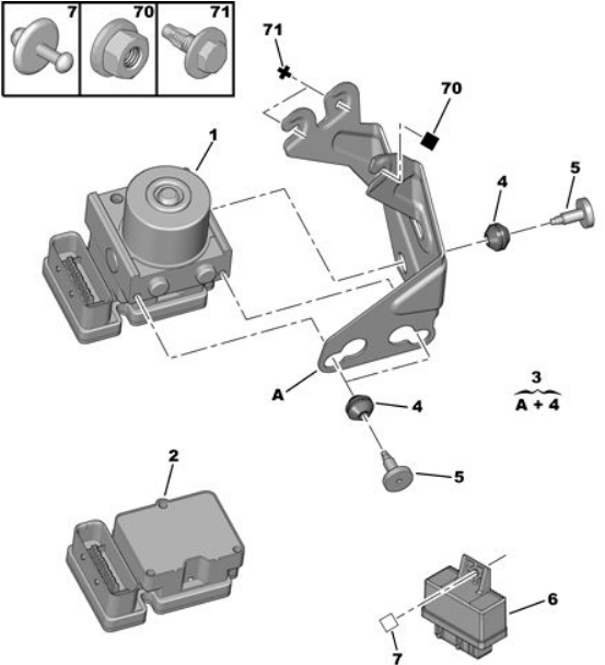

The part you need for your ABS Pump unit is 4541G4
The ABS ECU (item 2) is available separately.
Item 1 in the diagram, so if using your won ECU you won't need to code it. But make sure the battery is disconnected before taking it off and replacing it.

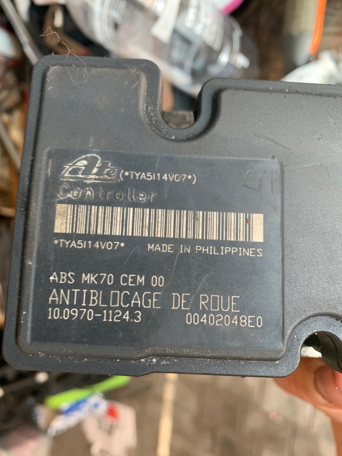

I have a Citroën c2 2006 vtr and the abs pump is dead, the motor is stuck. I want to buy a whole new pump, but I know that the pumps works whin some vin numbers, and I don’t know what the part number is. Please help me.

Be aware that the above is the ABS Electronic Control Unit. The Pump Module hydraulic block can be bought separately from the ECU on some variants, so the above is not the part number for the ABS pump module.
