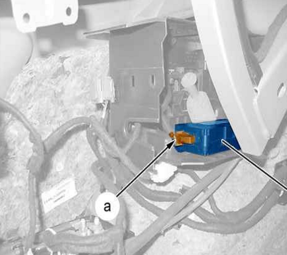

That's the TPMS ECU Stu, the Parking Assistance ECU is stored to the right of the spare wheel.
TPMS ECU Location

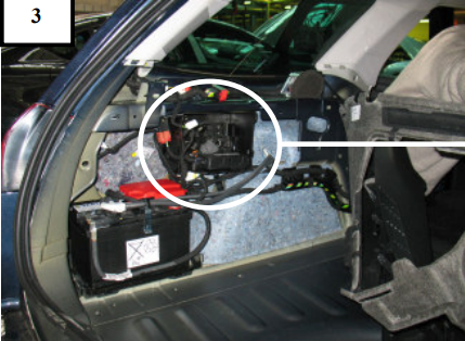

The Tourer does have the connection point on the LH side though. That's where I plugged my kit in.
x 6955
Re: 2008 C5 exclusive
Yes on the left for the BSR unit. Below you can see the unit from a distance - ignore the battery at the bottom, this is from a V6 where the batteries are stored in the boot.
