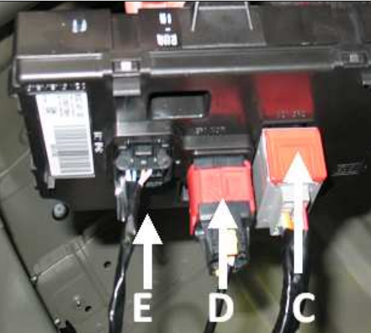

John, do you have an OEM electrics or dedicated C5 X7 solution for towing with the trailer?
Only dedicated model - specific solutions are guaranteed to work with the vehicle's electronic systems to adapt to a trailer, for example (and model dependent):
The specific harness goes into the BSU here, and is activated with Lexia.
Non dedicated units won't interface with the vehicle - specific systems.
- ESP / ABS Programme Adaptation for towing
- Cruise adaptation (likely to gradually increase acceleration to set speed, rather than engaging warp speed when towing)
- CAN compliant connection
- Auto shut off or rear parking sensors
- Deactivation of Car Fogs when Towing
- Rapid Flashing of indicators for a trailer bulb out

Re: 2008 C5 exclusive
Is that module the BSR? as in the towing module that is detected when using diagbox?
If so, do you know whereabouts on the X7 it is hidden? Presumably somewhere at the back?
- x 6956
Yes, same thing Elis, also called TCU by some
. Rear left hand side of the luggage area, behind the trim in this example, but won’t necessarily be fitted. These come with some of the Citroen kits, and other suppliers have a different smaller module.
EDC5 wrote: 09 Aug 2018, 19:11
On 2011 salon, lefthand side above wheel arch in the plastic 'rack' with the parking Ecu.
Stu
- Posts: 9302
- x 1938
Ditto position for 2013 Tourer.
