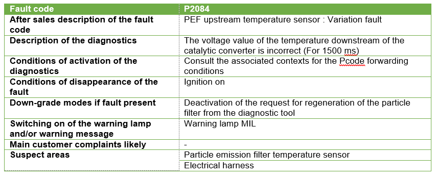

Right this is the P2084 which means that the temperature recorded 'Downstream' of the catalytic converter is not right and the P2083 is similar but refers to the 'Upstream' temperature.
So it would be very odd for both of these sensors to be faulty at the same time - so I suspect it is symptomatic of the emissions system - these sensors are really to protect the Cat from too much heat. As you can see, the back up mode in this state will prevent a forced regeneration, as this would add to the heat generated. It is supposed to be an intermittent fault, but if it is regularly coming on, it will need further diagnostics to determine the issue.
Click to Zoom Table
What sort of mileage has she done?
Do you do a lot of short journeys?
When was the last time you took it for a good spin? You could try going for a 30 minute spin, keeping it in 4th so the revs remain highish and see if that will clear it out.

It's the other way round, Marc - the sensor is to ensure the exhaust temp is hot enough to start the regen - hence regen being inhibited if it's faulty. This is the same error I picked up on John's a few weeks ago, his went away though! New sensor was £125 iirc....

I mistyped the error code Richard
(now corrected) - the second one should of been P2083 (not P2086) which is the upstream one I believe and should indicate when there is excessive heat. Temperature values intermittent from what I can see. You’d think with all the sensors now they’d be able to be a little more specific!

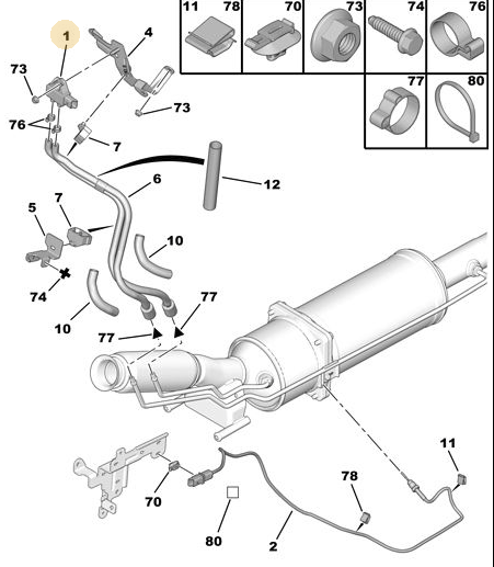

If you mean EGR - no just the one. The fault in question relates to the gas temperature sensor - not the differential pressure pipes:
(2) is the gas temp sensor, with the differential pressure pipes shown at (6), and the differential pressure sensor at (1).

So as you can now see from the diagram I added, it shows the one sensor for the temperature.

Re: C5 anti pollution
GiveMeABreak wrote: 04 May 2018, 17:33 Got you!So as you can now see from the diagram I added, it shows the one sensor for the temperature.
That's what I was getting at. There is no up AND downstream sensor, just the one.
