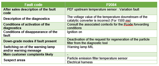

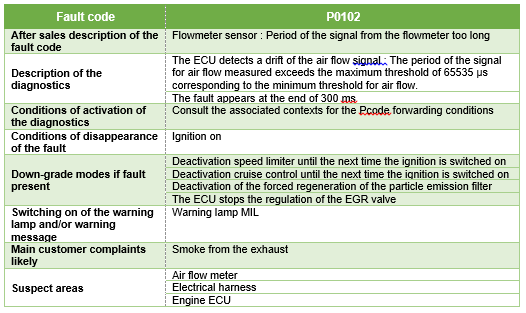

Ok, so here are the 2 fault codes you mentioned
P0102 points to the Mass Air Flow Meter - so that would be my first port of call - try getting some specialist MAF sensor cleaner and spray onto the wire (but don't touch it!) That should clean the crud off it and hopefully restore the functionality of the wire and subsequently correct the signal being sent to the engine ECU.
The second Fault may be symptomatic of the first fault - as P0102 causes a backup mode to engage (no cruise control or speed limiter functions and the EGR valve is unregulated - so this may impact on the emissions system.
I would suggest you first try cleaning, or if that does not cure the problem, then replacing the MAF and see if that resolves you problem.

These are linked to the particle filter temperature sensors - but I really need your VIN or registration (PM it to me) to help further.

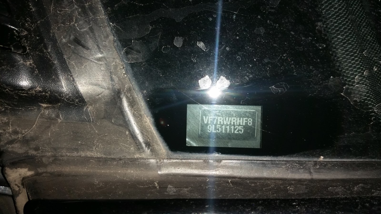

Think I sent you a pm. If it didn't come through I put a pic if my vin details in the thread if that's them?
