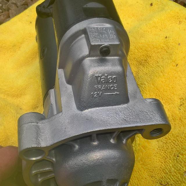

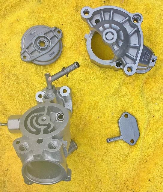

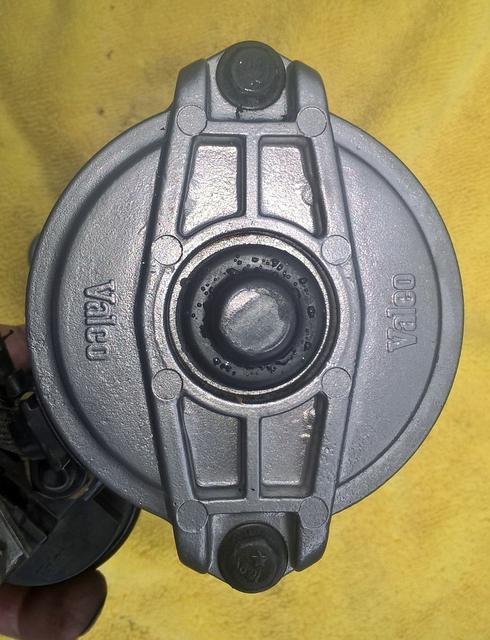

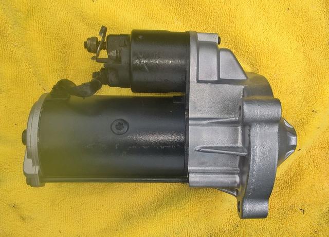

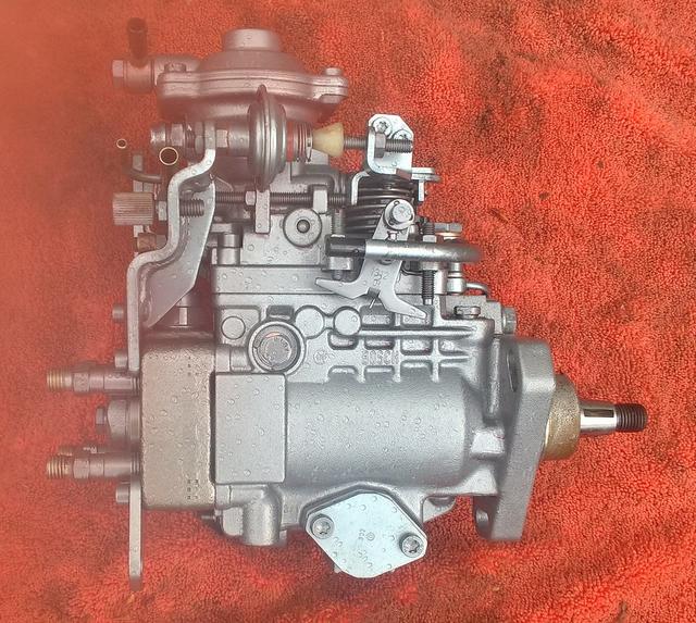

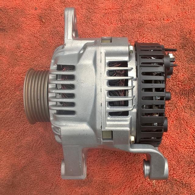

The first tranche back from the blasters

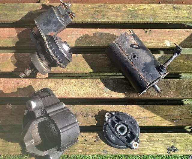

And my 'brand new' starter motor
Fully refurbished and a huge improvement on the original. You wouldn't know it was the same starter.

Just got to put everything back together. :roll:
Posts: 55151
x 8422
Re: Diesel Pump
Sweet :D

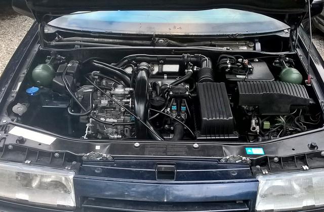

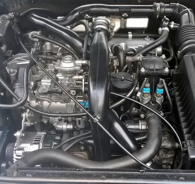

Unread post by Eddie Nuff »

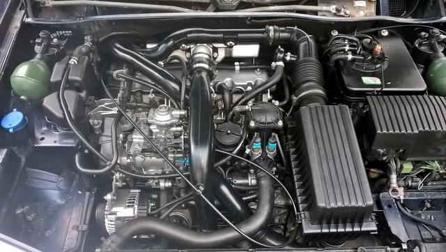

All back together and looking very nice thank you very much. Fuel needs bleeding through but getting there.
Posts: 55151
x 8422
Re: Diesel Pump
That's looking very smart and excellent :D Potential concours winner there!
ekjdm14
Posts: 2014
Joined: 19 Jan 2015, 17:42
x 267
Re: Diesel Pump
Unread post by ekjdm14 »
Gorgeous, but for pity's sake sort that dipstick! :D
