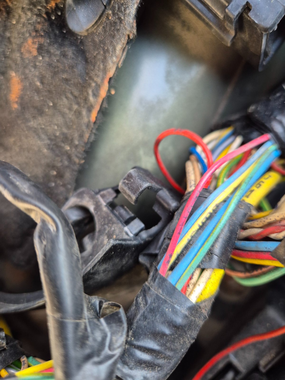

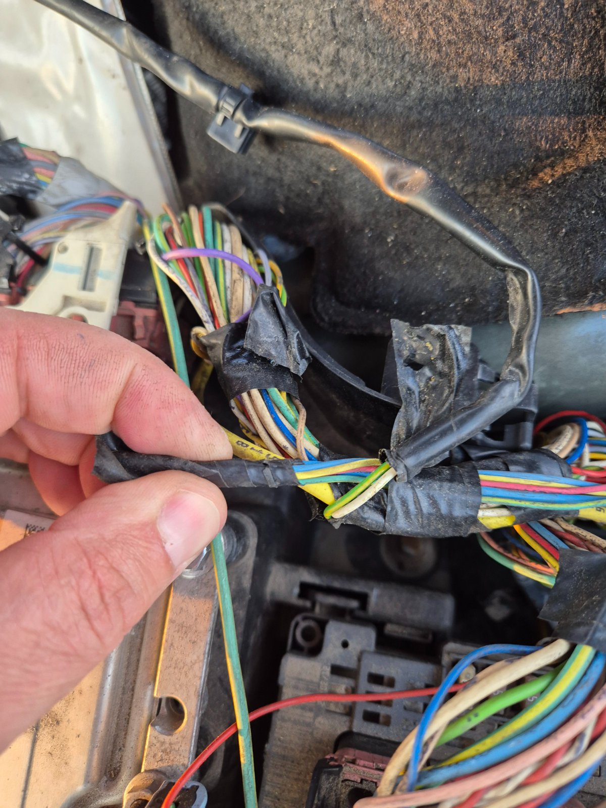

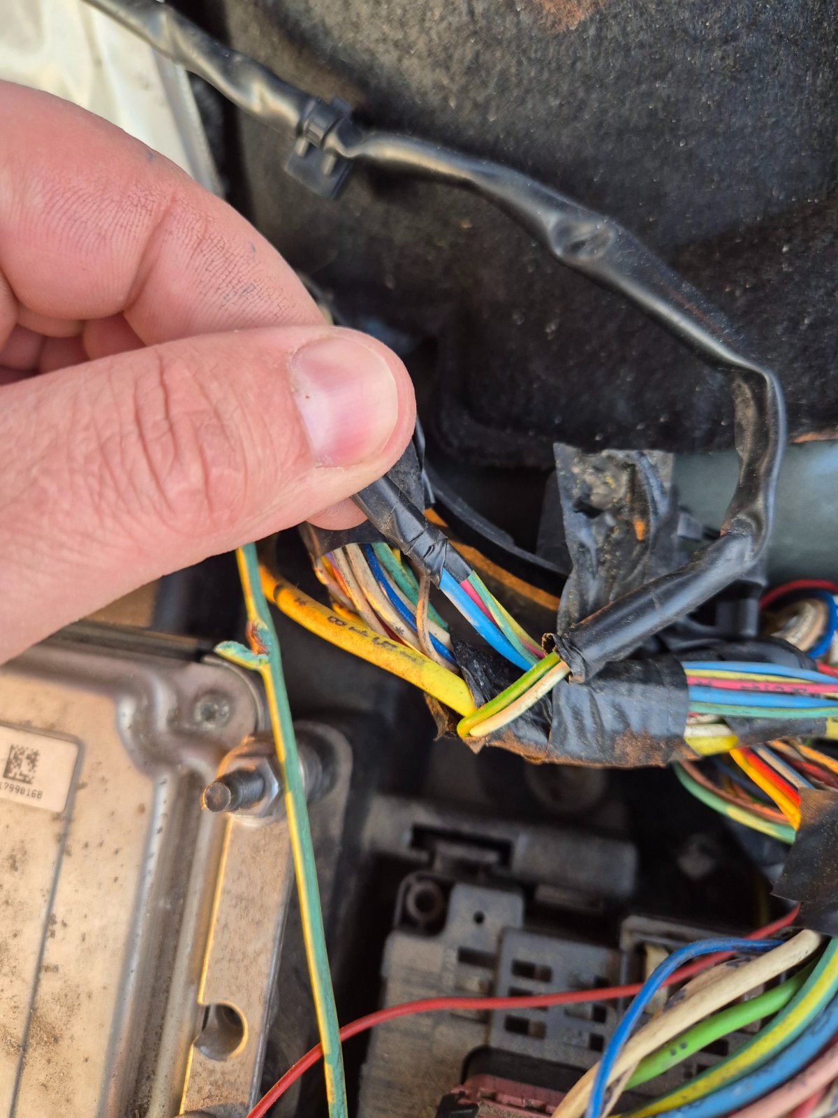

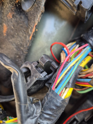

Hello everyone. Not to open a new topic, I hope I can follow up here and find a solution. I hope someone will see this post. A few days ago I bought a Peugeot 508 2.2HDI 2012. And I noticed a "knocking" sound in the back of the car when idling. If I step on the gas for "1mm", the knocking stops and nothing is heard while driving. Otherwise, the car drives fine, except that it consumes a little more fuel. I connect it to the DELPHI diagnostics and it says error P0611. I see here that the detonation sensor is mentioned, but I don't think my car has it. If I'm wrong, someone correct me. Then I looked at the cables at the ECU and saw that some cables were cut. I'm attaching a picture. I don't know where the other end is, and you think that could be a problem. I am also attaching a picture of the injector at rest. Any help would be great. And excuse my bad English.

Have you checked if the exhaust brackets are in good condition and not rusted off anywhere ?

PaulC5 wrote: 21 Feb 2025, 21:45 Have you checked if the exhaust brackets are in good condition and not rusted off anywhere ?

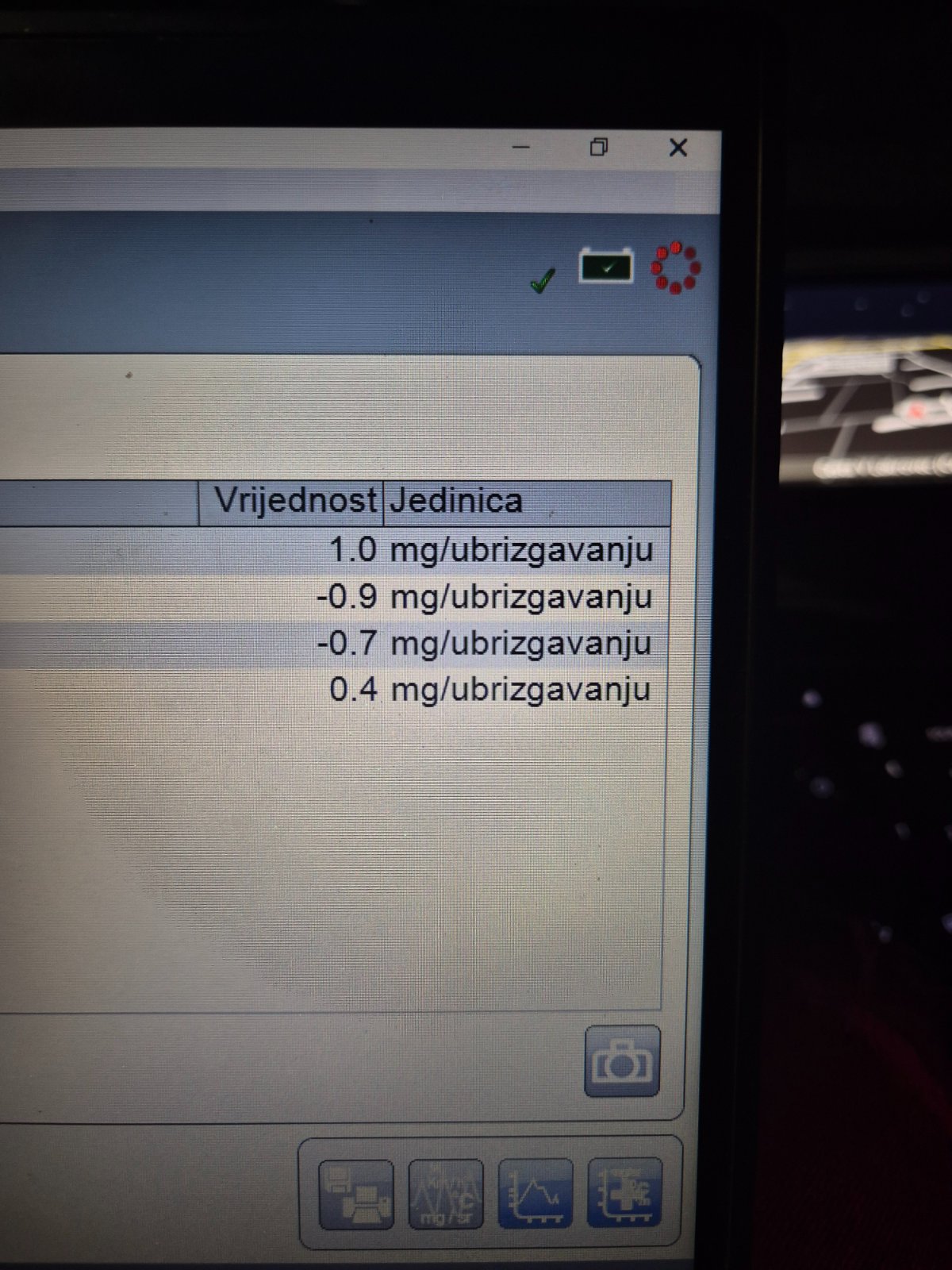

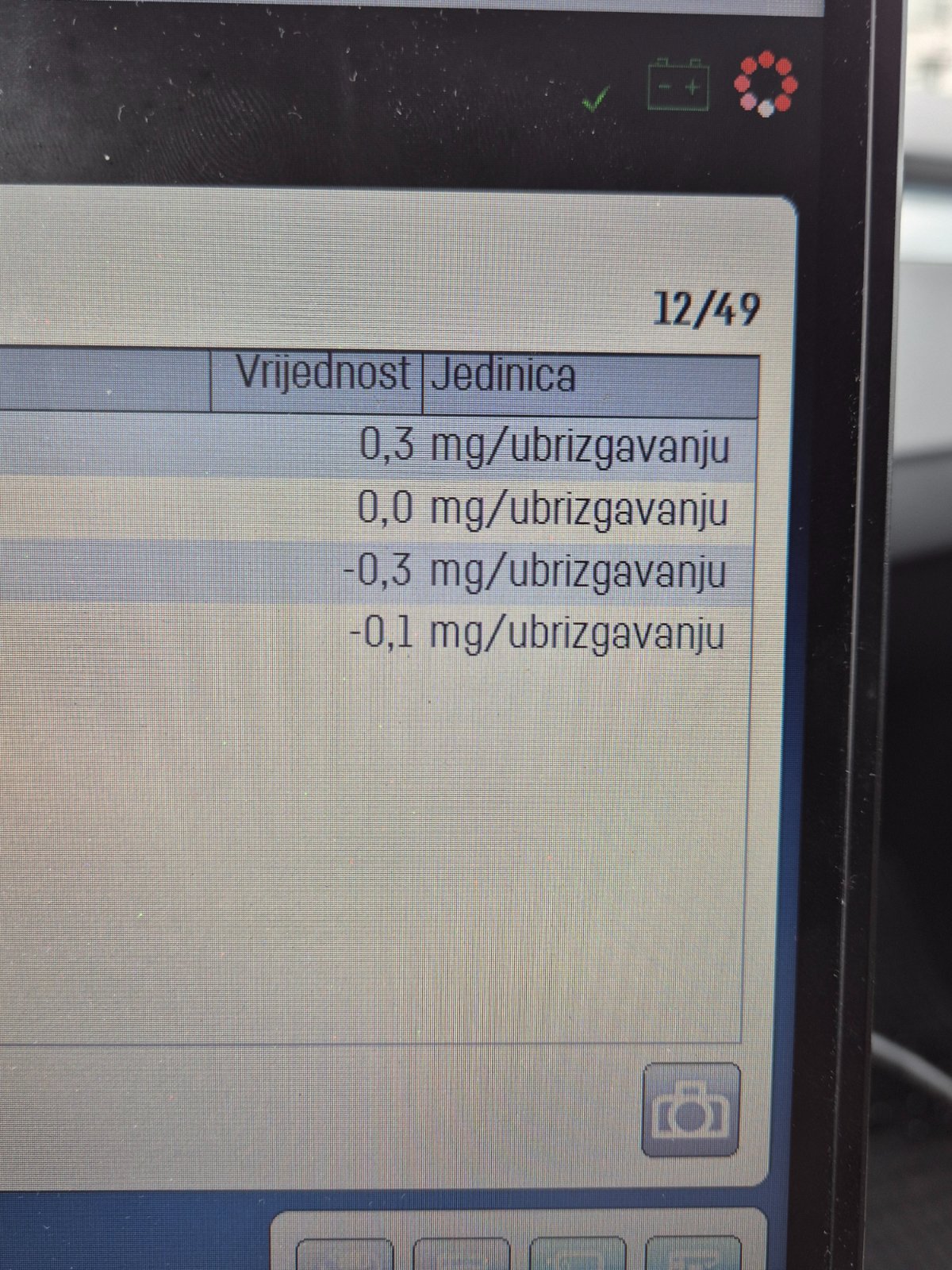

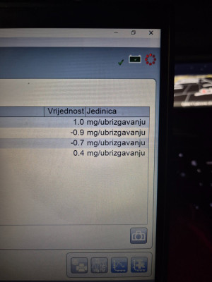

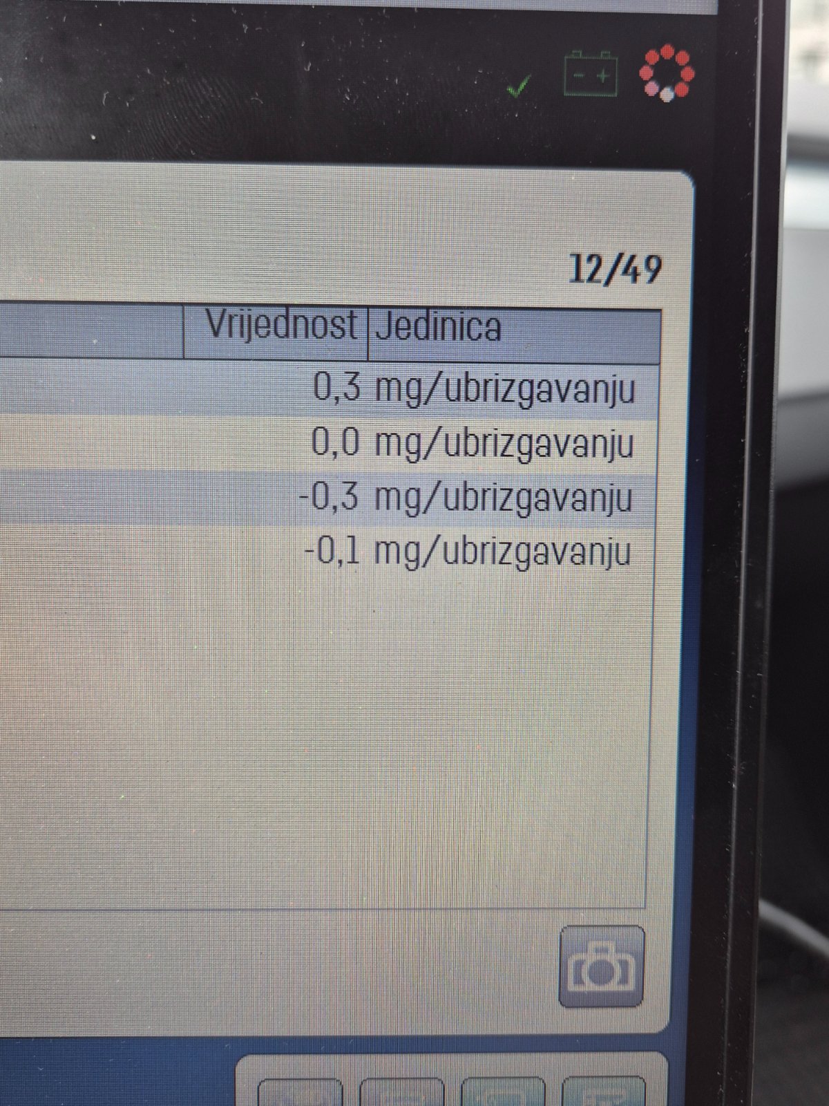

Knocking was the motor carrier. But it still remains p0611. Today's injector correction is like this.
